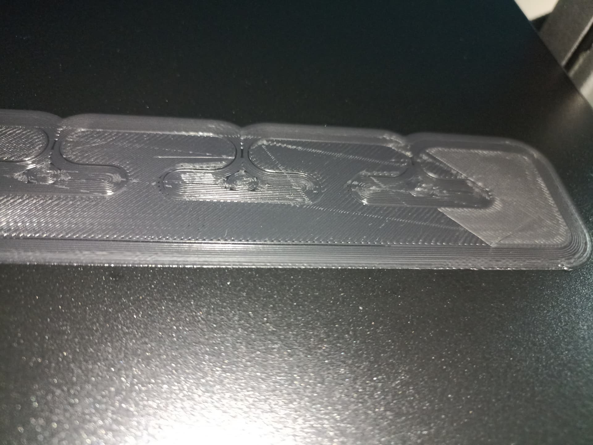

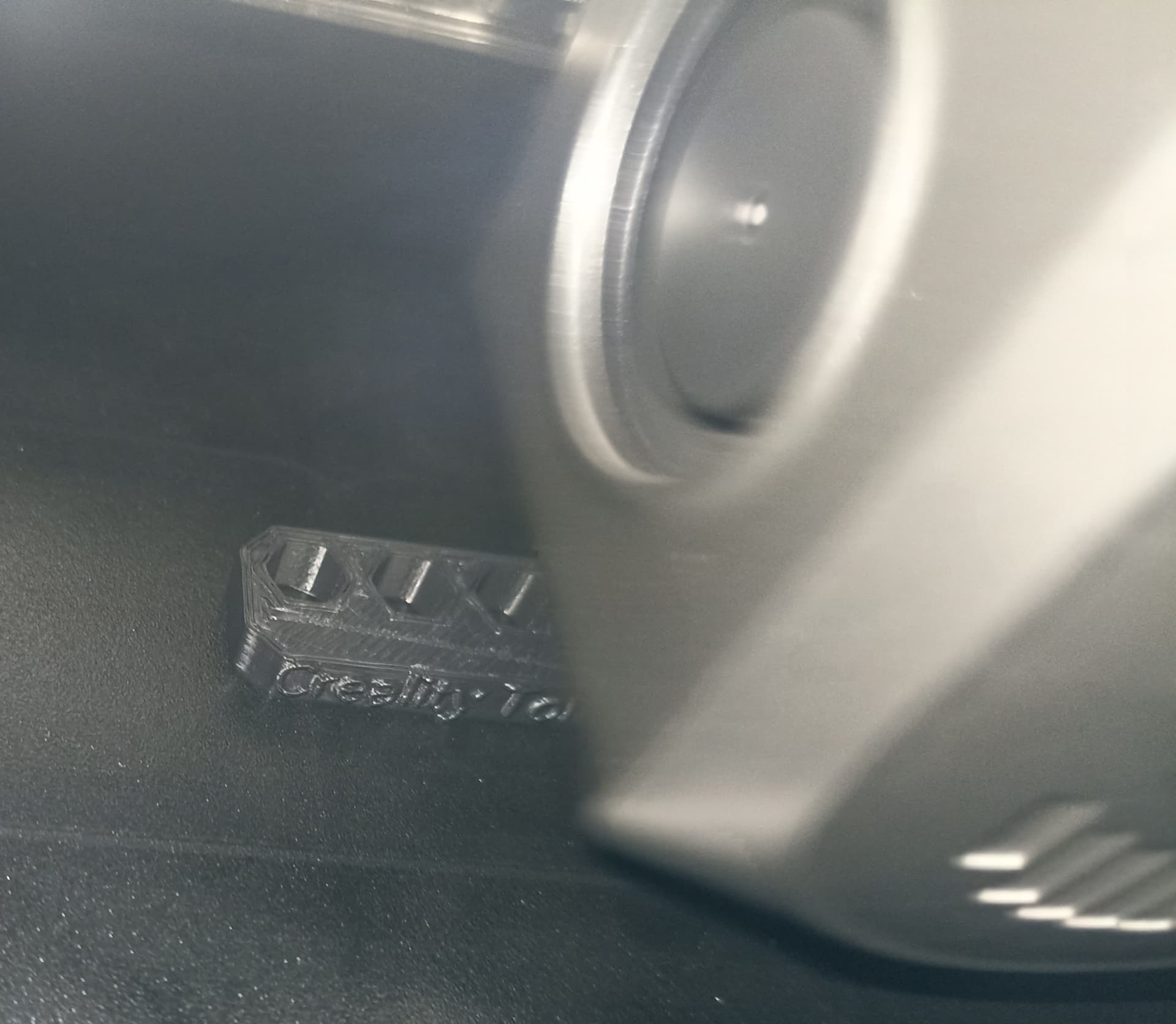

But now, the nozzle keeps dragging on prints.
I tried raising Z-Offset and calibrating the Flow Rate, but the calibration result showed a slightly higher ratio : 0.99 rather than the default 0.97.
I adjusted the Z Offset again hoping that the issue would be solved, but it isn’t.
It keeps rubbing and scratching the prints, even if the first layer prints perfectly.

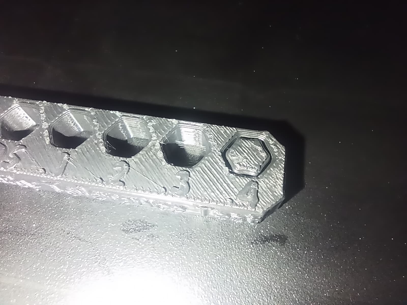

However the top layer on my tolerance test print is really squishy.

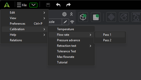

Hi! It definitely looks like the flow rate is too big. I think the good way is to do filament flow rate calibration. You can find it in the Creality Print:
How to use Flow Rate Calibration? Everything you can read is here: Calibration Tutorial | Creality Wiki - go down to the Flow Rate and follow easy steps. After that you should get properly calibrated filament and you can try printing again.

I did that and it was already rubbing on most of the samples.
I got the flow rate to 0.99
If the flow rate is not the problem, maybe z offset is too low, It should be set to the value, when you can put a sheet of paper between nozzle and bed
