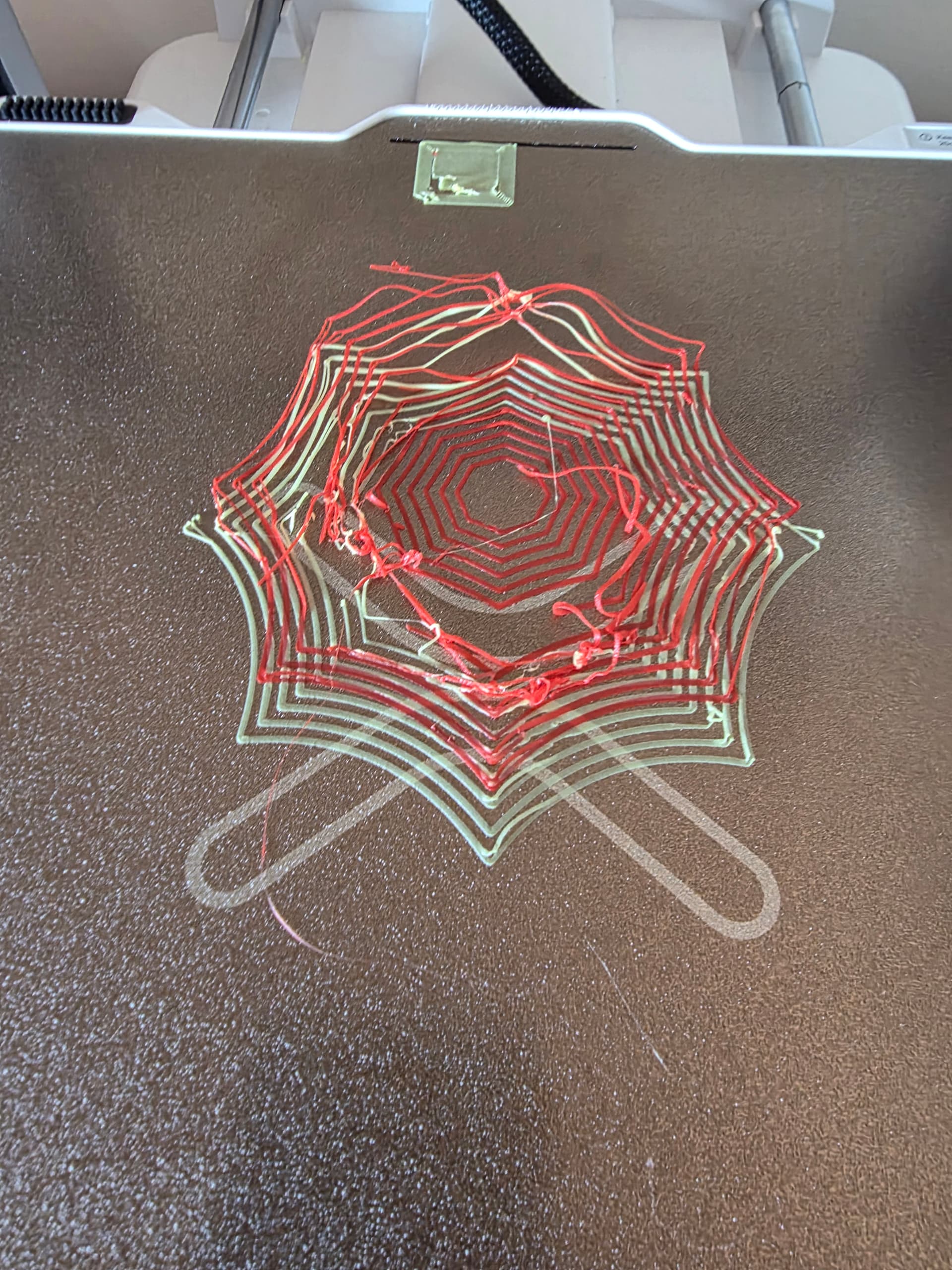

I recently purchased a Creality SPARKX i7 with CFS Lite, and I am experiencing a persistent issue during multicolor printing.
Whenever the printer switches from the first filament to the second, the print head appears to lose its XY position. The second color is printed significantly offset from the first one.
Printer information:
  • Model: SPARKX i7
  • Multicolor system: CFS Lite
  • Firmware: 1.1.5.8
  • Slicer: Creality Print
  • Material: PLA
Problem description:
The first color prints correctly. However, after the automatic filament change, the printer starts depositing the second color in the wrong XY position.
The printed object remains firmly attached to the build plate.
Interestingly, the G-code preview in Creality Print shows both colors perfectly aligned.

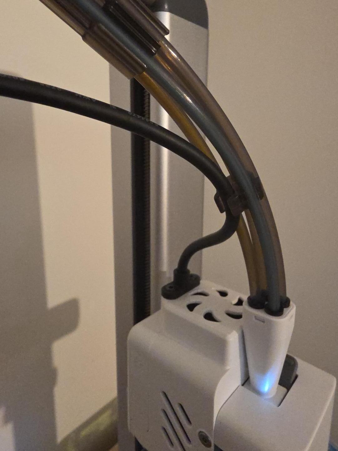

  6. Checked the PTFE tube routing and toolhead cable.
  7. Tested the toolhead movement along the X-axis. No obvious obstruction was observed.
