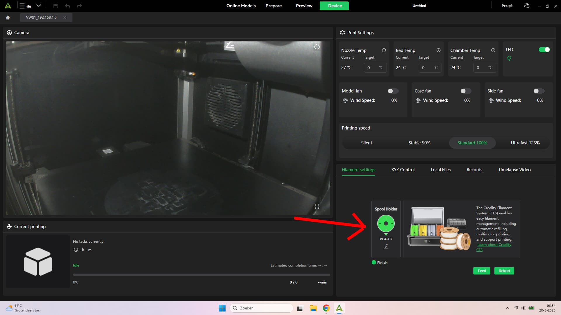

it is showing “missing ext” spool for k1c and it is no way to select anything on “filament” page for printer
Use the seach option of the forum… there are a few threads over “the machine consumables do not match” on this forum with options how to resolve…
For the K1 without CFS you have to make sure you select the “external spool holder” under the tab “devices” and the under “details”
