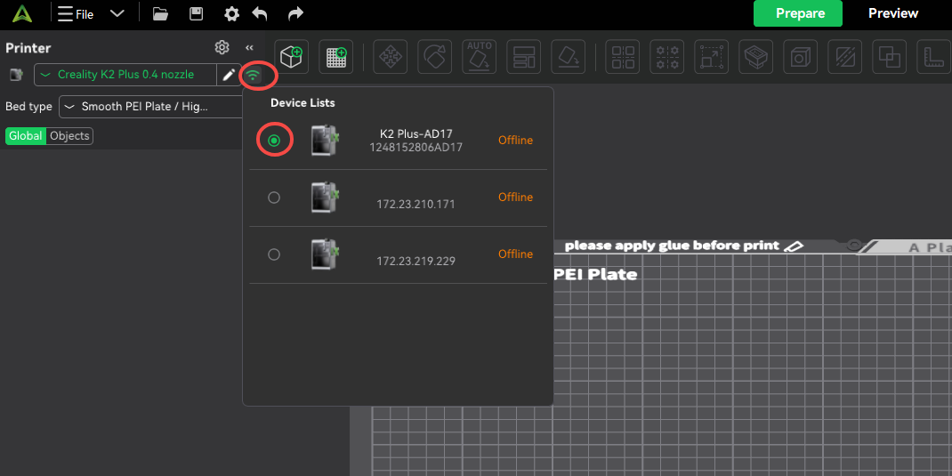

You must go to the WiFi icon to bind the device.
Tried that and nothing. Creality print sees both CFS’s but not matter what I click it does not map colors. My device is attached but I am not on wireless I’m LAN connected.
