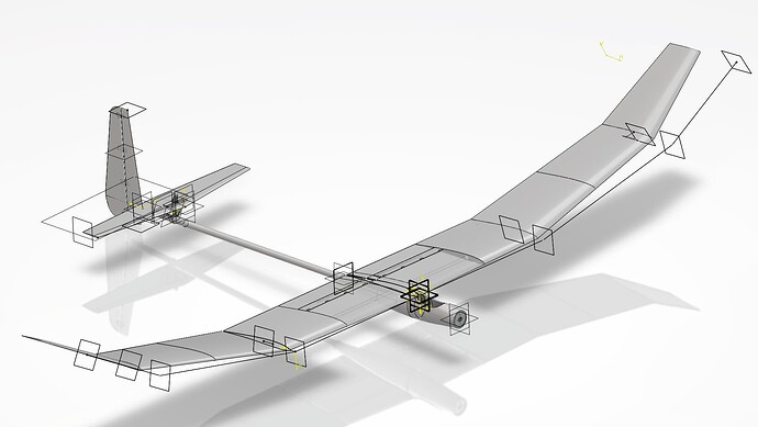

Here is my plan. I would print a two-meter span sailplane on the K2 Pro Combo, using recognized airfoils and lightweight foaming filaments: LW-PLA, LW-ASA, and HT-LW-PLA :rocket:. These materials expand as you tune temperature and flow, trading solid plastic for micro-bubbles :thermometer: :cloud:. Think of it like a really good baguette: light inside, crisp outside, and it still holds its shape when you slice it. That means low mass with skins that feel surprisingly stiff, exactly what a glider loves :airplane:.
The printer suits the job. I need to print wing modules with roughly 30 cm chord, and that fits the platform so the airfoil stays honest and the number of joints stays low :white_check_mark:. A warm, stable chamber keeps foaming predictable, which helps with LW-ASA and especially HT-LW-PLA :sunny:. The extrusion path handles abrasive formulations, and I will pair it with the hardened nozzle to keep edges sharp :tools:. With CFS I can run multi-material jobs so skins and inserts share the print without drama :grinning:.
I already flew a first prototype. It launched, circled, and behaved… right up to the moment I parked it in a tree :deciduous_tree: :see_no_evil:. The airframe passed the test; the pilot will get a firmware update :wrench:.

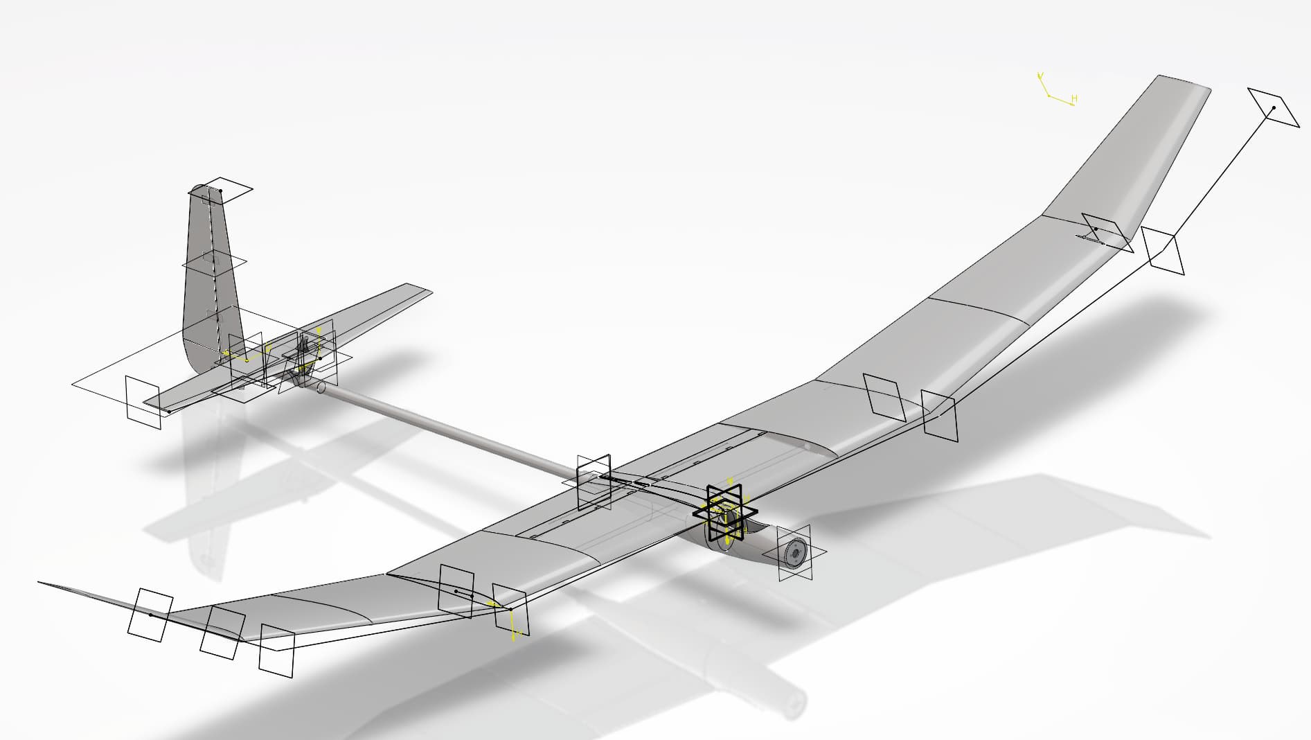

I am now modeling the V2 in 3DExperience, aiming for about 500 g all-up at 2 m span by dialing gyroid infill and local wall thickness :gear:. For the span and cost, that target sits in a very happy place if I compare it to what I can find in the market :smiley:. First wing already printed (just have to sand the glue now)
I want this to be reproducible. I will print small foaming coupons to map expansion versus temperature and speed, then lock flow settings that preserve dimensions for each filament :mag_right:. The wing will be modular with printed shear webs and spar sleeves, snug joiners, and clean leading and trailing edges so the profile stays true :straight_ruler:. LW-PLA will cover most skins, LW-ASA will guard the surface contact between each part, and HT-LW-PLA will reinforce hot spots like the nose or motor mount :shield:. I will use simple jigs for incidence and washout, keep weight logs and CG checks, and run quick torsion tests so others can copy the recipe :clipboard:.
Flight testing starts with gentle hand launches, then slope and thermal sessions :airplane_departure:. I will log sink rate, wing loading, and glide impressions, and I will share what actually works in the air, not only what looks pretty on the bench :chart_with_upwards_trend:.
Once V2 is printed, flown, and refined, I will release everything for free: .3mf files, STLs, slicer profiles, a compact build guide with flow curves, temperature ranges. Then I will scale the method to a four-meter RC sailplane. Same idea, bigger smile :grin:. And that’s why it’s funny. Mechanically speaking..It will be easier to print as the airfol is way bigger (just will take longer to print though) !
