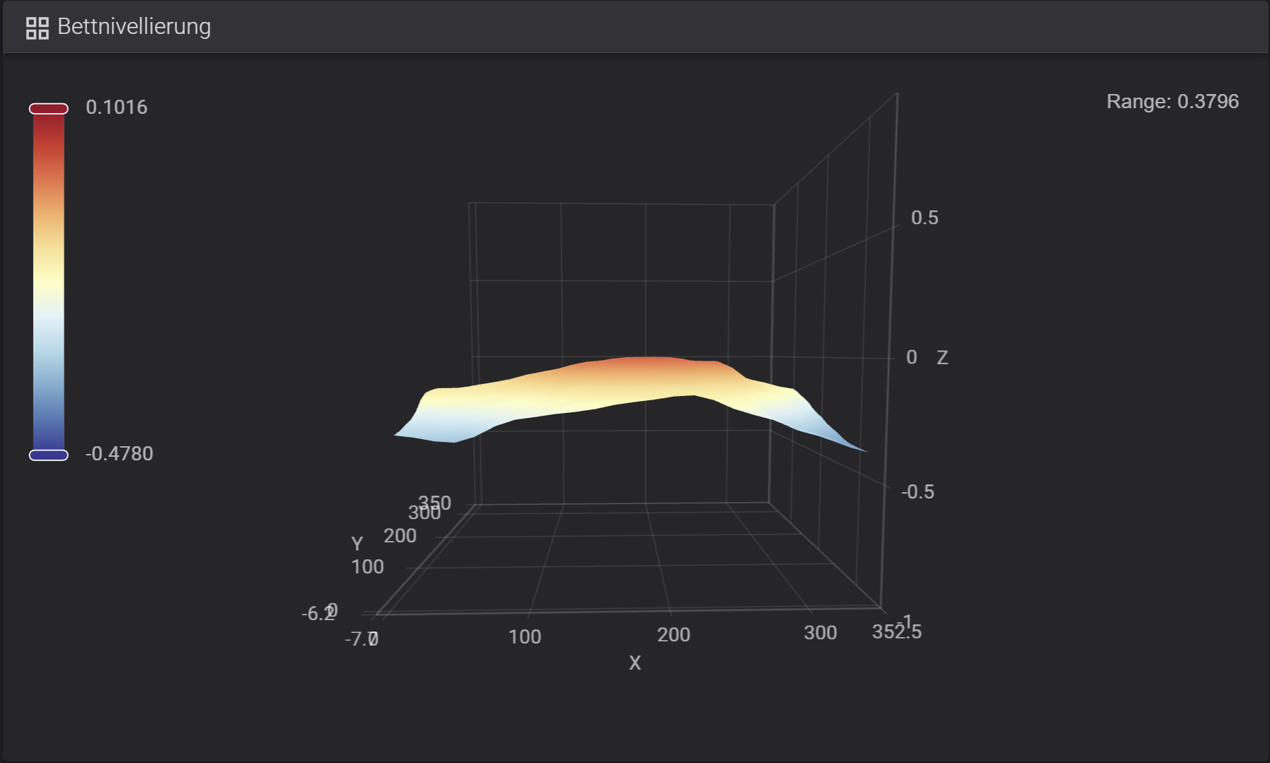

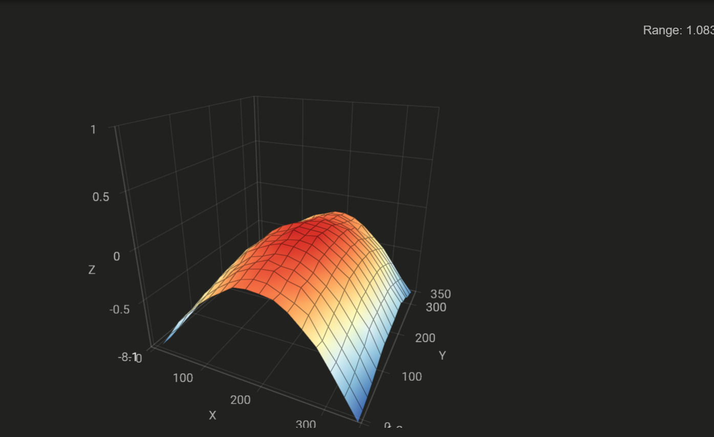

@DanielSan3318 what does your bed mesh look like? Is it hill-shaped (high in the middle)?

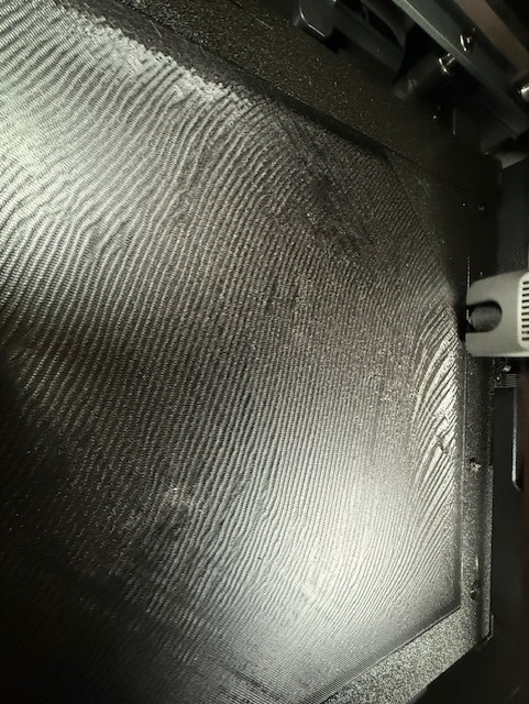

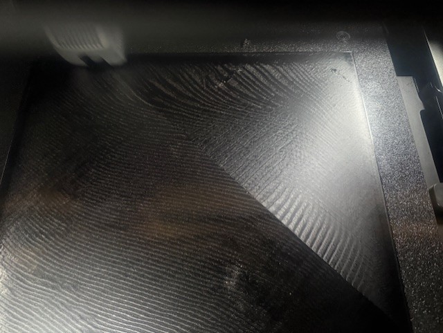

FTR, this is what my first layer always looks like (printing at 110C bed, 260C nozzle). No amount of heat soaking, etc. fixes it. The high spot in the middle would ostensibly be fixed with a static Z offset (mine is 0mm here on this test), but then of course the corners would be too low.

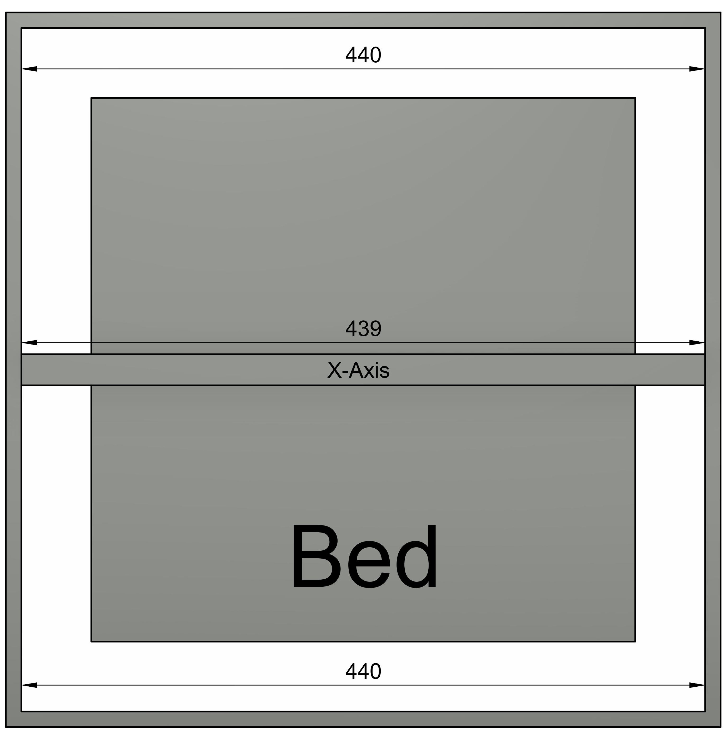

Yes and no. Even if the Y-guide rods are under tension, this is naturally accounted for by the bed mesh. However, the bed mesh is generated during slow movements, so the first layer, with a Z-offset of 0.02mm, is relatively good at 60mm/s.
Now, let’s get to the problem—I’ll try to explain it properly. We have a fixed distance of 440mm at both the beginning and the end of the guide rails. In the middle, due to tension, this distance shrinks to 439mm. As the X-carriage moves across the entire print area, the Y-guide rods are forced in one direction or the other because the X-carriage is rigid. The faster the printing movement, the more the Y-guide rods oscillate, negatively affecting the Z-height.
This is just a theory, but it seems plausible to me. I come from a manufacturing background and have a good understanding of these mechanics.

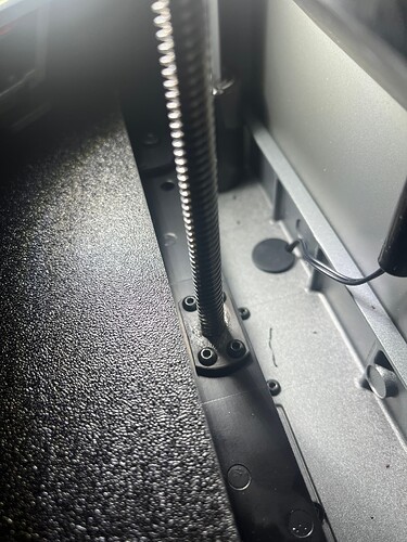

But just to say, with 350x350mm bed you should perhaps have used thicker Y-guide rods or straight away on linear rails that are screwed on, like on a Voron for example, that would have caused far fewer problems, but not only that, when you actually see how the bed is attached, i.e. with 4 screws on the trapezoidal nut and the whole guide is just made of plastic and the bed is anything but light, I have my doubts anyway that it is suitable for mass production.

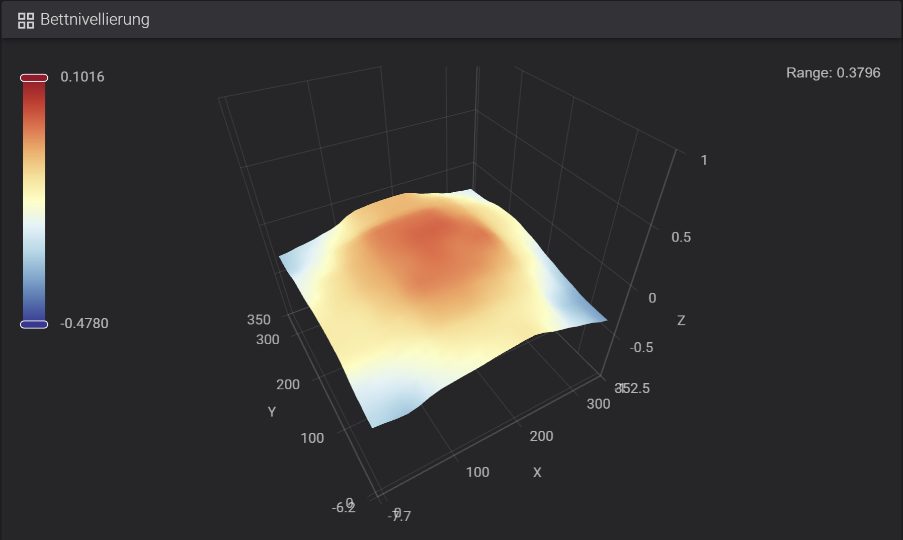

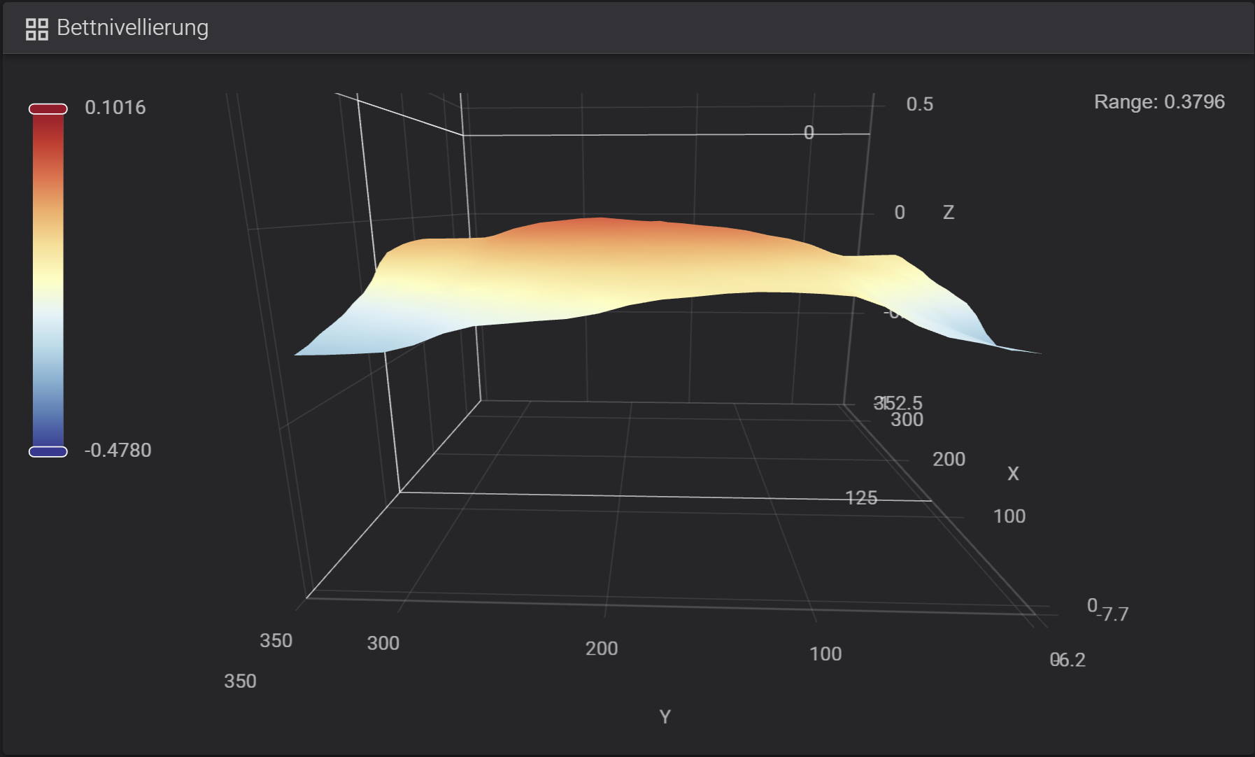

Here is my Bed Mesh with PETG and 70 degrees

Interesting, I have also seen the files and have problems with the first layer - I have already leveled the bed with aluminum foil and according to fluid I am at 0.21mm at 60° bed and at 100° (ASA/ABS) at 0.27 - which I think should be good enough for a reasonable first layer.
I also use different Z-offsets (PLA/PETG/ASA) which, according to Fluid, are also adopted for printing - unfortunately, despite the relatively good bed, I still have differences with good and bad positions. I therefore assume that the ABL does not really work, even if I see in Fluid that it wants to correct the bed during printing.

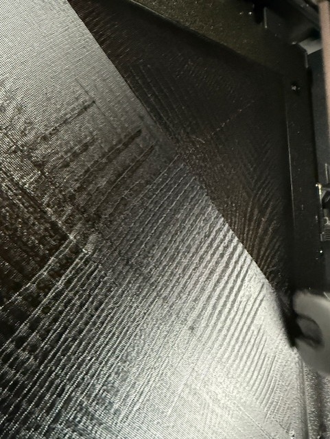

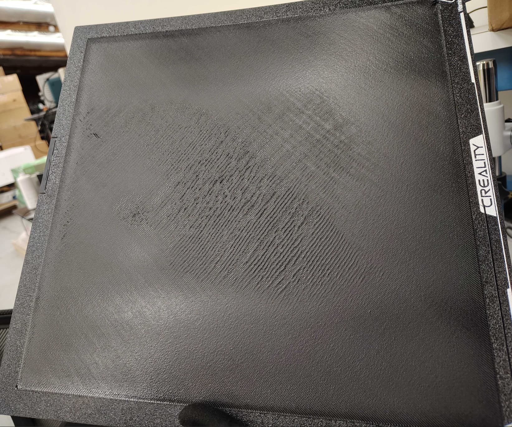

I have read the entire thread and I must admit I am lost in the details and you guys know way more than I do on how these printers work. I have the issue of a strange pattern on my first, 2nd and thirds layers but my print end up being ok, with no real bed adhesion issue but I do get the occasional blob of PEG that that drops on the print, probably due to the print head getting too close to the bad even though I do have a .025 positive z-offset for PETG. I do ABL after heating the bed to 80C for an hour.
Any thoughts on this as I am lost and now have to figure out how to get Creality support to figure this out
