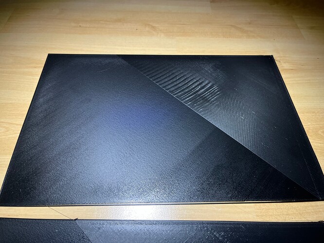

I have had the printer since December 6th and I am constantly frustrated with the first and second layers. It even got to the point where I had to take the extruder apart several times because the first layer in the middle was too close to the print bed and at some point it stopped extruding.
And that was just PLA, with PETG there are even more problems until the extruder can no longer feed the filament.
PETG
The 1st and 2nd layers are actually perfect at the edges, but the problems always occur towards the middle and in the same place, even though I calibrate the 1st layer every time.
At the moment the K2 Plus is just a decoration item, since I can’t print large parts and if it takes me 10 tries to get it right, it’s frustrating.
By the way, my bed mesh is in the range of 0.6
Here in the last picture the 1st layer was still ok, but there were problems with the 2nd layer and I had to take the extruder apart again because it couldn’t transport the filament because the printing of the 2nd layer was again too close to the 1st layer, even though the 1st layer was still ok.

But to reinforce the theory again, I printed out a 300x300x0.2mm sheet and the problems start in the middle, I just wanted to clarify that again.

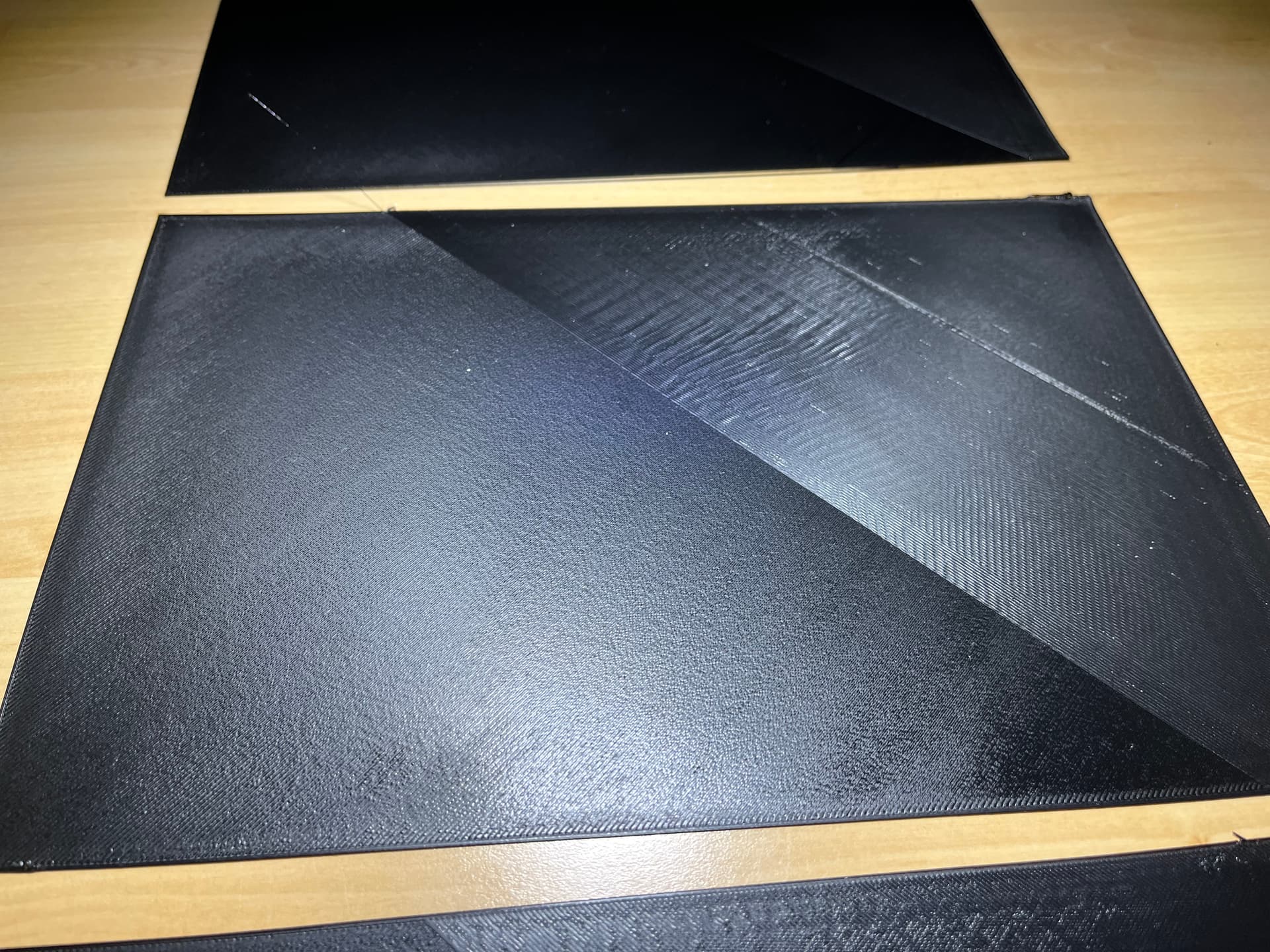

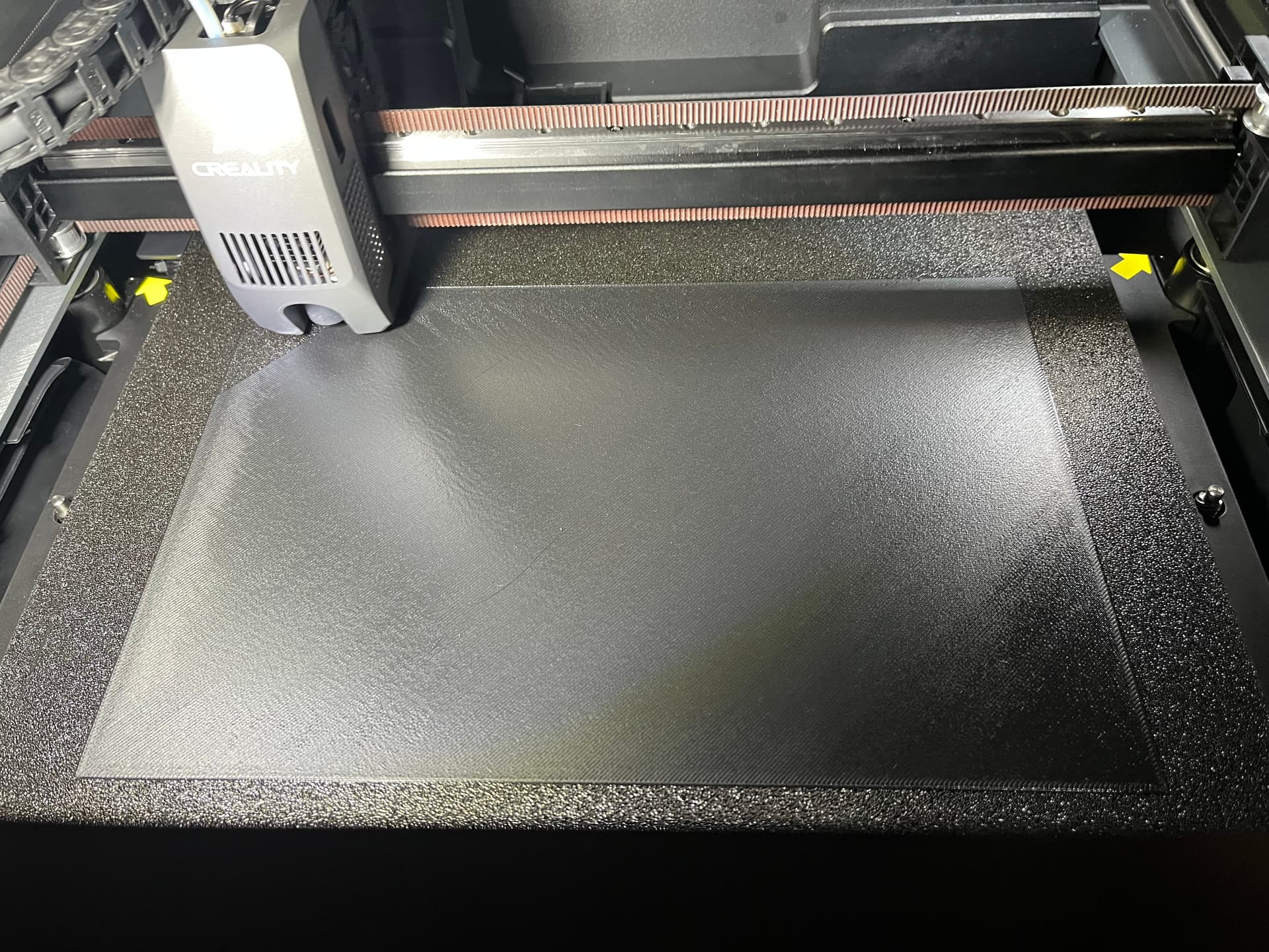

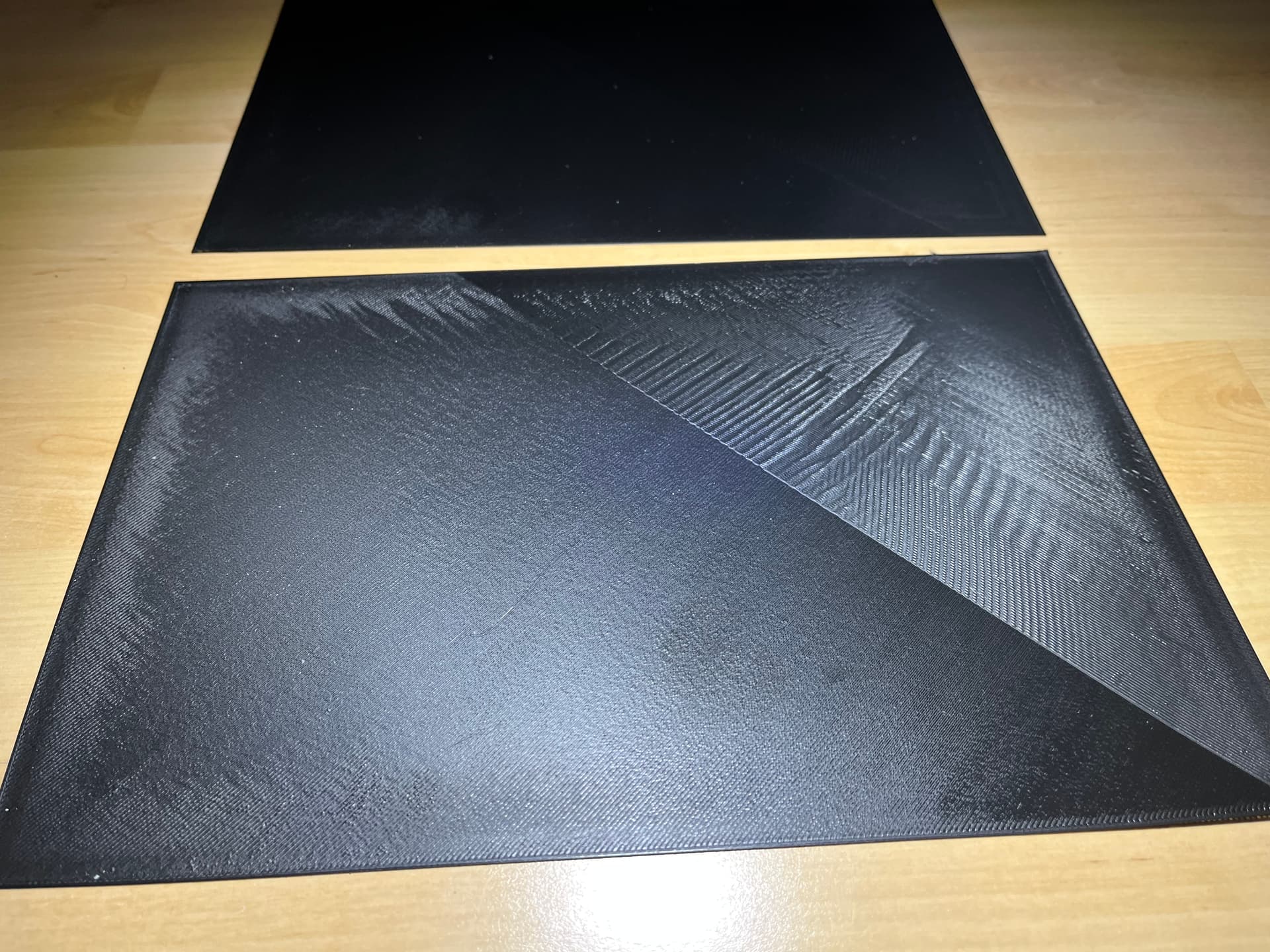

I’ve also attached a few pictures. The first one is a few weeks old and was taken with the old firmware. In the second picture, I preheated the print bed to 70°C for several minutes before printing, using the latest firmware, the current slicer, and a new nozzle—that was yesterday. Today was the third attempt, printing under normal conditions with the door open, but again, no change.
Normally, I already have issues in the first layer, but here everything still looked fine. However, in the second layer, the infamous waves appeared in the center again.

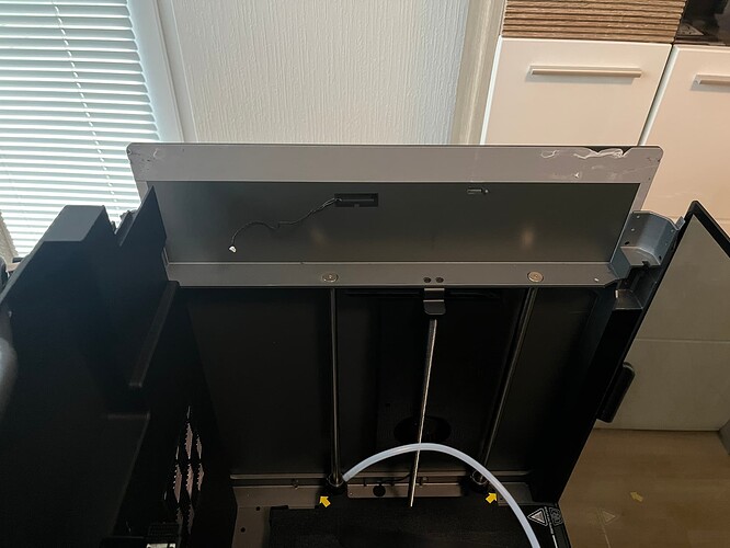

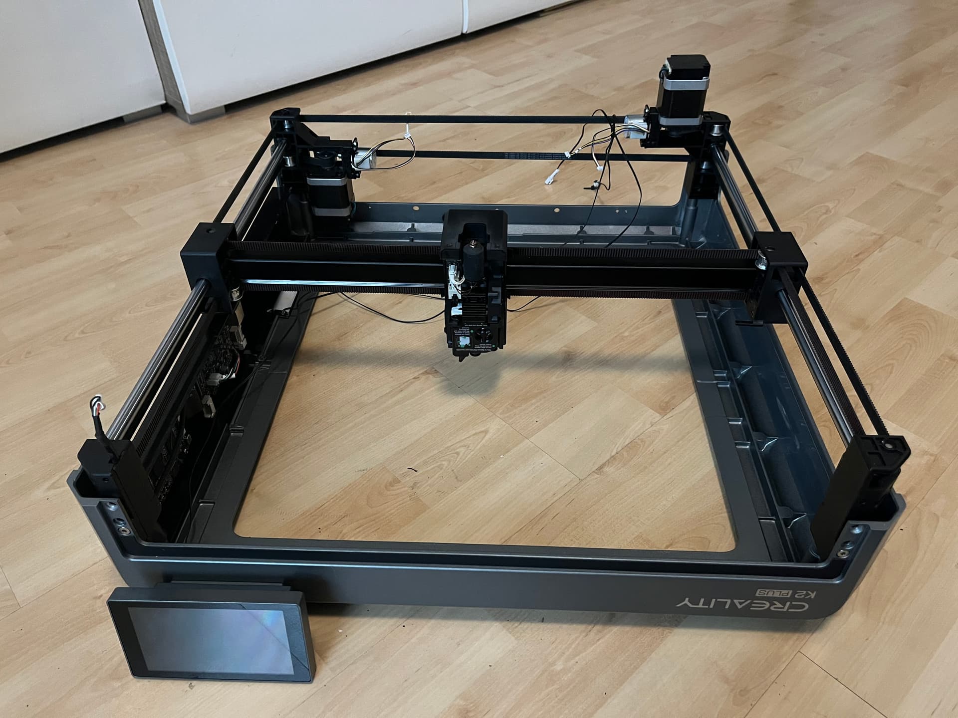

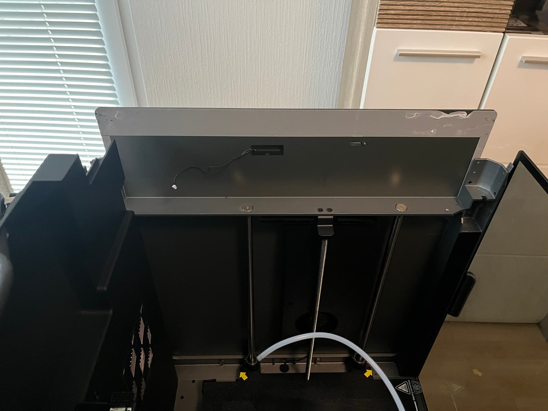

But despite all measures and tests, even dismantling the top part of the printer - I had the entire portal in front of me - nothing helped, except that the automatic belt tension no longer works, which is my fault.
Disassembling the upper part is anything but easy, and I wouldn’t recommend it to anyone.
If anyone is interested, this is what the top part looks like when it is removed and only then can you take the Gantry apart.
The pages are only glued on, but can only be removed with a lot of force.
