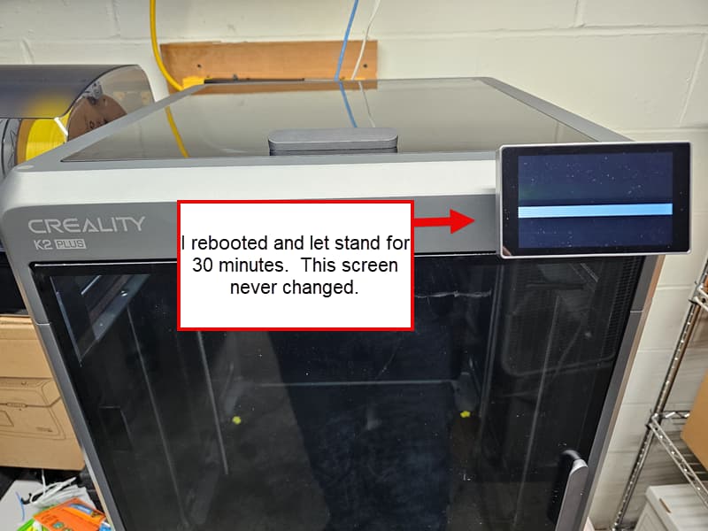

This morning, I turn on the printer and get the Creality screen then it went black with a thick white line through it. Bricked itself?
Ok, tried to do the Manual Reflash following the instructions.
The USB driver will not load on Windows 11, Windows 8, windows 7 and Windows XP.
What am I supposed to do with a brand new (2 week old) K2 Plus that is now an ornament on a desk ?

Man I feel so bad for you I’m sorry your having all these issues it seems like your pretty adapt to the machine as far as the display goes have you tried to reseat the cable it’s an off shot but wiuls be nice to at least see your screen
And connecting via Ethernet might switch things up

Attached is the lovely boot screen I get now. CS says oh you’re using the wrong method to reflash, TS says no use this (as posted). The driver is outdated and does not work on Windows 11, 10, 8, 7 and XP. I’m lucky to be an Uber-Geek to have multiple laptops, each with different Windows OS’s to test on.
This has been a true nightmare. It’s their “Flagship” product too! They ship out defective? OK, within electronics & especially Computers, there IS a thing as “infant mortality/death” rate for new systems. I guess I got the cream of the crop here.
Funny, CS said “what motherboard version do you have” and took about 4 minutes to tell me where it is located. In that time alone, I found where is is and said “brand new unit, I should NOT have to disassemble this to figure out what is going on.” It’s a defective unit.

See my new post. It has a photo of the front of the printer with the display.

You are experiencing heat creep from a faulty fan. You really need to wait on the fan if you haven’t yet.
It became an escalation of failure. Throttle Fan, DOA, Nozzle failure & replaced this also failed. Then the complete unit bricked. I did nothing. Followed their instructions to unbrick… nope. Still nothing. DOA unit.
They wanted me to take off the back cover and tell them what Motherboard version (yes remove the MB completely too!)
This is “supposed to be” a BRAND NEW K2 Plus. Then I come to discover that the CFS was inaccurately reading heat/moisture. I found that some of the screws were over torqued and stripped. Unit was USED ! Probably a return that was refurbished and cursed. (lol)
