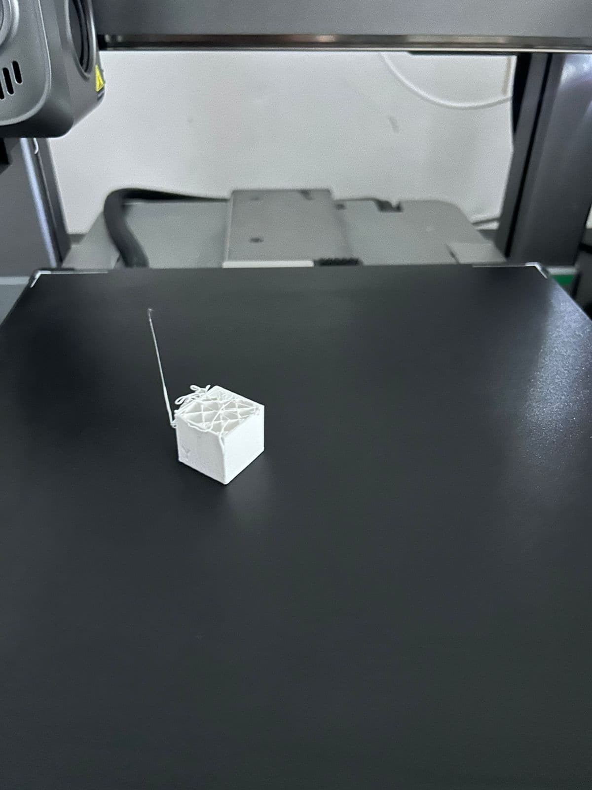

One of my two Creality Hi printers has been failing all week. The prints won’t stick to the bed at all.
The first thing I tried was printing a calibration cube, but it failed. Then I cleaned the build plate with soap and water, and tried again — still didn’t work.
I’ve read that it might be a Z-offset issue, but I can’t seem to find a way to adjust it manually on the Creality Hi or through the printer settings.

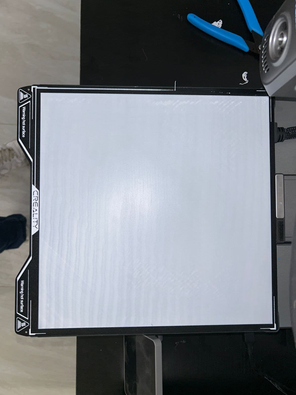

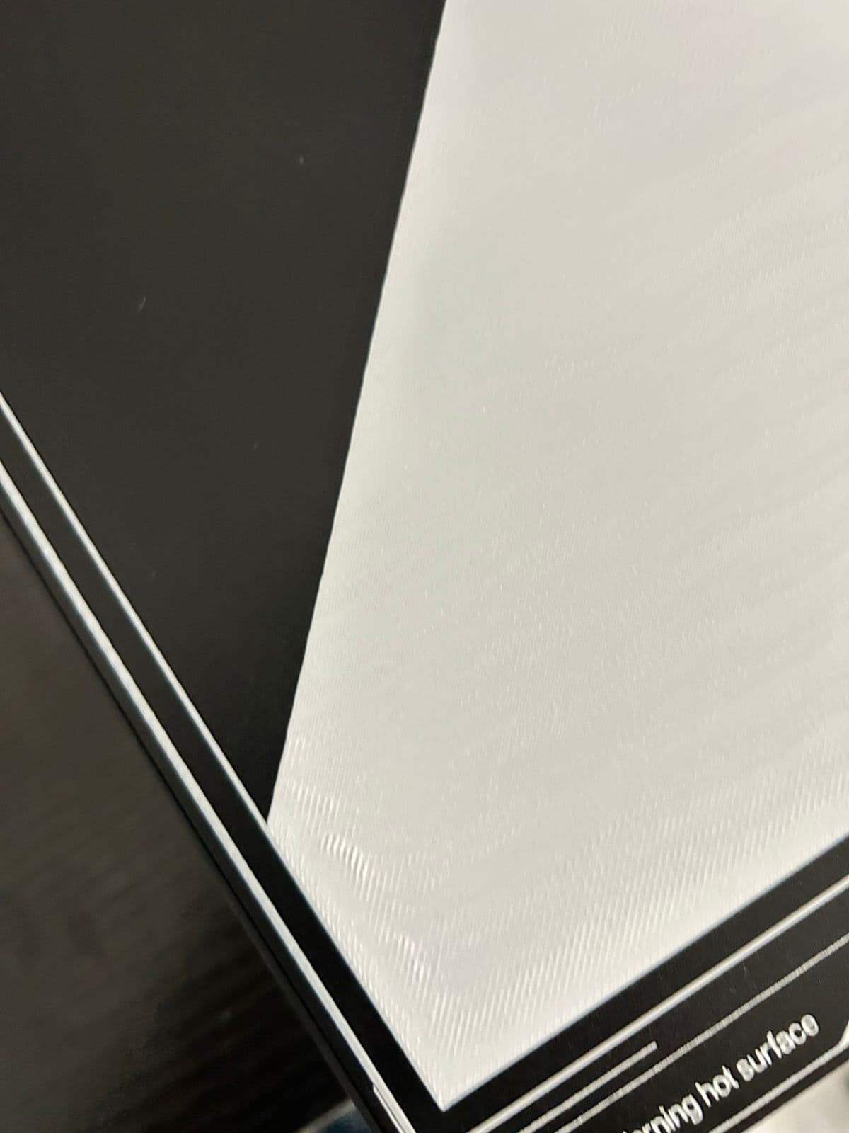

After that, I ran a first layer test (image attached in the post), and nothing looked obviously wrong or extreme, so I went ahead and tried another cube… and it failed again.
At this point I’m not sure what I’m missing. Any ideas what else could be causing this?
There does not seem to be anything wrong with your bed levelling, is this PLA?

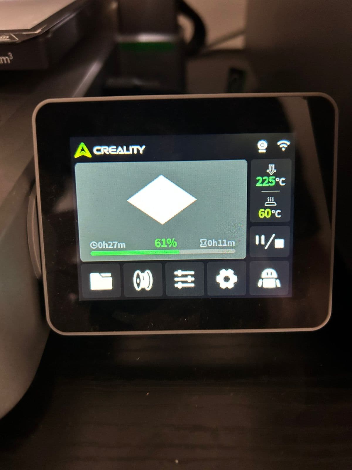

Since the first layer looks good, I suspect less zoffset and more a settings issue. What material are you printing and what bed temps? For PLA, I do 65 bed temp.
You can adjust zoffset during a print in the expert mode menu on the printer, but I doubt that is the issue.

Have you tried glue? Basic kids purple stick glue. Sometimes you need to use it. It might not be ideal but its worth a try. Also try changing the infill, that looks like grid, which will actually hit the previous layer so that can knock the model off as well.

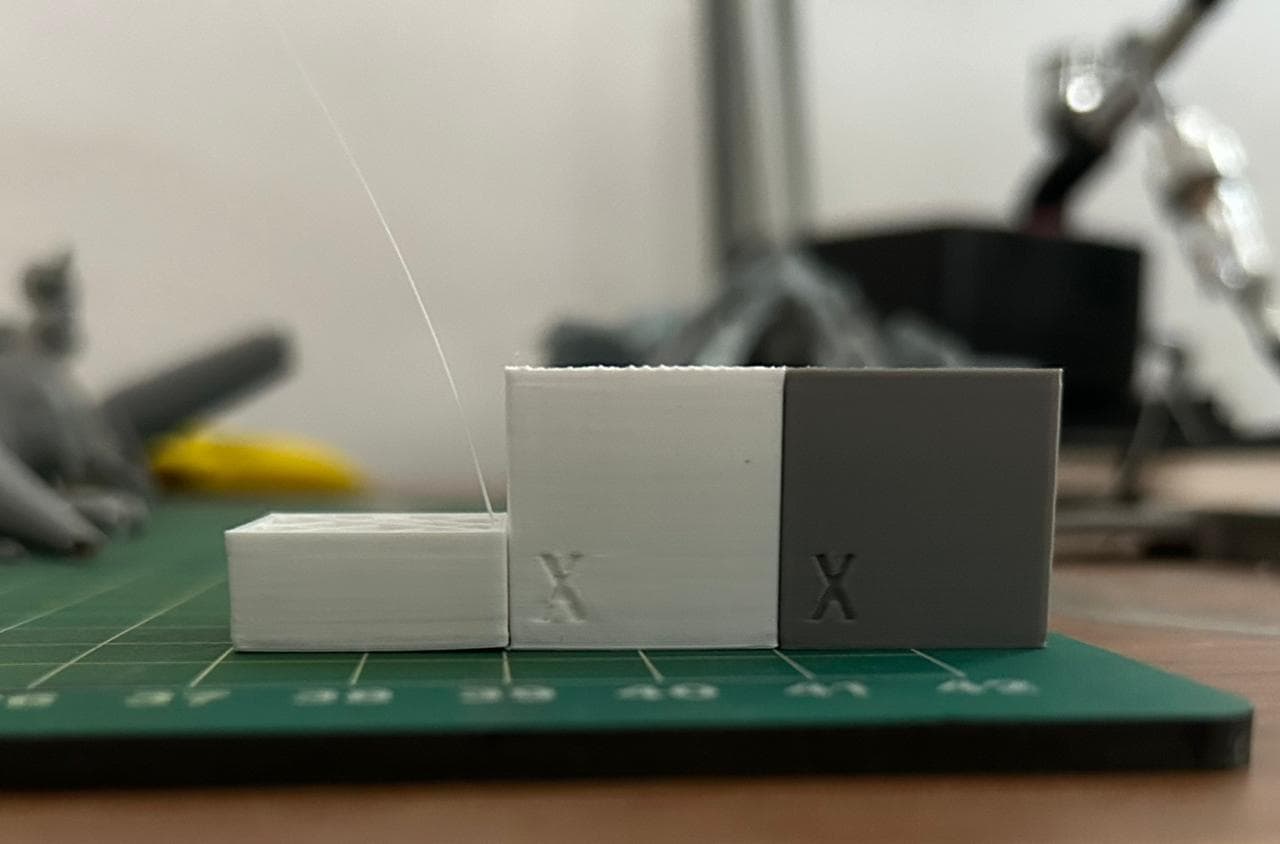

Right now I used brim for another test cube print and its looking good, no detachments from the bed, was that the problem? not using brim, I also set fan 0% in the first 5 layers
left to right, the bad one didnt use brim I see some warping. middle one, 65ºC bed temp, 230ºC nozzle temp, brim, 0% fan on the fisrt 5 layers, last one printed in my other creality hi Printer with no brim
65 degrees is too hot for PLA. That could be your issue. Should be around 50 for a regular build plate. 230 is also high. 200-220 typically. I would leave the fan settings to factory. No need to overthink PLA.
For me, using local manufactured PLA I need 65 and sometimes 70°C on my Epoxy resin bed to have a good adhesion, the manufactured recommends at least 65°C due their formula.
so no, is not too high, it deppends of the bed and the filament.
