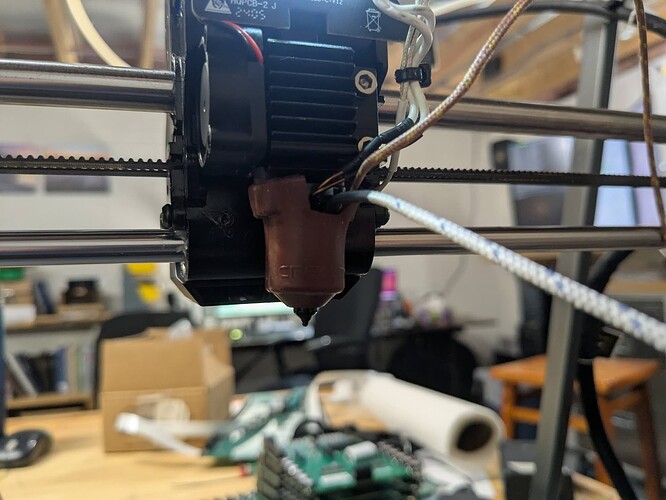

Recently, however, it started making clicking noises during prints and extruding erratically. We have taken it apart, inspected the extruder gears, and cleaned the nozzle multiple times, but nothing seems to help.
We thought the nozzle might not be getting up to temperature, so we put on a few thermocouples, and they seemed to indicate that nozzle temp may be low.
Is this a possibility? If so, what are the next steps, or are there other things we should be looking at?

We replaced the nozzle, and that seems to have fixed it.
We had been printing some TPU recently, so not sure if that gummed things up to the point where normal filament would not flow through?
Or, perhaps he nozzle just needed to be changed – not sure how long they are expected to last.

The first time I replaced the new nozzle with the old one. After two prints, the nozzle got stuck again.
I print with PLA. I thought the extruder spring was loose, causing the filament to push through.
So I ordered a new motor and extruder. When I got it, I changed it and started a print. And my brain exploded.
Same problem again.
I had also bought a hotend from the same seller, but he had given me a K1C hotend. The wires were short and the sockets were different.
I had to disconnect the wires from a broken hotend and with difficulty connect them to this K1C hotend.
and Hurray! Problem solved. The moment I was opening the old hotend, I noticed that one of the wires had come loose without my hand the enameled wire connected to the ceramic heater.
And I think the hotend was transmitting the wrong temperature to the system, causing the filament to not melt properly and causing it to jam.
I hope that replacing the hotend will solve your problem.
I was really annoyed. I opened the device every day for 3 weeks. I wasted nearly 2kg of filament. Because every time I tried to print, it would print for a while and then randomly get stuck.
