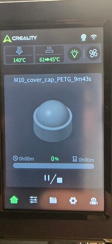

Cannot print ABS or ASA due to the bed warping at 90c. PLA prints fine but the bed temp is at 45c for PLA. Auto level runs at 45c on the bed temp so when I try to print at 90c bed temp the nozzle hits the bed. Any ideas on a fix or get around?
Prehit the hotbed manually and only after this make a map from the web interface. Probably you will need a fluid.
Run the bed to 90 and run a autolevel mesh at 90, I can do that on the older 5plus, never tried ABS/ASA on that printer as it is open and prone to the prints warping, youād be better with an enclosed printer or add an enclosure.
You cannot do a bed level at 90. It will not do a bed level until the bed temp drops to 45. It is in an enclosure
Nope, you can. But you need to do it from web interface, not from the screen.

Okā¦i tried all this: for petg set bed temp 70 degrees.
Slice in creality print and slice in orca slicer.
Send to printer from slicer upload and print. Just upload and print from screen. Store to usb and then print.
Preheat bed to 70 and send from both slicers, from web interface, from usb, from printer screenā¦
Same problem. Printer wait to preheated bed to 70 cools down to around 52 and after that it start printing. And when it start to print bed temp is around 55 degrees.
And I have enclosure!

On your second screenshot you can clearly see that target temperature is 45. So in slicer you used 45. You have to change it on every types of build plates (you have 3 deferent types). Because you use a new type - epoxy build plate, so itās use this temperature. You donāt even know how to use the slicer and you say that you are not a new to 3d prints.

On my second screen shot you can see that printer cool down bed temperature from set temperaturein slicer. I set new values for my print bed in slicer to 70 degrees in slicer. And I have more then 3 different types. I even check start code to see why it donāt wait for bed and hotend temperture to stabilise and then start to print.
Yes creality saying this is new bed and 45 degrees shuld be great for bed adhesive.
Maybe 54 degrees is to hot? And is this the reason why PETG wont stay on bad?
