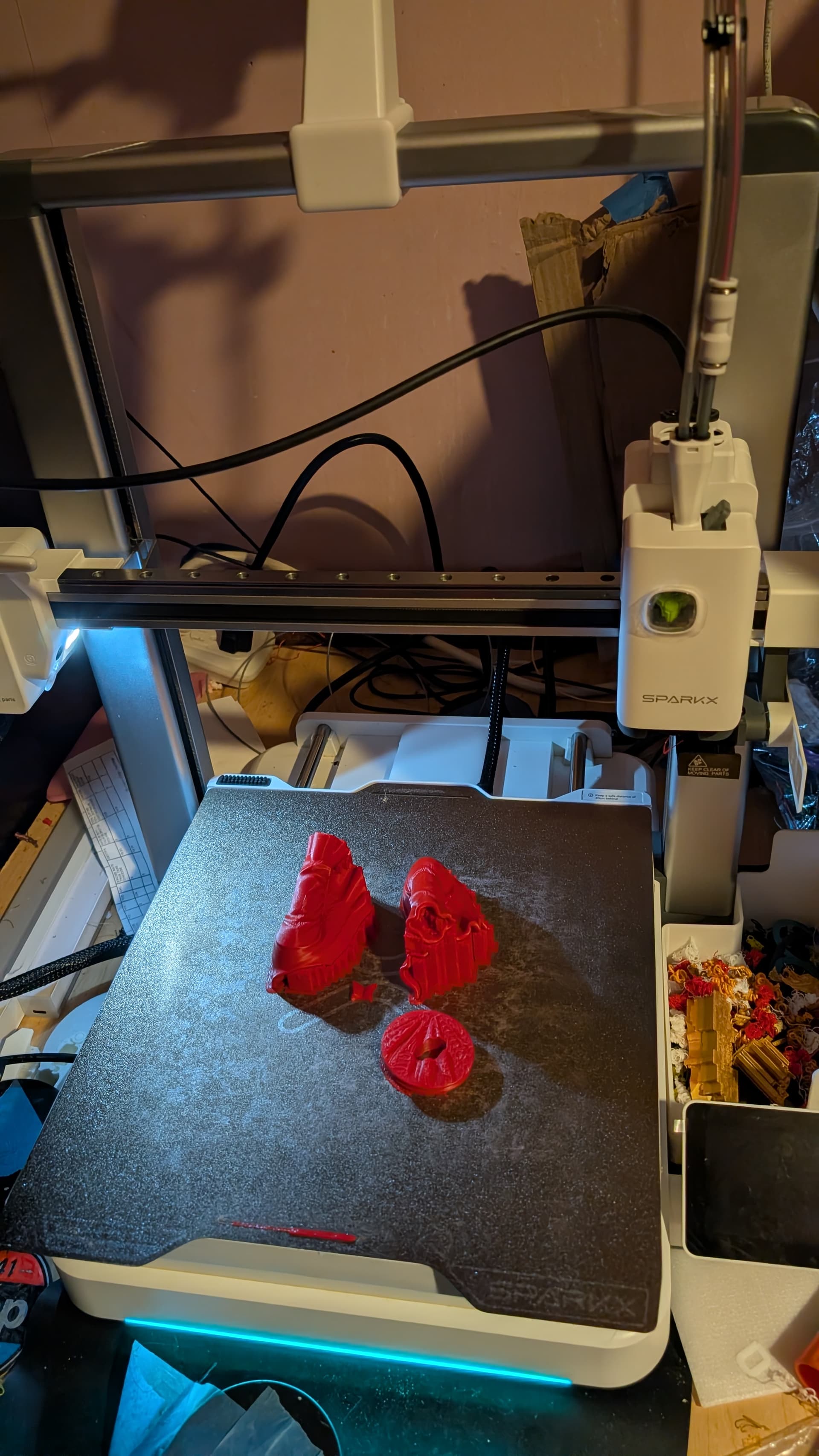

Printer : Creality Spark x i7
Materials : PLA + Acrylic Markers
Slicer : Creality Print 7 default profile with minor changes
Print Temperature : 215c
Bed Temperature : 55c
Layer Height : 0.2mm
Retraction : 0.5
Wall generator : Arachne
Precise Wall and Precise z height : Enable
Support : Normal Auto + Remove small overhang
Support Top Distance : 0.25 mm
Top layer interface : 2 layers
Support / Object xy distance : 0.5mm
Support / Object first layer gap : 0.5mm
With the above support setting it is super easy to remove the support. No more seized together.
Brim : Outer Brim Only
Brim-object gap: 0.15mm for easy remove
