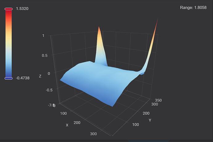

A huge spike in just one corner - I mean a cone - this is a first..ever
Has anyone else had this happen or have they seen this with their bed mesh? This is just wild to me.

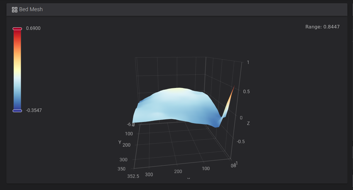

Yeah, when I accidentally left the two extensions installed from my old bed, used to raise the corner stops that help guid the bed plate:

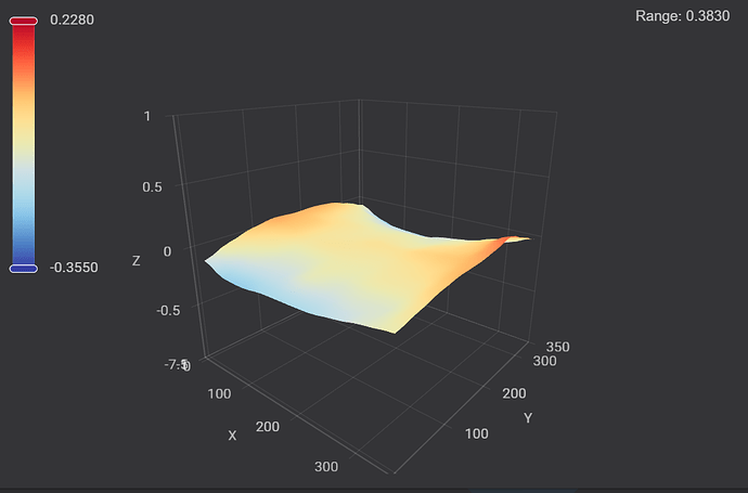

Once I removed them:
The whole print head was basically hitting them first before the nozzle could reach the bed. It did show that the calibration is much more intelligent as when it hits extreme changes it will do extra tests on and around the area trying to confirm it wasn’t a one off glitch.
Thanks for taking the time to respond and so thoroughly! I don’t recall seeing any sort of extensions under the bed frame when I installed the new bed. Do I have to take apart the bed again to remove something that was left behind? Creality support told me it was normal and that no bed is perfectly flat, and that all that counts is the print quality and to print an entire 0.2mm thick square on the entire bed. I tried telling them that it’s physically impossible without damage for that spike to occur, that sharp angle.

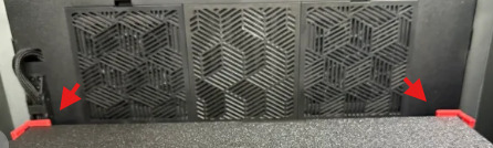

No sorry, I meant something like these that I used with my old bed when trying to fix the warping. As I had raised the bed to the point that the fixed corners weren’t tall enough to guide the plate:
When it was probing those corners the main print head would hit those before the nozzle hit the bed and produce a false reading.
