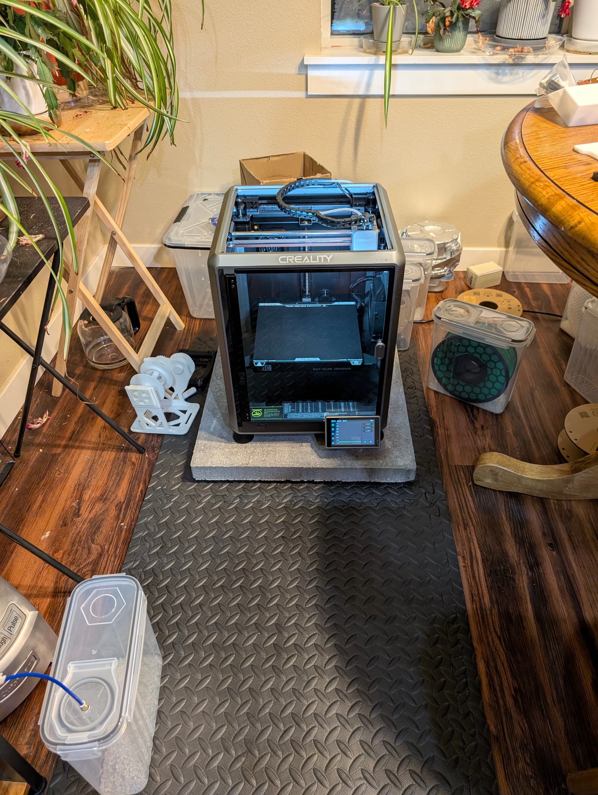

Pic attached is my setup: A 20"x20” concrete paver atop carpet pad (concealed under the paver) atop foam gym floor. The padding is because I live on the second floor and want to insulate my floor, and thus my downstairs neighbors, from the vibrations. I’m a dirty apartment dweller, so no garage for me.
