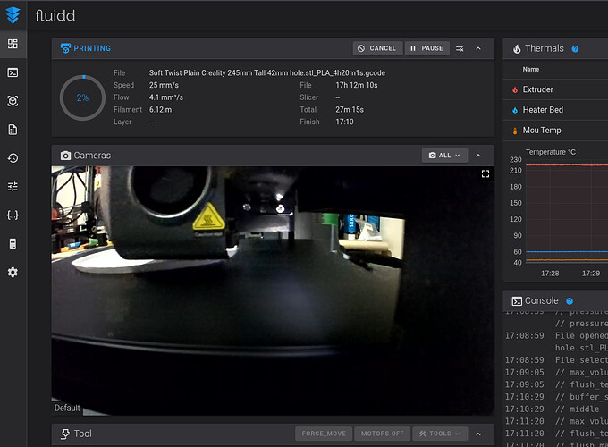

So after a long time using Klipper on my other printers I was wondering why the Klipper/Fluidd inteface for the Hi had no webcam feed. I tried adding it in the fluidd interface settings but nothing showed.
I went digging around and found a github place that enables this on the K2 range of printers and thought I’d share here with all of you incase you may want that feature for your Hi.

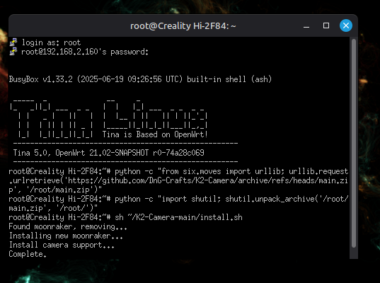

SSH into your Hi with root access and paste the following:
python -c “from six.moves import urllib; urllib.request.urlretrieve(‘https://github.com/DnG-Crafts/K2-Camera/archive/refs/heads/main.zip’, ‘/root/main.zip’)”
python -c “import shutil; shutil.unpack_archive(‘/root/main.zip’, ‘/root/’)”
sh ~/K2-Camera-main/install.sh
After that you will get your camera working in fluidd after a refresh.

Here is my screenshot for proof it works.
Here are the commands below on seperate lines to make it easier for you to copy and paste.
python -c "from six.moves import urllib; urllib.request.urlretrieve('https://github.com/DnG-Crafts/K2-Camera/archive/refs/heads/main.zip', '/root/main.zip')"
python -c "import shutil; shutil.unpack_archive('/root/main.zip', '/root/')"
