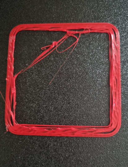

After the firmaware update is not possible print nothing because lost the adherence. All the pieces come off the bed. The first layer is very thin and does not cover the space between each coat.

You probably need to manually adjust the z-offset, if it is pulling off the bed you aren’t quite getting enough squish onto the filament. Try printing a 50x50x0.2 thick layer and adjusting the offset while it is printing that, then turn off autocalibrate as that will reset the z-offset you’ve just dialled in.

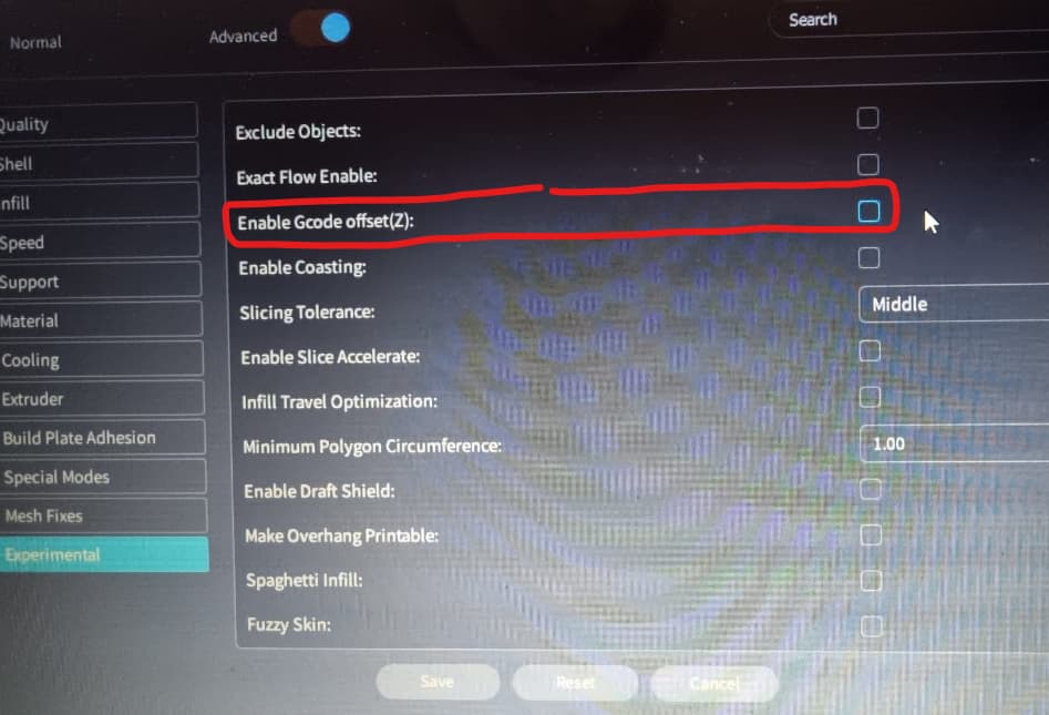

My intention is identify the z-offset needed to correct the adherence problem and define it in the Creality Print slicer software at field “Enable Gcode Offset (Z)” (see image) to avoid to put manualy whit each printing.
Could be this a permanent solution ?
If you set it using the method that I described you only need to set it the once. Must be at least 6 months, perhaps more, since I levelled mine by manually setting the z-offset. The autolevel is close but I find on my V3SE and V3KE that I have to lower the z-offset but once it is set, turn off G29 and any other autocalibrate at the start of each print. I do not use the enable gcode offset, last time I tried it it kept incrementally adding the offset to last print level until it crashed the bed. I’ve not tried it with autocalibrate, might work, worth a try, I shall continue with my manual setting.

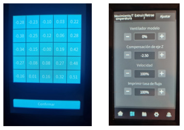

2- I did an auto-calibration, this is the results and the z-offset shows the value -2.50:
3-I tried to print a square 50mm x 50mm and 0.2mm thick layer with 8mm of brim around (thick of brim 0.2mm) but this was the result (there is no adherence):

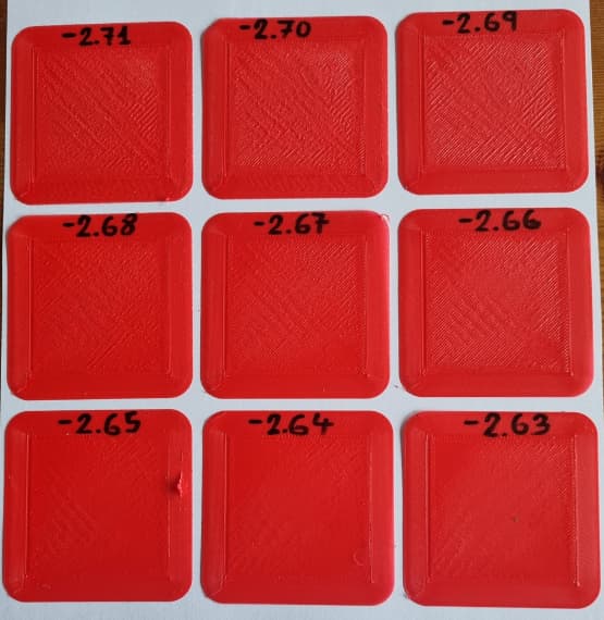

4- I’ve measured the distance between the hot-end and the bed using the classical method of the paper and I probed increasing the z-offset value to reduce this distance.
5- The first z-offset value to reach the adherence was -2.63. I did more test increasing 0.01 the z-offset value in each test until the hot-end touched the bed with the z-offset value set at -2.71:
6- I’ve set the z-offset value at -2.68 and I tested a print for a part with normal quality (thickness layer 0.2mm) and this finished correctly:
7- I tested a print for the same part with high quality (thickness layer 0.1mm) and this finished correctly.

1- Issue solved

1- The auto-calibration on new firmware version V1.1.0.15 doesn’t run correctly
