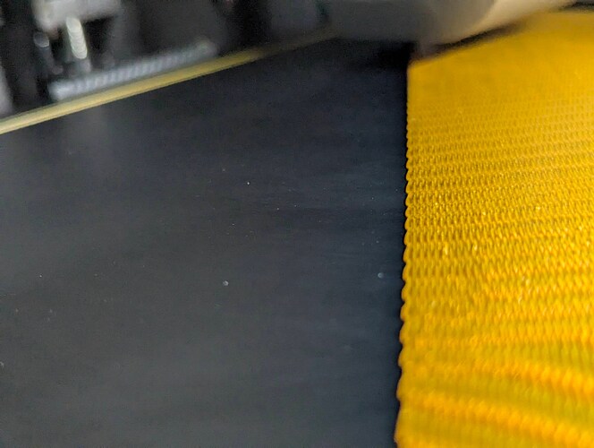

I just bought the K1C. in the first couple of weeks, it printed great! then the prints starting looking bad, with uneven surfaces. i updated the firmware today and ran the self test again, then printed this test print in the photos (a square of 1 layer thick). This layer was 0.2mm, printed with PLA silk, 100% extrusion, at 45 mm/s, 220C nozzle and 60C bed temps. I changed the filament to PLA +, ran the self test again, and still printed the square just as before.
You can see the differing Z heights and wavy XY lines, but it makes a pattern only in part of the bed…which tells me it’s not an extrusion problem, nor a vibration problem, nor speed. the last photo is of the bottom of the print to show the holes it created, which means the nozzle is lifting as well.
the skirt line also shows there is a leveling problem - even though this was printed right after the self test; in the back right corner, the line was slimmer on the XY and thicker on the Z axis, and the line at the front left corner was wider on XY but so thin on Z axis, it’s translucent.
The motor does not feel jerky when it was printing and the belts feel properly tensioned and not loose. It’s just not printing a smooth straight flat line. What could cause this and how do I fix it?
Wobbly lines looks like the z offset is too close to the bed, adjust it up by 0.05/0.1mm or you are overextruding try adjusting the flowrate to 85/90% to see if it improves.

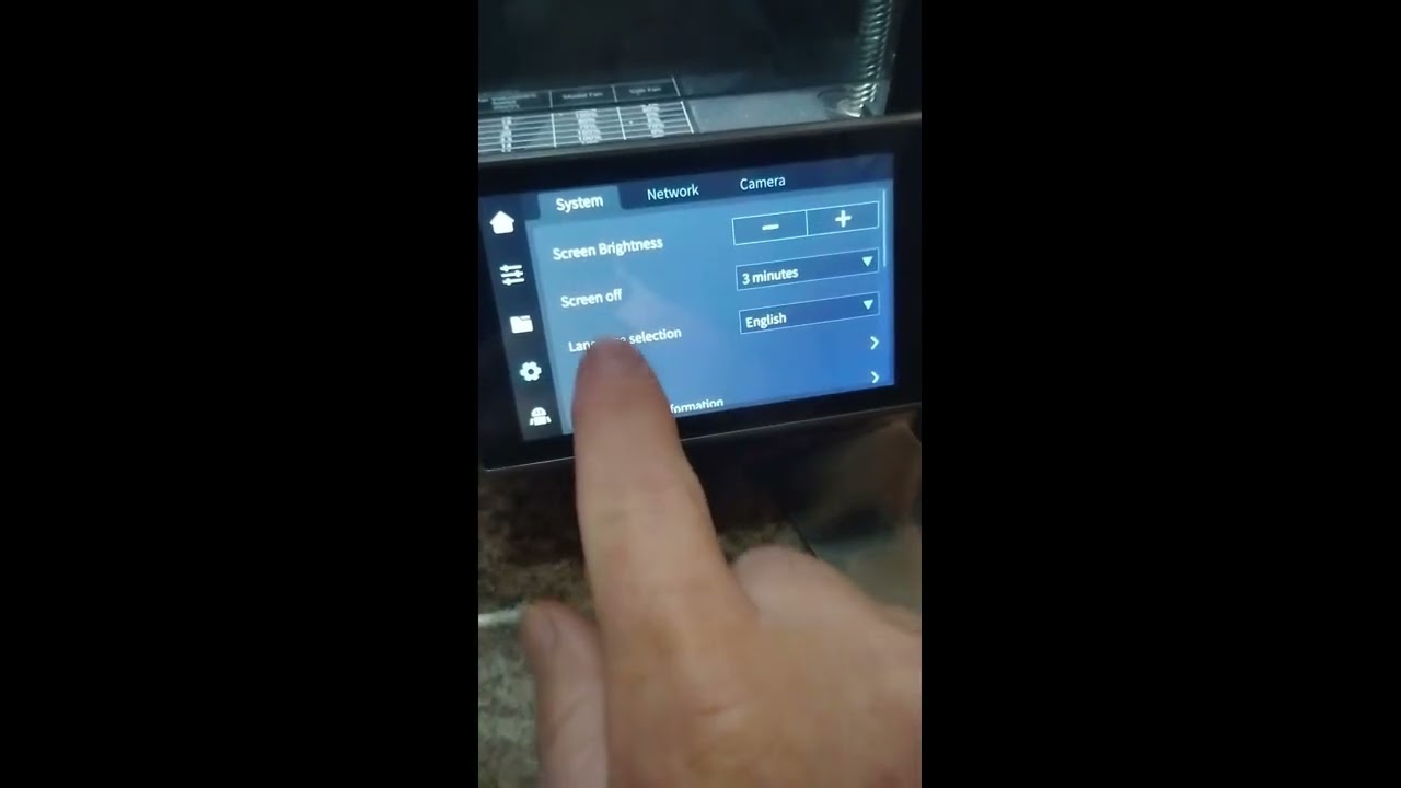

@Hue_Le , I noticed in the control board interface (LCD), there is a two-option setting that deals primarily with leveling and setting the build plate ratios for input shaping.
So, here is a short video on it and this may help. Remember to change physically the filament and filament in the GUI too. So, if you are using ASA physically, use the ASA option in the GUI and change from that point forward to suit your needs:
Video:
Enjoy and repeat!

i tried changing the flow and it made it worse, so i changed it back to 100%. increased the z offset and it got worse, so i decreased it, all the way down to 0.100, and it fixed it :smiley:

Yeah, apparently. what could change the z offset out of the blue like that? it was just fine one day, then just went bad the next day.
thanks for the explanations and suggestions up above, i’ll look into them and see what i can change :slight_smile:
Just guessing, but a slipping belt could change lots of things. Are they all snug?
