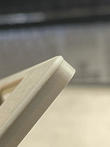

After base layer I get a fuzzy bulge
Hey all,
I have a weird issue. I am printing a 1.5cm test cube. I use 0.14 layer thickness and 0.2 for the first layer. I have 6 bottom layers.
The first 6 layers print fine but then, as soon as the infill starts I get a bulge around the bottom.
I tried pretty much everything. It’s NOT an elephant foot.
What could be causing this?
IMG_2707|666x500
What material are you priting? also, what temp is you hotbed printing at?
I am using DEEPLEE PLA+, plate is at 60° C.
It makes NO sense. The first 4 layers (bottom thickness) are perfect. And then it warps out and back in.
Must be something mechanical. Definitely not a temp issue, I think.

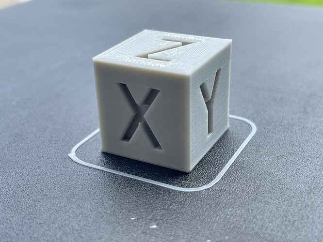

A slighly bigger part. The left side was on the plate. This one has small bevel on the bottom layer to the verts. Same thing. Bulging out after printing bottom layer.

I found out what it was: Lead screw nuts were worn out from the factory on a 1 week old printer.
