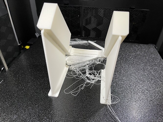

Hello, I‘m a bit confused about the AI camera function. Is the AI detection working by simply turning it ON in the printer‘s menu or does it need a paid subscription from Creality? There are different information on the internet. Thanks a lot for a short clarification on that.
No subscription, though I found it was necessary to actually turn the AI print failure detection feature on, after I woke up one morning to find THIS had printed overnight…

Oh, it is definitely running. If it weren’t running, I wouldn’t have had to turn it off to get rid of the “A print quality problem was detected” errors and get the printer to resume printing. (There was nothing wrong with the print.)
Thus far, apart from detecting a missing build plate once, the AI detection has never successfully detected any problems, even when the printer was printing nothing but strings everywhere, the model had broken loose from the build plate, and absolute chaos reigned supreme.
But false positives? It definitely produces those — not just false positives about print quality problems, but also false positives saying that there’s a model on the build plate. (No, the purple glue just turned white when I pulled off the last model.)
