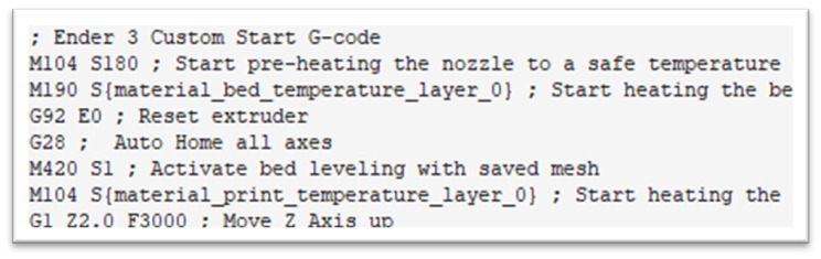

The bed level values are stored as a mesh and must be called at the beginning of each print. This is done with command M420 S1 to enable the mesh. M420 S0 disables it.
In ‘Cura’ select the printer ‘Creality Ender-3’. Then ‘Manage Printers’. Then ‘Machine Settings’. Enter M420 S1 as shown below (between G28 and M104 S)

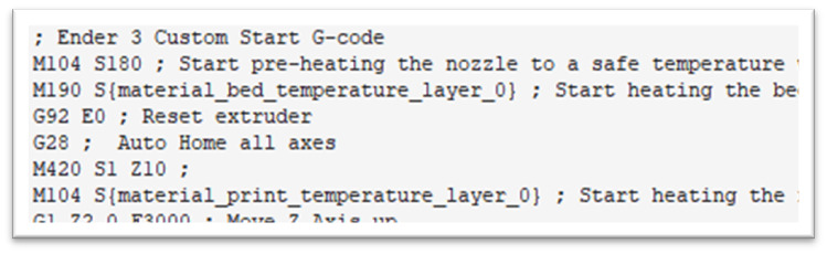

A further refinement can be made by gradually removing the bed levelling so that the final surface, of the model, is flat. If not enabled the top surface of the model has the same contour as the bed. This is achieved by adding the parameter Z and a value to the M420 S1. M420 S1 Z10. Where Z is the auto fade command and the value (10) is the number of mm to achieve this. If desired include this as shown below.
