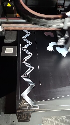

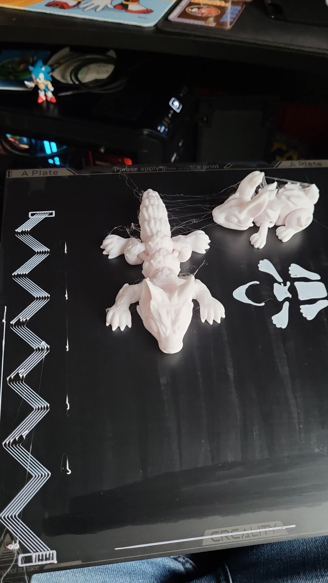

Any ideas how to fix this issue?
Ive had the printer over a year and it worked fine until i had a blockage. Changed the nozzle (non unicorn for a genuine creality high flow nozzle) the prints started off ok but have gotten worse over a short span of time. Nozzle constantly oozes even when i reduce the temp. Lots more stringing and it struggles to do the ai zigzag now with standard pla, however it works much better with hyper pla. Hyper pla does string now when it didnt previously though. Any ideas?
I should add these were printed at 210c, i dont use a fast speed to print, all filaments are dried before use, i have reset and relevelled and recalibrated the printer using the auto settings.
Found a small break in the copper wire to the thermistor, not completely fractured though. Will replace hot end on monday
