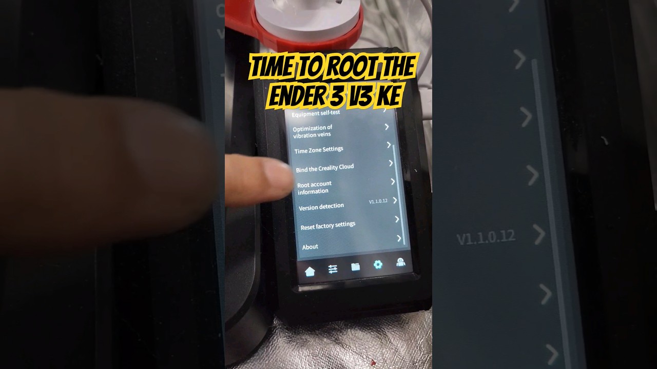

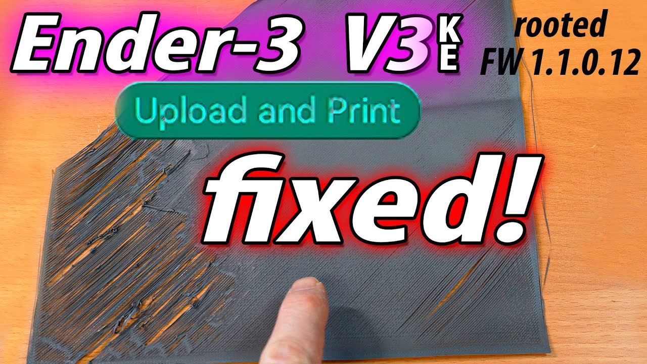

I installed octoprint and got the same error. However, when I look at device I can see my camera. You will not be able to print via wifi though unless you root the system.. There are a few guys in Crealitys Discord Server that are good with this and posted a couple videos in the # ender-series channel.
I plan on rooting it in the future because I’m tried of putting prints on the usb and the cloud site UI/UX annoys the hell out of me.
Some of the videos they posted:
Thanks for that reply and links. I’m not a big “rooting” fan so I think I’ll stick with > export from Orca to local > import to Creality to start. I like the ability to click “send to printer” and monitor from the app or web.
The Orca site is a bit misleading and made me think I could just connect via the IP. Not so much. Hopefully they will make this available in future updates because I prefer the UI much better than Creality Print or even Cura.
