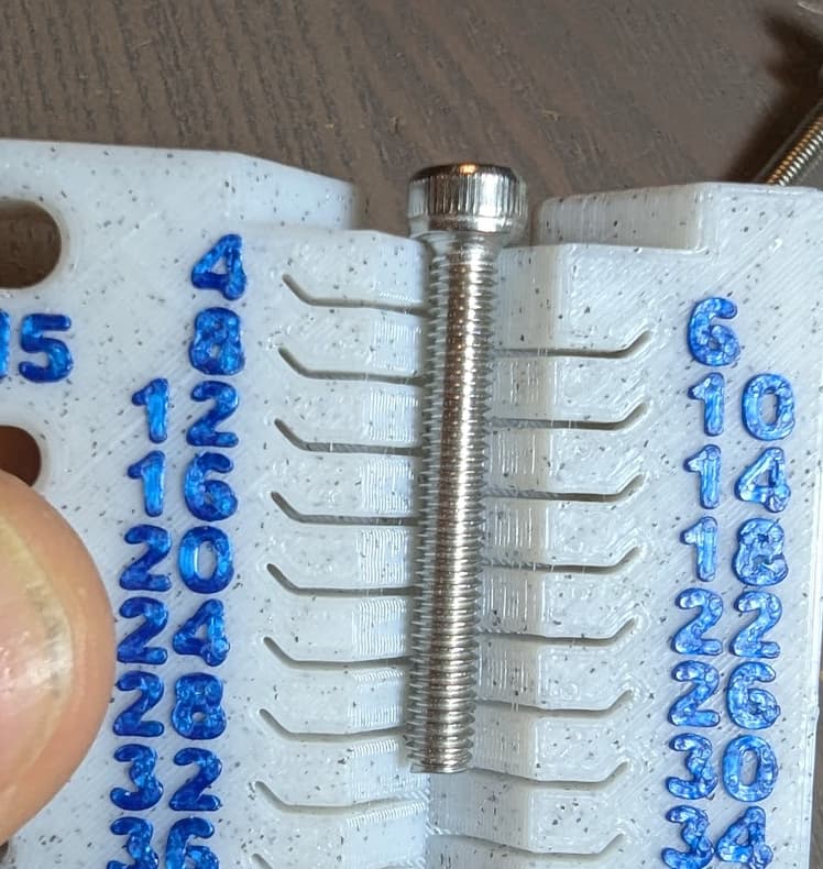

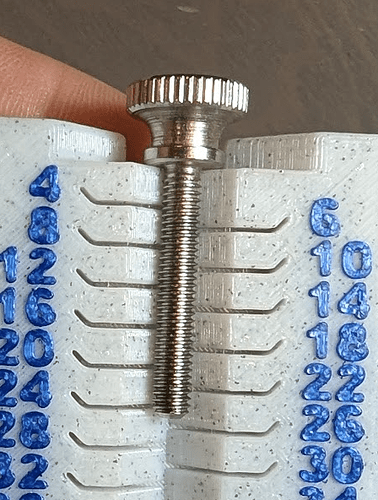

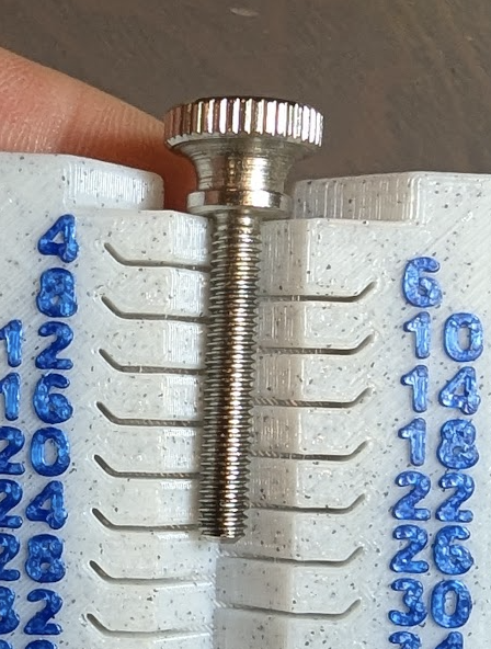

Are you talking about the thumb screw?

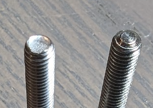

On my 40W Falcon, I could replace my thumbscrew with a M4 x 30MM cap head screw temporarily if I needed to. I would just sand the end smooth of the temporary bolt. This could get you lasering sooner than later.
M4 is 4mm round.
Hiya, that’s the one, I have ordered some from amazon, thanks :slight_smile:
Good deal.
