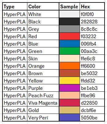

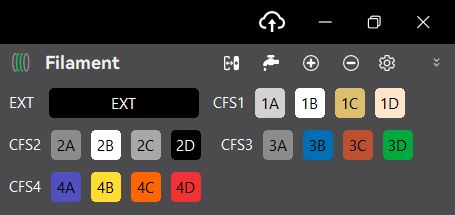

You may set any rgb color in the RFID tag by “RFID for CFS”. Works nice, but on some colors in some screens of the firmware printer cannot show it. Others is OK.
BTW, this is my table for Creality HyperPLA, measured by a specrophotometer.
Just using white 000000 and black ffffff.
Thanks! I learned something!
