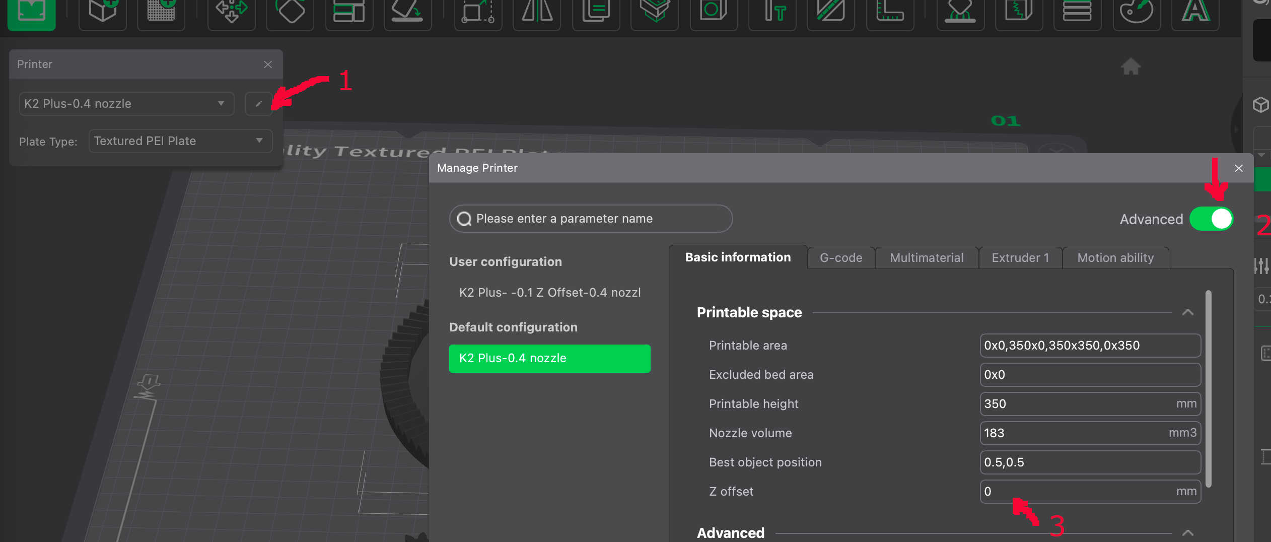

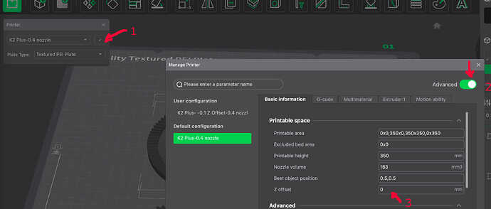

I had the similar problems with ASA.
Try adjusting your printer’s “Z offset”
  1. Go to the Printer box on LHS of Creality Print
  2. inside the popped up box click on advanced
  3. adjust the Z offset.
Some people say you should use negative values ie -0.1 or -0.05 but I found +0.05 fixed mine.
You might also have to adjust your first layer height.

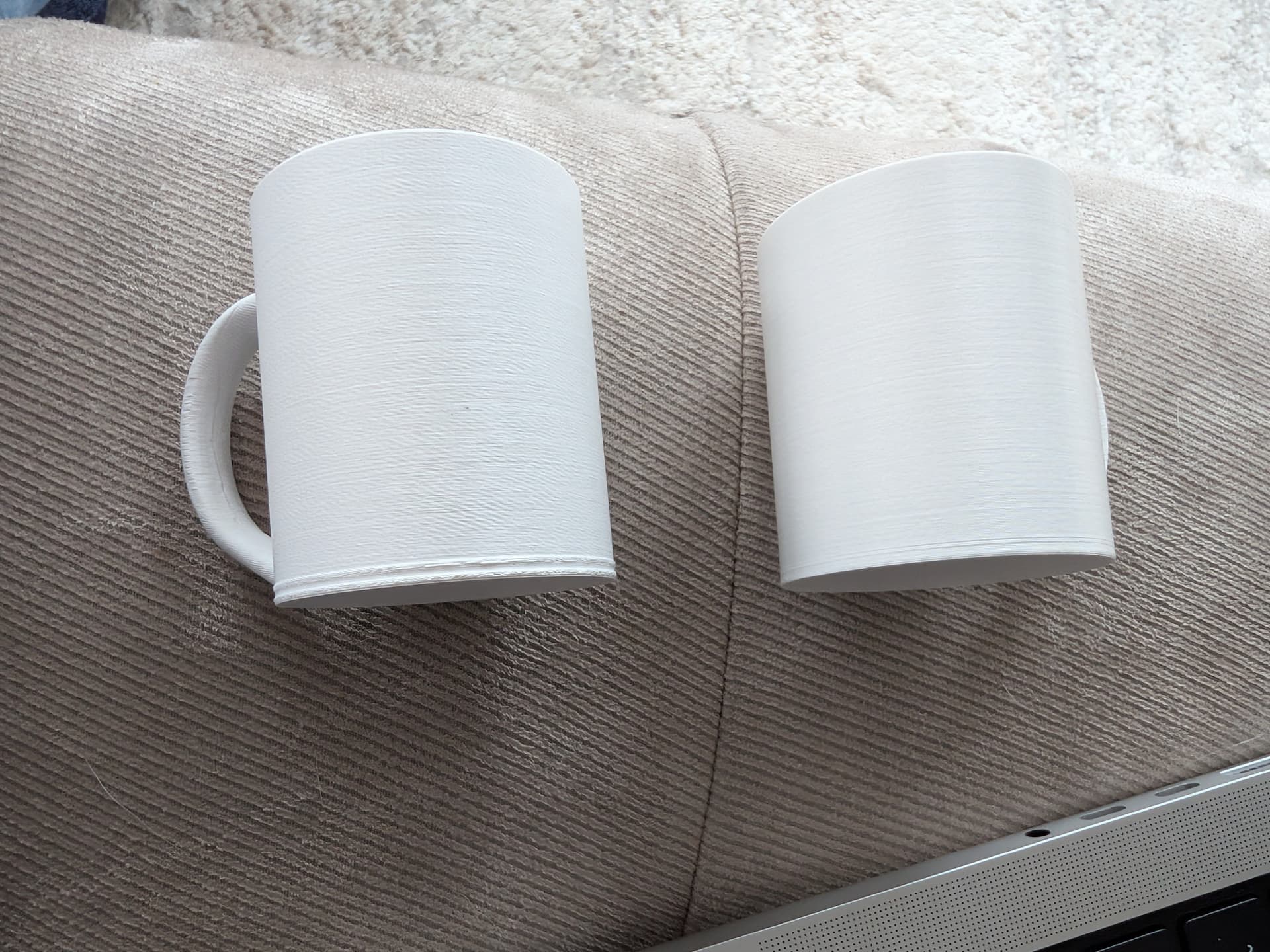

I’m seeing the same thing too. Only on ASA using the 0.4mm nozzle. I think switching to the 0.6mm nozzle resolves the issue but it’s a pain to switch nozzles all the time.
This definitely seems like a software issue because it’s definitely not a bed leveling/calibration issue. The first layer looks absolutely beautiful but on about the third layer up to about 2 or 3mm, the layers scrape like crazy.
I’ve tried several prints with different models, all have the same issue with the 0.4mm nozzle and my last print used
  • 0.4mm nozzle
  • Filament was brand-new and dried for a few hours
  • Stock “Generic ASA” profile
  • Stock 0.2mm layer-height profile
  • Slowed down to “Stable” print speed
  • 13x13 bed mesh grid
  • 1st layer - good
  • 3rd layer + several after - trash
  • By the time it gets past ~3mm or so, the issue seems to clear up
Here is a 0.4 (left) vs 0.6 (right) nozzle comparison. 0.6 isn’t perfect either but it’s waaaay better.
