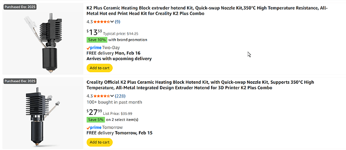

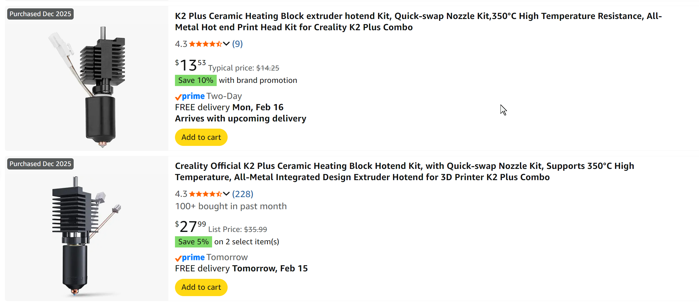

Based on what you described (plastic fragments, shutdowns, sticky residue around the toolhead), you’re most likely looking at replacing the hotend/toolhead assembly.
Those are available from Creality and Amazon. If you live near a Micro Center, they sometimes stock them locally (call first).
Creality has short install videos here - watch both:
They cover essentially the same process in slightly different ways.
There are many Amazon listings. If your unit is an early model, this may also be a good time to upgrade the factory nozzle. It’s smart to keep a spare hotend anyway - blobs of death happen.
If you’re unsure which version to buy, grab the cheapest compatible one. In my experience, the generic assemblies work just as well as Creality’s branded version at roughly half the price.
Bottom line: post photos, confirm which assembly you need, and be prepared to do some basic hands-on work. These printers are fixable - but you have to meet the community halfway.
