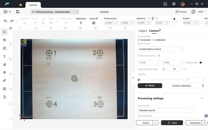

On my Falcon A1 Pro, the projected point does not fall exactly at the center of the working area but is shifted to the right.
Does this happen on your machines as well, or is mine misaligned?
When you look at your picture you can see where it says Creality falcon camera. right below you can see the camera fine tuning. use this to move the lines to over lap as close as possible.
