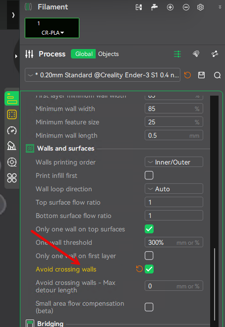

I’m posting this discussion because I am trying to print a lightbox on my K2 Plus and there are blobs of filament being dragged from the extruder head path. In other slicers there is the option for “Avoid Crossing Walls”. Is there a different setting that can prevent this behavior? Are there plans to include this setting in future versions?
A bit shocked this isn’t available since it was in V5.

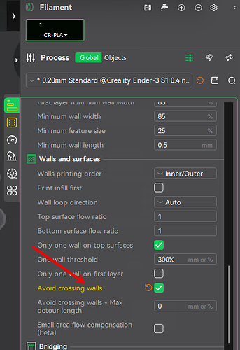

I’m using v6.1 and it’s Under Walls and surfaces?
