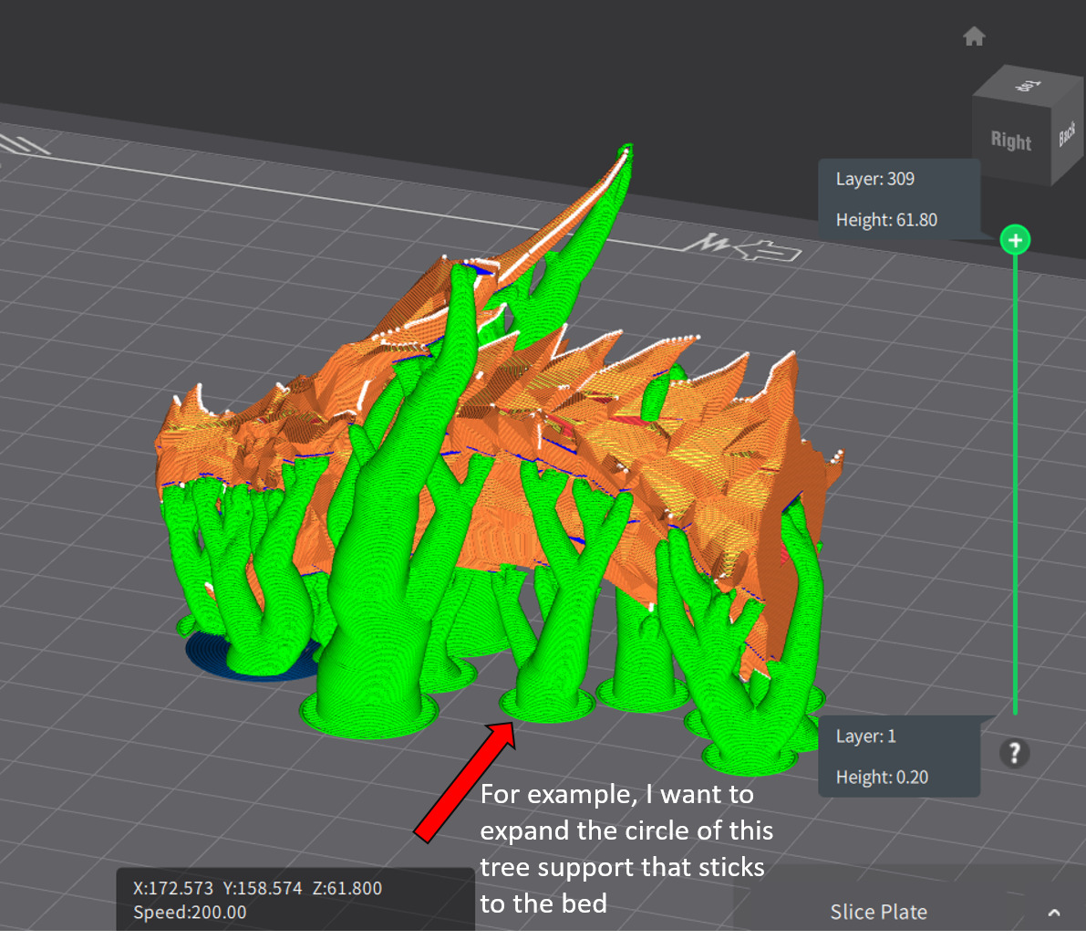

Hello dear friends. I have a k1 max device and the tree support does not stick to the bed. Because the supports have small holding areas on the bed and they lift up.
I tried to expand the lower parts of these tree supports in the settings section, but I could not find the relevant setting. Can you help with this? I have attached an image below.

I think if you go to the support settings and change the brim width…? Give that a try.. :thinking:
What plate are you using and what glue?
Yes I tried these settings. However, unfortunately, this setting covers the model and is of no use to support.

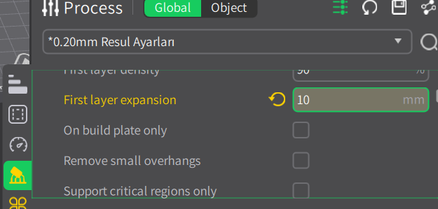

I think I found the relevant setting. People who have the same problem can expand the base from this section.
