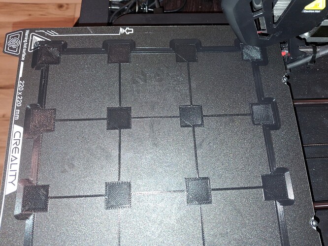

I am to the point that I believe the machine if defective. Here is my main stay in that statement. When I move the print head to zone A and that zone is set for 10 and the machine moves the print head to the zone but, it either stops short of the 10 (i.e. say 15) or it goes past it (i.e. -5). I don’t make any adjustments, I just click to have the print z back up and then I click edit again and go right back to that zone and the print head stops in a completely different area (most likely the correct/calibrated area). This tells me that the machine isn’t getting the axis right for some reason.
With all this being said, I have tried to find a phone number to call from the states to support and I have come up short. I sent an email pleading for someone to call me. So, we will see what happens there. In the mean time, if you have any suggestions or ideas, please, by all means let me know.
BTW: I am going to try and attach some images of what happens on some of the bed leveling prints.

More level than my V3SE by about 0.5mm, autolevel should easily cope with that if the strain sensor and CRtouch are working properly. I would investigate them. I print full beds of “lens caps” with a less level bed, using autolevel and a little tweak of z-offset, I don’t autocalibrate every print.
Almost everyone of us owning a E3V3SE been there too.
Surprisingly your bed level print doesn’t look that bad as I’ve seen others. For starters you can print PLA shims to level the bed. You can find the model and instructions here after you find the correct shims for you level again and edit the valus using the paper method. then check in your Octoprint Bed level graph if it is improved.
Ok, shims in place and auto lvl ran. Here is my current mesh. Should I shim more, or run with this?
Thanks!

You can try to go further, adding more on the blue side. Mine with the shims looks like this:
And don’t forget to add the M420 S1 at your gcode start macro to use the bed mesh.

NOT auto calibrating after a print solved my issues
