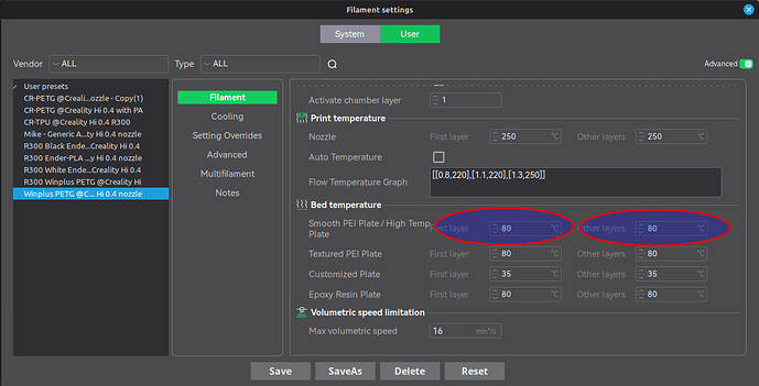

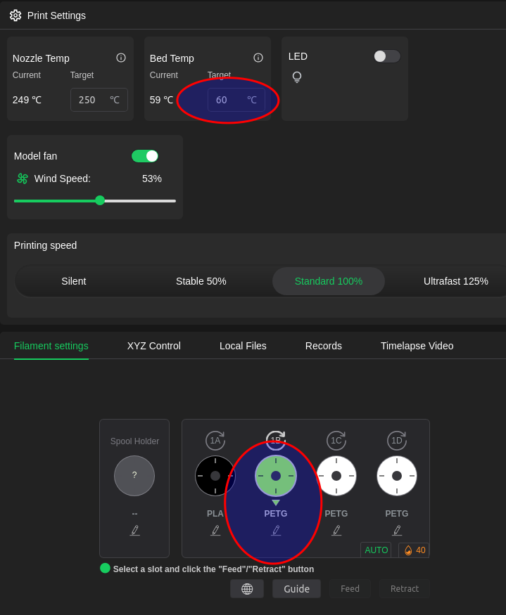

PETG bed temperature not being lifted to the setting of 80 degrees. Mine is stuck at 60 degrees during print.

What if you set the bed temperature of 80 on the display? Does it then reach 80 or does it also stop on 60? If the bed now reaches the 80, there is something in CP that is preventing this…
If I set it manually to 80 degrees in CP once the print starts it gets there, yes, although, I shouldn’t need to baby sit my printer every time it needs to print. I thought we have matured enough at this stage…..![]()
On another note, I tried another print using the standard PETG profile and it used the correct 80 deg bed temperature, so it may be that it doesn’t like the user presets. I renamed an existing PETG profile and only added a price per roll, so it should have kept the same bed temp, but it used PLA bed temps instead…..??
…so some settings are incorrect… you have to check them… else remove all presets and start from scratch!
