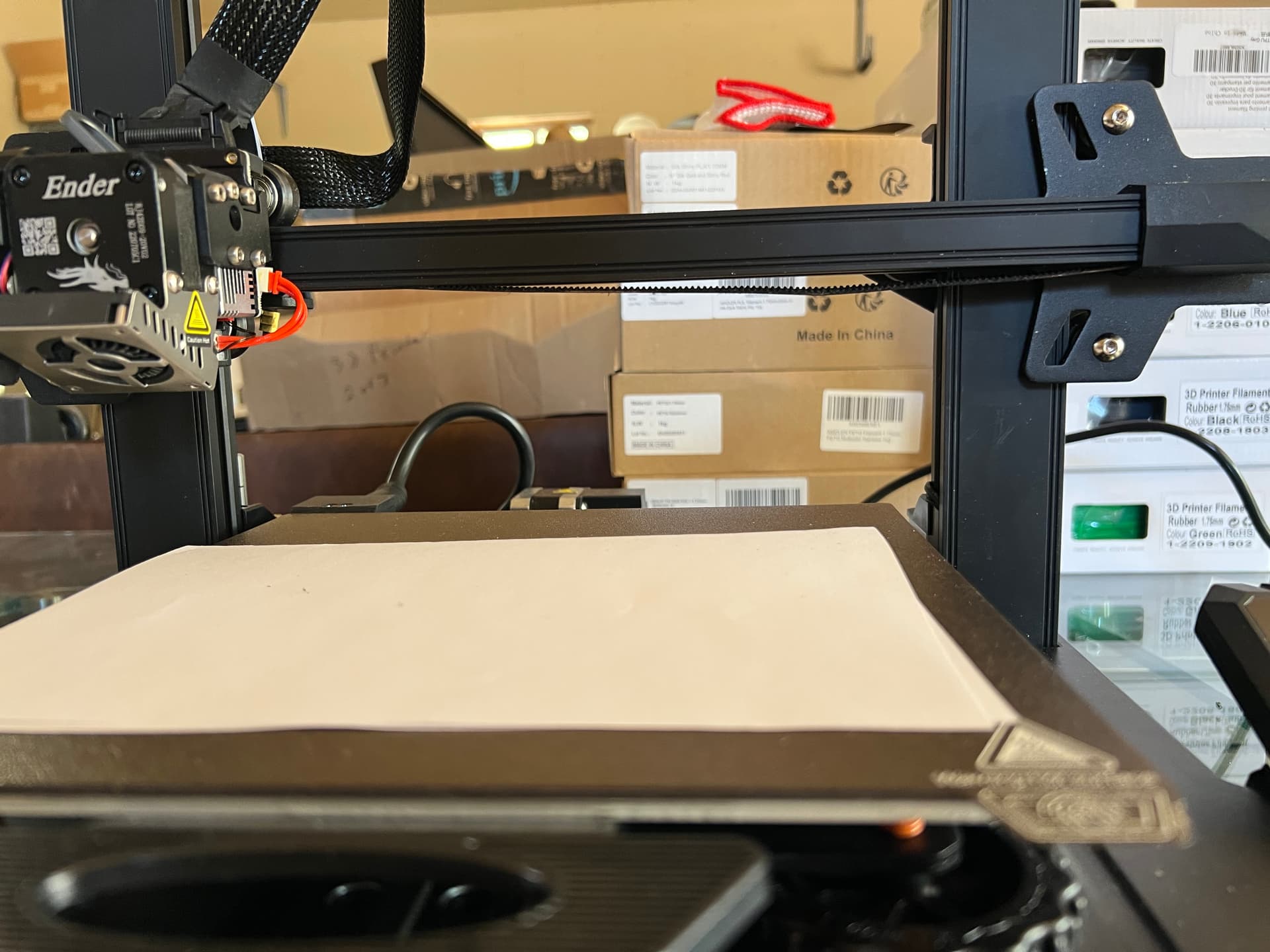

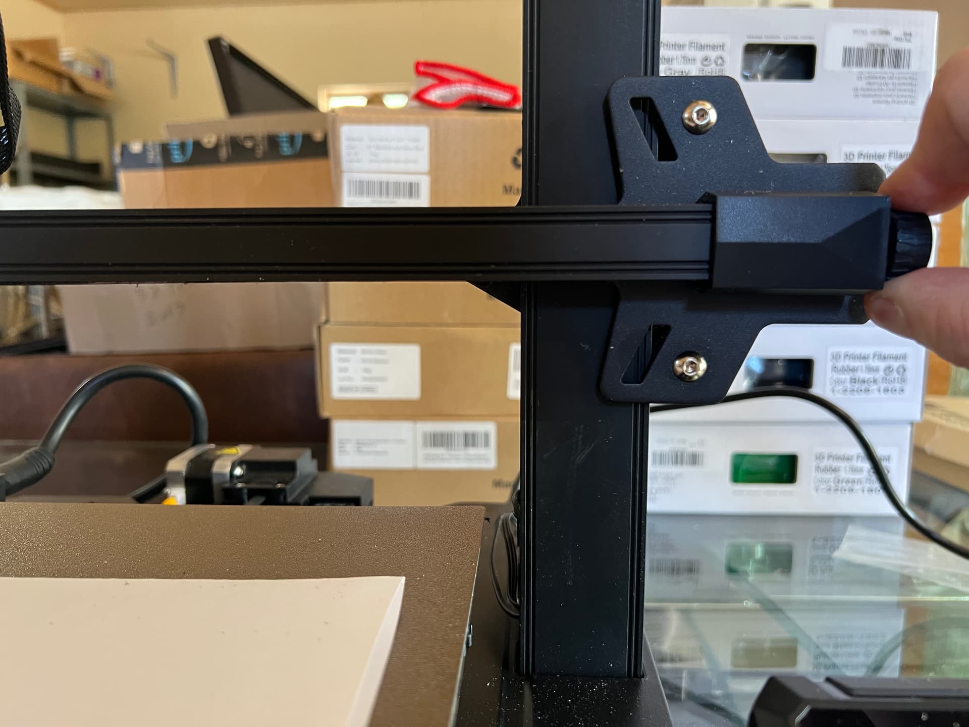

I am trying to level my ender S3, but the belt tension is off, or the belt is too loose. The only way it can get thru the leveling is if I pull on the tensioner screw just right so it cal slide back and forth. Is there further adjustment I can do on the belt to get it right?
Visually, the belt sags on the bottom, and the printer just clicks as it tries to move…
Tighten the belt-tensioner…
The belt still sags, and the tension is so tight that the printer head won’t move
How can the belt sag when the tension is so high you can’t mover the printerhead?
You are definitely doing some wrong… Post photo to show the “problem”…
This is with the tensioner as tight as it will go. Second pic is with me pulling on the tensioner knob to tighten the belt

So check the if these clamps are still in position…
I have an Ender3. Is there a pic anywhere of what I am looking for?
I found it, and that seemed to fix the problem. Thank you!
I take back what I just posted. I found the belt clamps but I cannot get them to stay in place, so they just slide back to where they were and the issue repeats itself. Is there a clamp or something that comes with the printer that will hold the belt in place once I get it to the right spot?
Then they didn’t crimp the clamps the right way. Move the belt clamp(s) to the right position and use some force with pliers to “close” the clamps a little more so they don’t “slip" over the belt anymore…
