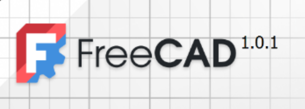

I’m using 1.0.1.
I should also note that I have been following FreeCAD for about 20 years, hoping it would eventually move beyond the science-project phase and become more polished. There was a glimmer of hope when Ondsel offered a more curated version in 2024, but that ended when they ran out of money. It is too bad, because they were on the right track. If you followed FreeCAD during that period, much of the professionalism Ondsel tried to bring to the project eventually found its way into FreeCAD itself. After roughly 20 years of pre-1.0 development, FreeCAD finally received the 1.0 release that was long overdue.
