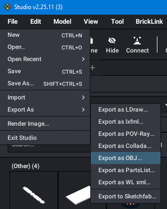

Thank you everyone! Yeah I have built a lot with studio, @jimandyen how do you export a piece from there? And is it possible to export into a format I can edit (using Fusion 360)? I’m looking to print some of my own designs but it would be helpful to use some real pieces as a base. I will experiment using PLA and PETG. It will be interesting!
Thanks!
In studio you can export pieces in the .obj format. In the file menu go to export and choose .obj and save. Remember where you save or make a special folder for these files. Take the file you just saved and drag and drop into Creality Print or select Creality Print / File / import. I still use Creality Print ver 3420 and haven’t tested this in the newest version which might not work.. Let us know if this works for what you are doing… :+1:
I wish I was more familiar with Fusion so I can’t tell you what’s compatible with it.. :frowning:
