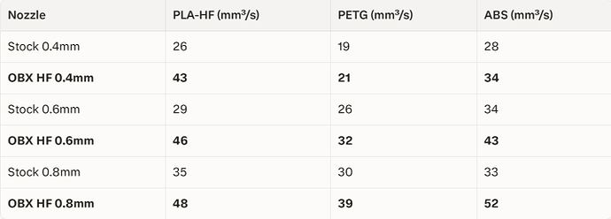

Hi everyone,
I’m using a Creality K2 Pro with the E3D ObXidian High Flow nozzle kit, and I’m trying to optimize my slicer settings for the best print quality and speed.
I would like to know what settings people are using successfully with this setup, especially for:
  • Nozzle temperature
  • Volumetric flow rate / max flow
  • Print speed
  • Retraction settings
  • Pressure advance / linear advance
  • Cooling settings
  • Layer height recommendations
  • Wall speed and infill speed
  • Profiles for PLA, PETG, ASA or PA-CF
I’m mainly looking for a good balance between:
  • high quality
  • reliability
  • and taking advantage of the higher flow capability of the ObXidian nozzle.
If anyone has optimized profiles or advice specifically for the K2 Pro + E3D ObXidian combination, I’d really appreciate it.

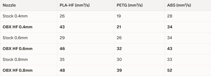

Support gave me the answer
Print setting
  • Layer Height: 0.24mm (0.6mm nozzle optimal)
  • Line Width: 0.65mm
  • Wall Loops: 3-4
  • Top/Bottom Layers: 6
  • Infill: 15-25% Gyroid (GyroFlow)
  • Seam: Random
Speed Settings
  • Outer Wall: 150-200 mm/s
  • Inner Wall: 250-350 mm/s
  • Top Surface: 150 mm/s
  • Infill: 400-500 mm/s (PLA-HF)
  • Travel: 500+ mm/s
  • Acceleration: 20,000 mm/s²
