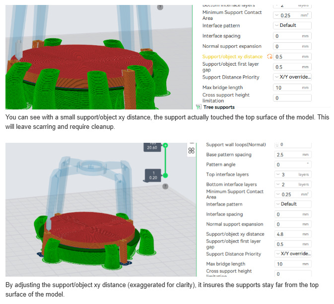

Support/Object First Layer Gap amd Support/Object XY Distance
Set both to: 1mm or more
These two are the ones that can save you from a lot of ugly support damage. Because if the supports are touching the actual model in places they shouldn’t, they are going to leave marks, fuse, or just make your life difficult later. And they can really only be checked after slicing.
XY distance controls the horizontal gap between the supports and your model. First layer gap controls how much space is between your model and where the supports start. These two settings help control how your supports are formed and are especially important for tree supports that can twist into areas you do not want them. I usually start a 1mm and have gone as much as 8mm for some models.
CAREFULLY watch the preview after you slice the file.
If any support is touching the model where it shouldn’t, increase the distance until it doesn’t. You want to make sure the supports are close enough to support the print, but not touching side walls or details. Tree supports especially have a habit of overlapping something beneath them as they build up and if it touches your model surface, it will scar it. You can often remove it with a light sanding, but I hate doing post-processing when I don’t have to. Pay attention to this spacing and you will end up with a cleaner model surface.
My Biggest Tip: Check the PREVIEW
This is the part people skip, and it’s usually where the trouble starts. You can copy someone’s settings exactly and still get bad results if your specific model needs something slightly different.
So when you slice your print, look at the preview. Use the layer slider on the right to step thru your layers and pay attention to:
  • Are the supports actually under the areas that need help? Make sure NOTHING is starting to print in thin air! While auto support generation usually works, the slicer does not always catch a small overhang or area that should be supported or tries to support tiny overhangs when it doesn’t need to. This is why support blockers and enforcers exist as well as having the ability to manually paint on supports.
  • Are they touching side walls or details of your model? You don’t want a nasty scar on a print that could have been avoided – especially on those extra long prints!
  • Are there too many branches cluttering the print? Auto supports are not always perfect and you might find it generates 20 tiny branches when it only maybe needs 5. Adjusting support density, tree support branch distance, or tree support branch angle can fix this.
  • Is there a better orientation you can use? Sometimes I find rotating a part a bit can cause better supports, or even eliminate the need for some of them. While generally you will want to put your largest, flattest surface against the build plate, tipping it up, rotating it back, or standing it up might give a better result.
The preview will tell on your settings immediately if something looks off, so use it! I’ve been guilty of this too many times myself as getting the print started can be much more exciting than looking at the preview. But taking that extra minute especially if it is something you haven’t printed before, can save you a lot of grief.
