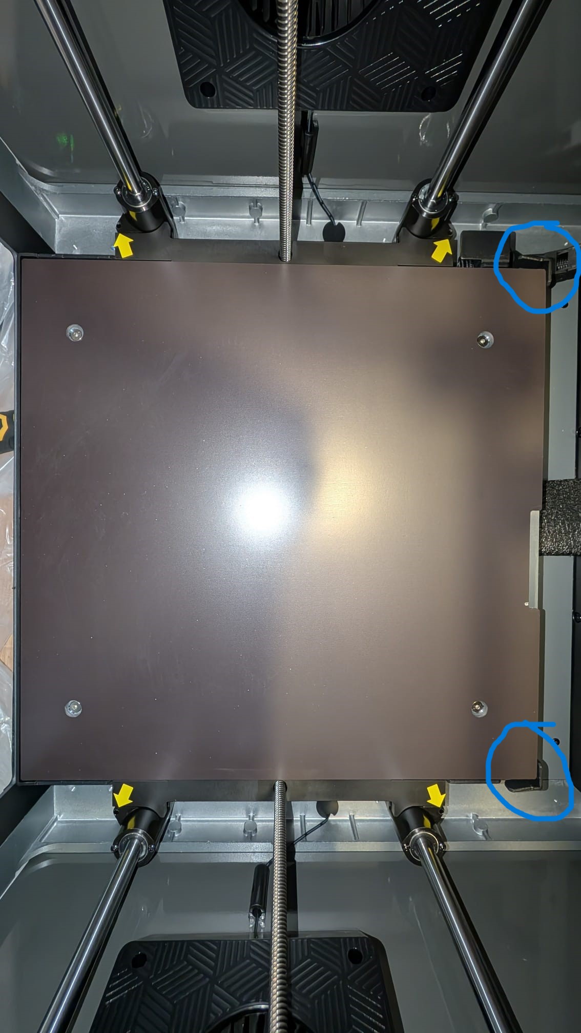

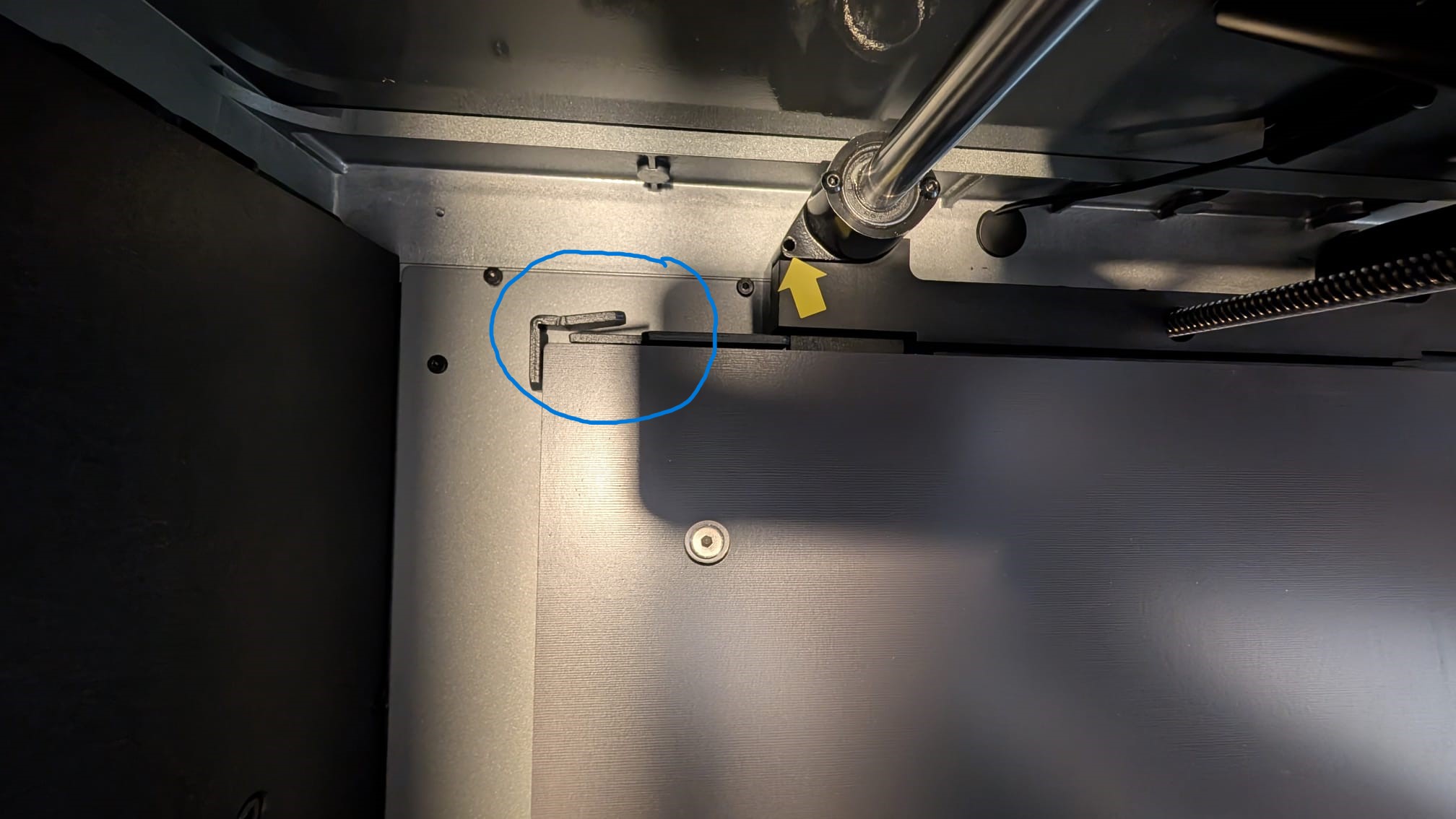

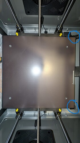

My K2 Plus was delivered today. I followed the steps to unbox the new Machine until i reached the part where the hotbed screws have to removed. I noticed the metal plate connected along the Hot Bed top left and top right edges were bent. I messaged the Creality Service and they told me that Technical Team will contact me. And they gave me a Ticket number.
Has anyone else had the a similar issue while unboxing?
Am i over-reacting? And it does NOT play a major role in the functioning of the machine so simply bend it back?

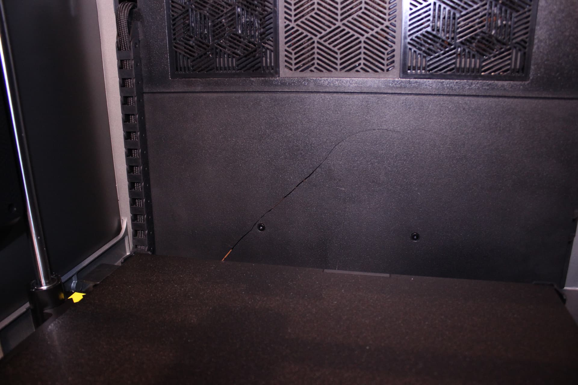

Also i am not able to remove the FOAM below the Hot Bed as i cant move it yet( suggested by the Service Team not to switch ON the machine ). The unboxing video/images dont show any information about the foam below the hot bed. It seems the Hot bed has been pushed down hard.

Those look like my K2+.

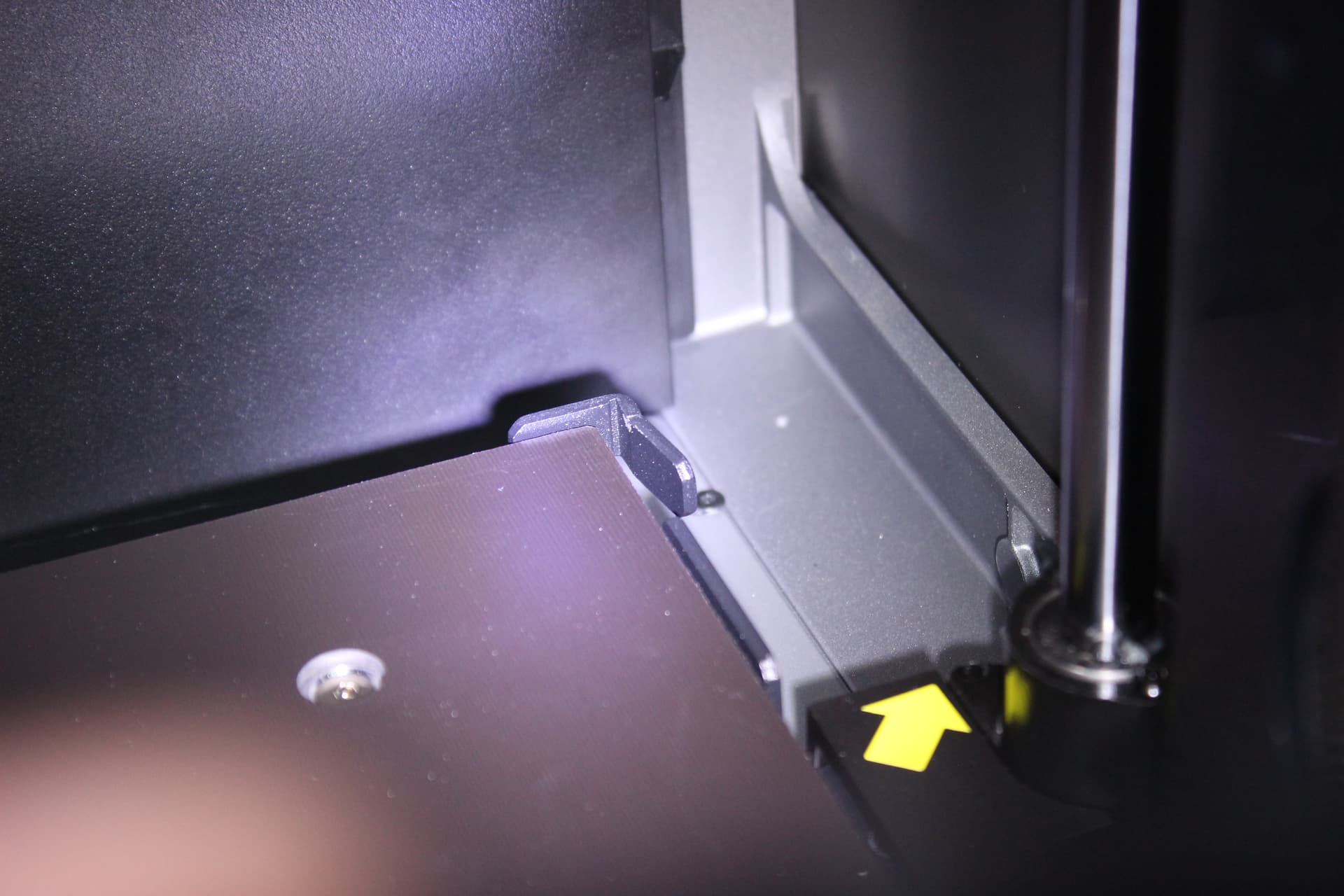

I believe that they are bent that way so it helps you to center your print plate when you slide it back on.
Turn the Z-axis rod(s) manualy to raise the bed a lite so you can get the foam out…
Yes, what @doxidad said is basically correct in that this is a design feature. But I would not use the term “bent” as it implies damage. These guides are not bent or damaged. They are intentionally angled to act as lead-ins, helping center the build plate as it slides into position and ensuring that it seats properly against the rear stops.

私のK2Proと比較するとL字部品は同じ角度で開いていない。
共通部品と思いますが、同じ角度でプレス曲げだと思いますがなぜ角度が違うのか分かりません。
品質の安定性が感じられない。
ビルドプレートは水平には引き出さない。マグネットなので入れにくい、ベッドに傷をつける。
プリントが完成したらプレートの手前を持ち上げて、手をプレートの下に置けばプリントは安定します。
セットするときは、奥に当ててからプレートを下におろす。
だから、私は、開く必要はないと思います。
分かりやすい様に角度を大きくつけてます。
