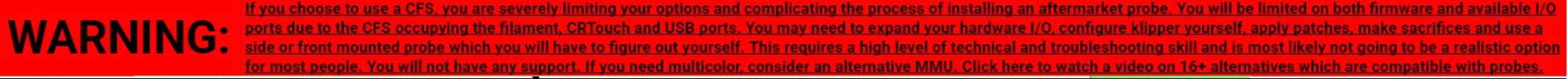

I found out Simple AF is not compatible with CFS, so I didn’t install.
