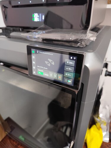

[BUG] Firmware v1.1.6.1 overrides PETG temperature to 250°C and fails to detect textured PEI build plate
After the automatic firmware update from:
CR0CN240110C10_R_202605081127_ota_img_V1.1.5.5.img
to:
CR0CN240110C10_R_202606230954_ota_img_V1.1.6.1.img
my printer started behaving incorrectly.

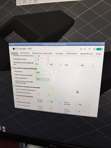

For some unknown reason, the printer now starts printing PETG at 250°C, even though the G-code was generated with a nozzle temperature of 240°C.
I have already checked the OrcaSlicer settings and reviewed the G-code files. The temperature in the G-code is correct, so this appears to be a printer firmware bug.
Another issue that started after the update is that, when I send files to print, the printer reports an error saying that it cannot detect my textured build plate.
For reference, my original textured plate was replaced with a gold PEI build plate. However, the temperature bug is the most serious problem, because the printer is overriding the correct G-code temperature and printing PETG 10°C hotter than expected.
I am seriously considering downgrading the firmware because of this issue.
