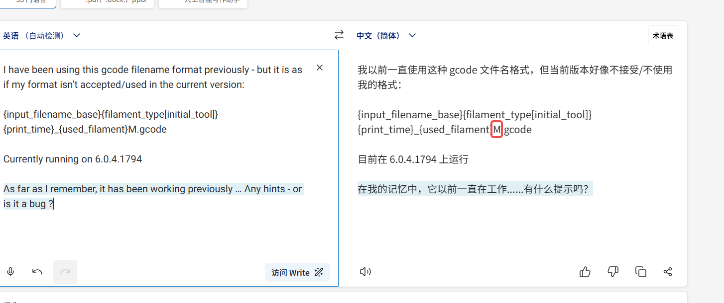

I have been using this gcode filename format previously - but it is as if my format isn’t accepted/used in the current version:
{input_filename_base}{filament_type[initial_tool]} {print_time}_{used_filament}M.gcode
Currently running on 6.0.4.1794
As far as I remember, it has been working previously … Any hints - or is it a bug ?

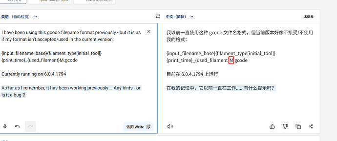

I find there is something wrong with the format you have written. You have an extra letter M

The letter M is after the variable - to indicate meter.
6.0.4.1795 has solved the issue.
