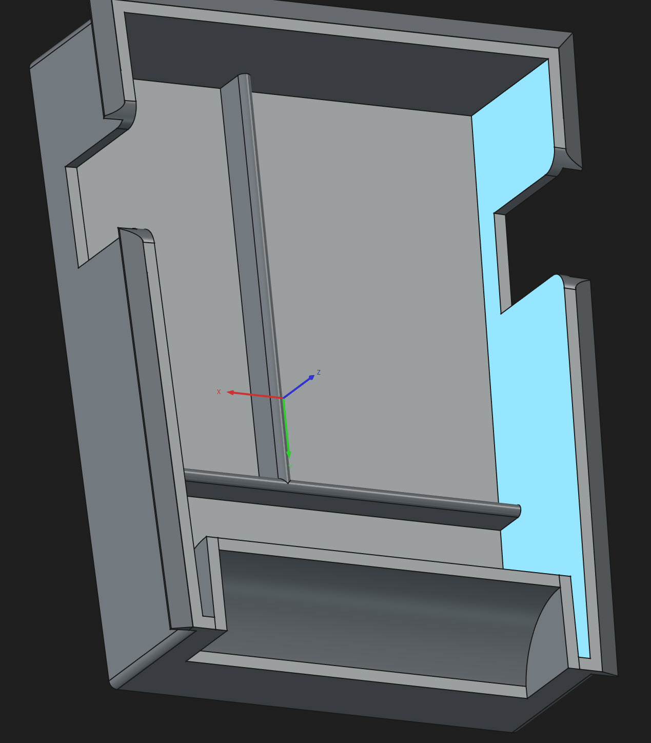

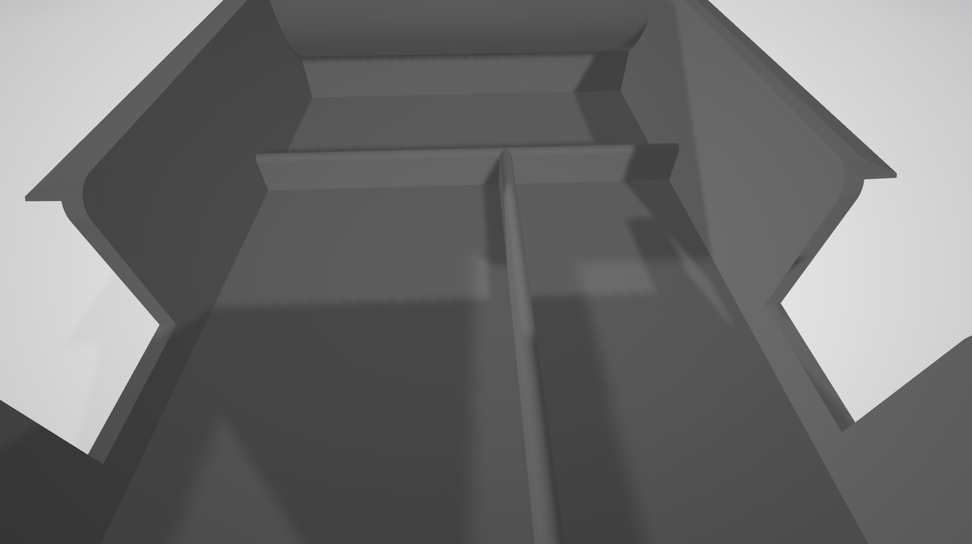

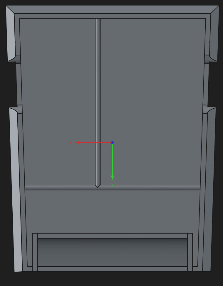

This is the model in FreeCAD:
Top view:
Cut-away showing the side cutouts and how the wall has no issues vertically:
Angled view:

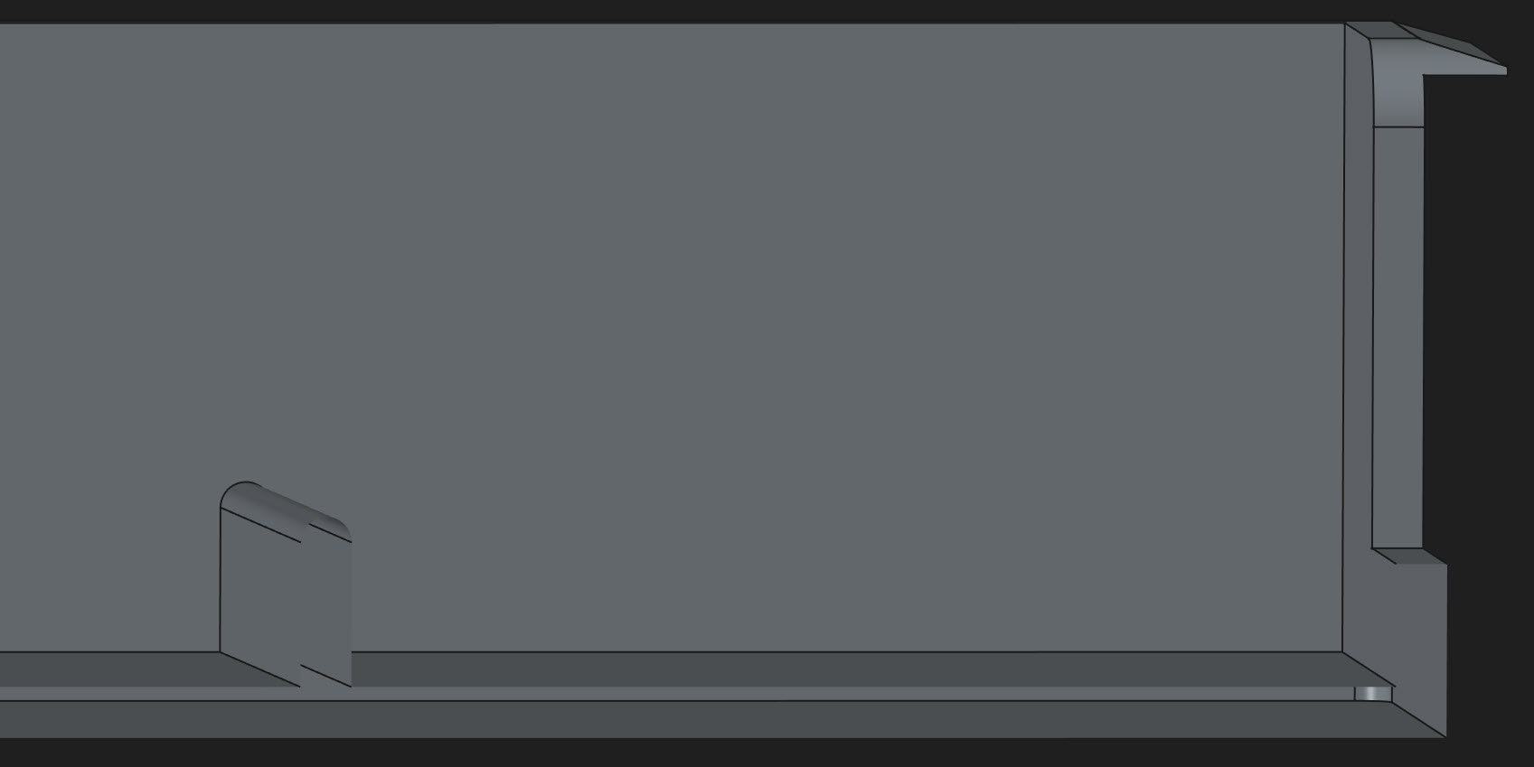

The STL as viewed in FreeCAD, with a cut-away view:

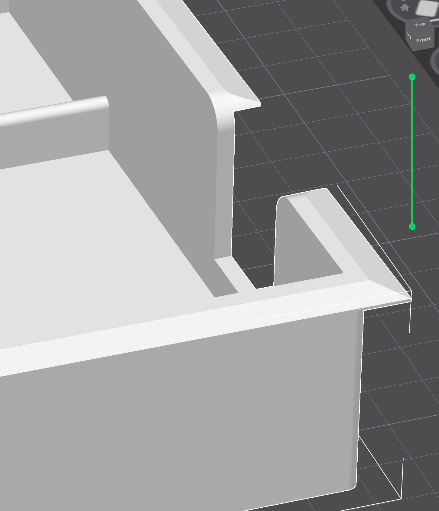

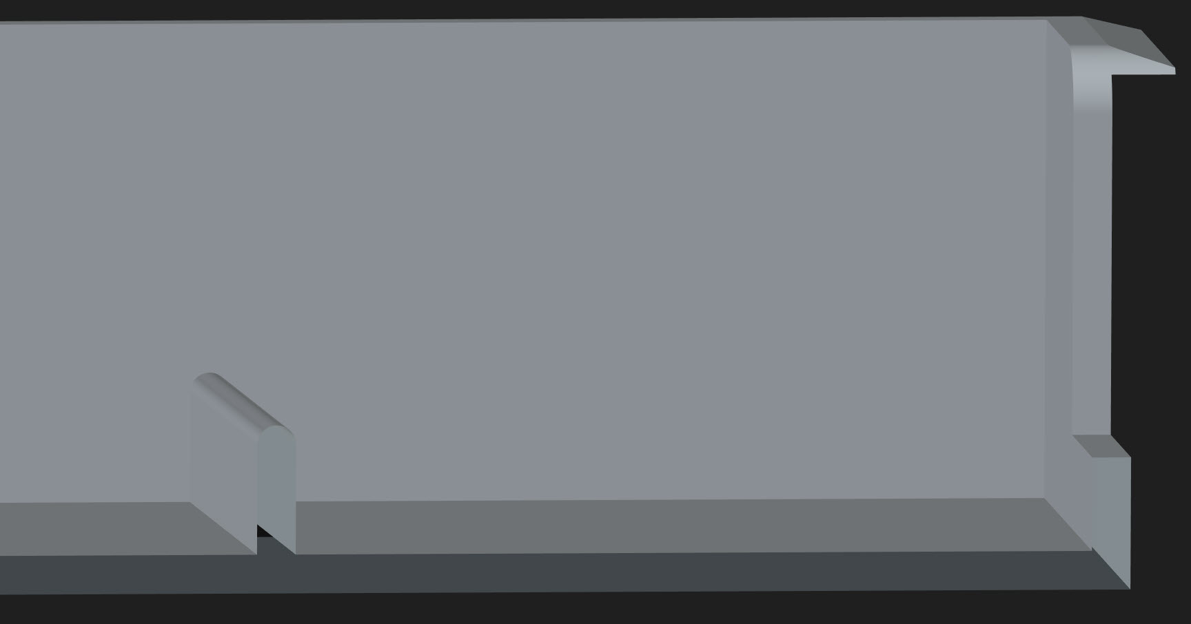

The STL as viewed in Windows 3D Viewer:
The RAW STL loaded into CP 7.0:

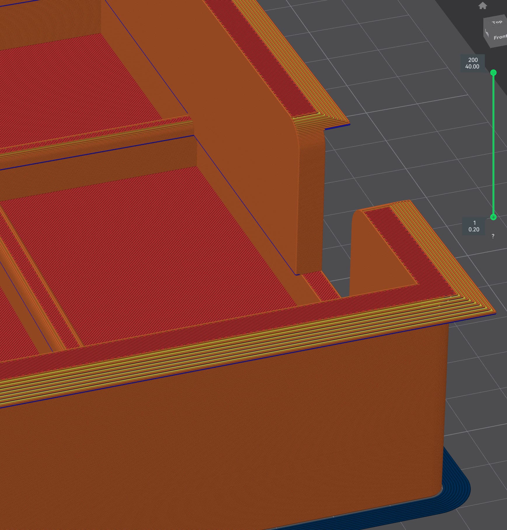

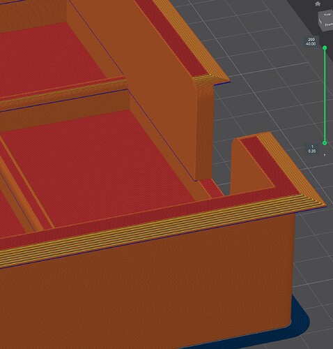

The STL rendered in CP 7.0 (notice the vertical wall is NOT straight and has a step in it?):

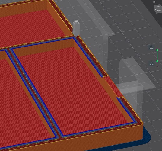

Layer by Layer view showing the step out in the wall:

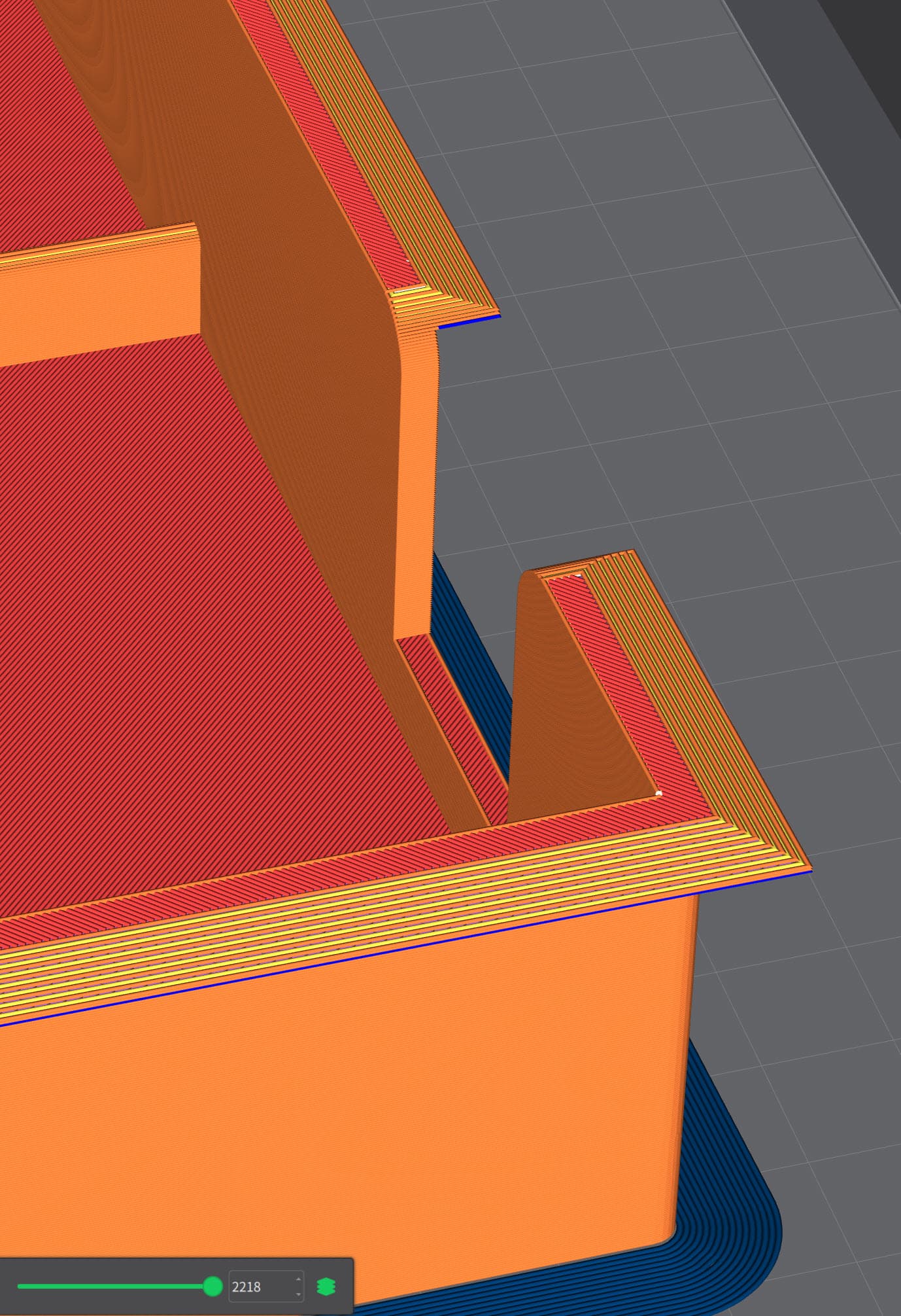

The same sliced file in CP 5.1- looks like it should with no problems in the wall:

That did not work, but what I did find was that if I changed the settings profile, the slicer worked. I narrowed the problem down to the setting Precision\X-Y Contour compensation which was set to 1.0041. I changed this to 0 and it fixed the slice.
I think there is a bug in CP because any value other than 0 causes PART of the model to scale out- not the whole model.
