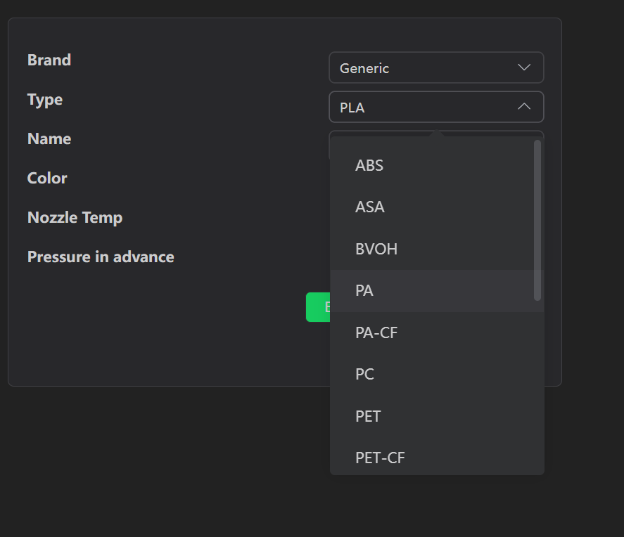

So I updated my Creality K1 Max with the new Update this last Tuesday 11/4/2025. And developers wonder why we hate updates? Well, that was the last time I have sent anything to my printer from my creality slicer. Ever since then, it states simply:
“The machine consumables do not match the printed file. Please check and restart printing”
I would love to know what that means, as I am set to print Flash Forge PLA, which I made sure to setup with the parameters that I feel would do best on the current print. I have reset the printer 5 times now, but it doesn’t seem to do much.
I was getting this error too after the update. If you go to the Device section in Creality Print, in the lower right you can change the type of filament that it thinks the spool holder has loaded to match what you sliced your object to print with, and then you can send normally. I think there should be a way to disable this warning. It just seems silly to have to set the type of filament you are using in two different places.

You can simply solve the problem by doing this:
  • Open Creality Print
  • Go to DEVICE-tab
  • Click on DETAILS-button (on the right side of the screen you will see FILAMENTS)
  • Click on the pencil-icon beneath the Spool Holder icon
  • Change the settings or at least the color
  • Press OK
From now on you can send and directly PRINT again like you did before…

Until now, I’ve always been printing with default material settings, but now I want to print with HIPS.
HIPS is not available in the printer material selection. But it is available as material profile in Creality Slicer. I loaded my HIPS on the spooler (disconnected the CFS), I selected ABS just as closest one, and in slicer of course HIPS and hitting the same material compatibility issue.
Is there any solution to this?
In the device tab, filament section edition is strictly limited to options available on the printer, so it’s not possible to select HIPS.
I can start the print from the printer after sending the file, but I notice that the printer ignores material edited in the slicer and uses the generic filament settings.
What is the slicer material edit option for, if it’s completely unusable? And how do I print with HIPS?
Read the thread! Problem with machine consumables do not match was solved with a firmware update some time ago…
What version of CP do you use? Did you update all printer-profiles? I can add HIPS to the list of materials and select it for printing!
