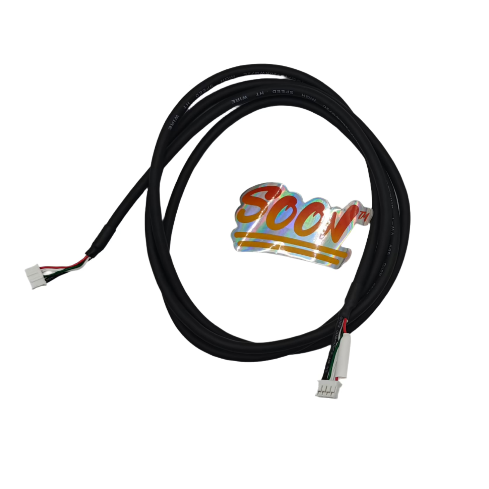

Looking for a replacement cable that goes from the LiDAR sensor to the main board. The short 4-pin black cable. Creality Support told me to purchase a new $75 sensor.

It’s actually a 5 pin connector. You might have to DIY one yourself.
I don’t have it front of me now but Search for JST MX 1.25MM Connectors and 26gauge wire. Some are kits and some are already put together. Always good to have spare parts anyways..
I’ve bought some 4 pin connectors for a runout sensor to make an extension and it worked ok…
What happened to yours…?
I had some problems with my hotend maintaining temps. One of the wires broke on the sensor cable from the frequent connect/disconnect that’s required. I’ve since removed the small piece of plastic from the faceplate that makes contact with the cable but have been down a printer for a few weeks as Creality does not have a direct replacement.
I’ve been searching for Micro JST SH 5-pin female to female.
Do you have any links to specific items I’d need? The nomenclatures of micro vs JST SH or JST MX seems a bit confusing. There’s also a pitch rating?

From what i see, its a 4 pins connector to the mainboard (may be can bus or usb), but there is also a 5 pin connector on the other side to the lidar and/or for a bl/crtouch

My local dealer have them, used those on my K1 for cartographer probe.
I think that would be part you were looking for right?
