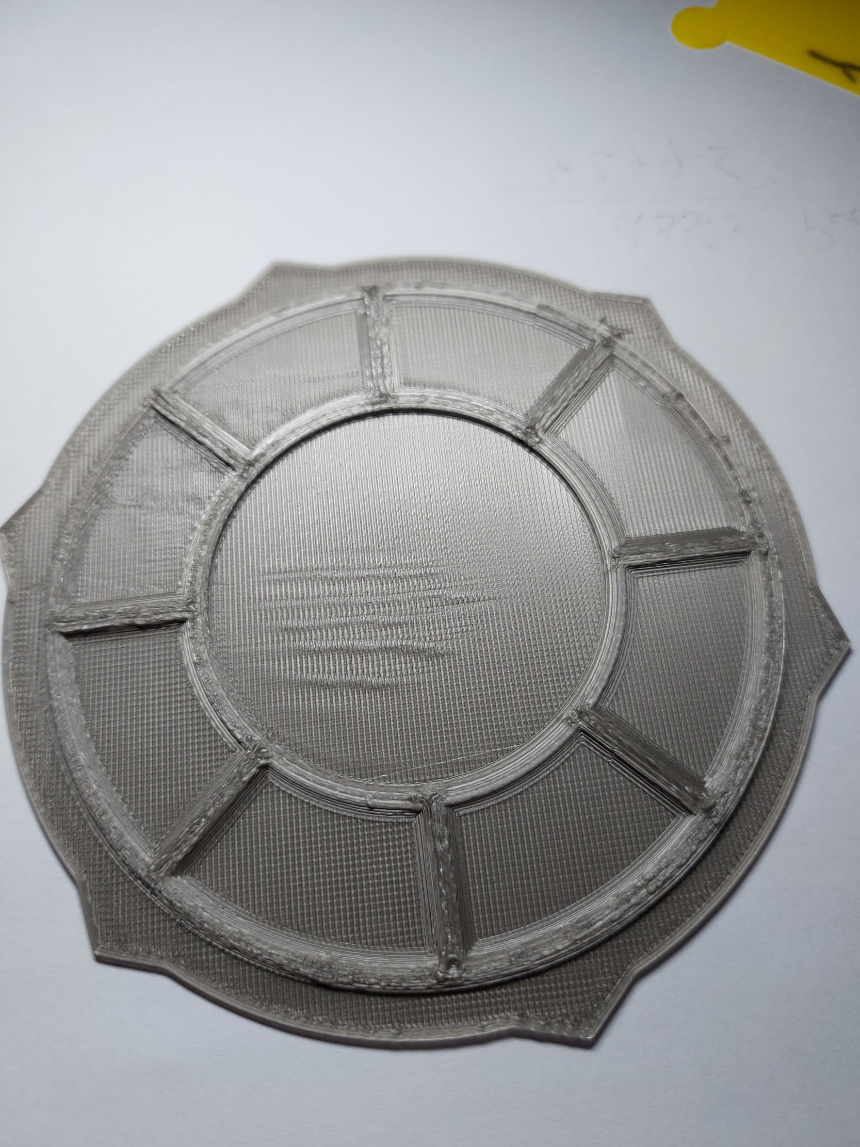

My S1 Pro is just refusing to calibrate. I have it hooked up to a Sonic Pad. I have had maybe one half dissent print from this printer, it’s my second S1 Pro so I have experienced calibrating these before and let’s say it can be challenging, but this is next level and doing my head in.
It started with Pic_1 a first layer that would make Mr Prusa weep and then it went to poop. From hunting through this forum I realised it was over extruding, which I had checked day 1, it’s the first calibration I do.

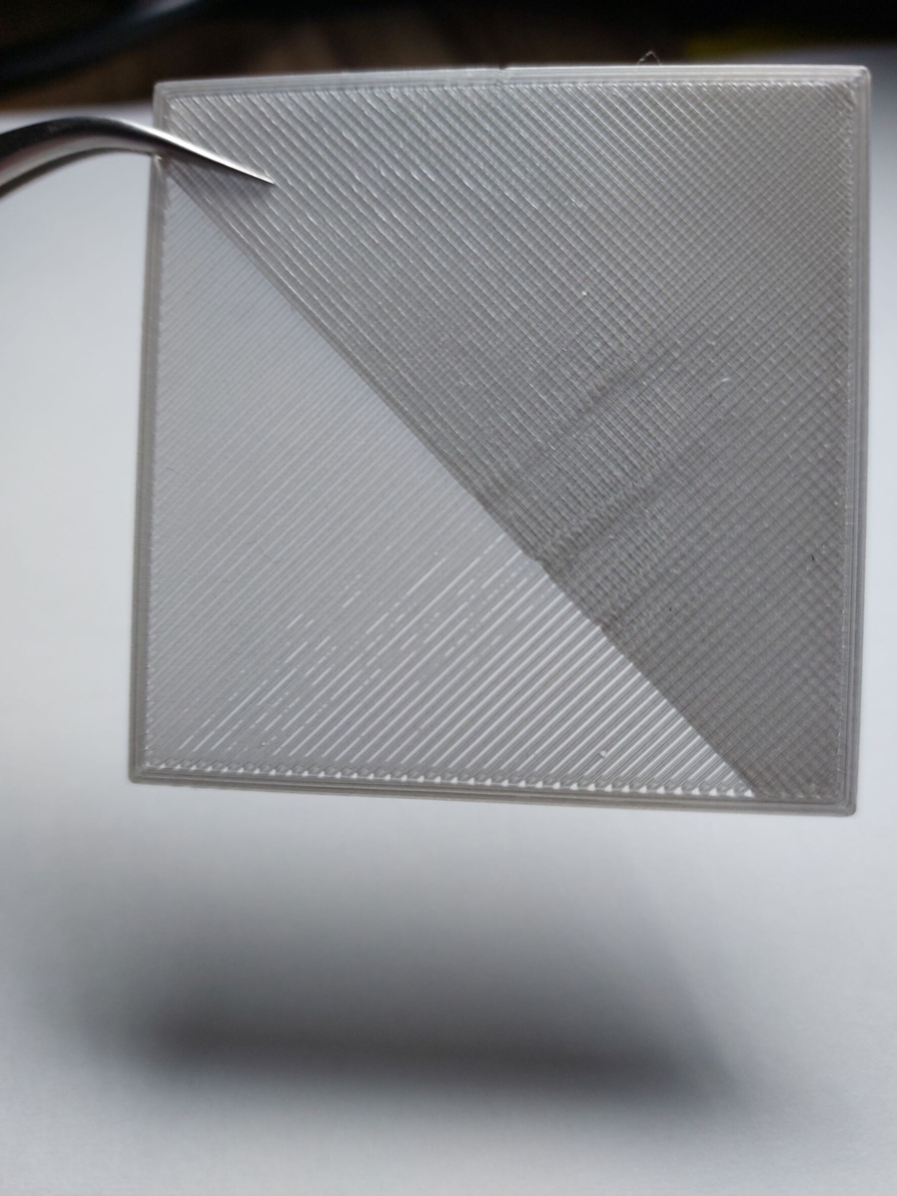

I let that one go for another couple of layers but stopped it after around 5 layers as this is what was coming out and the nozzle was dragging on the print, Pic_2
Less than optimal I’d suggest.

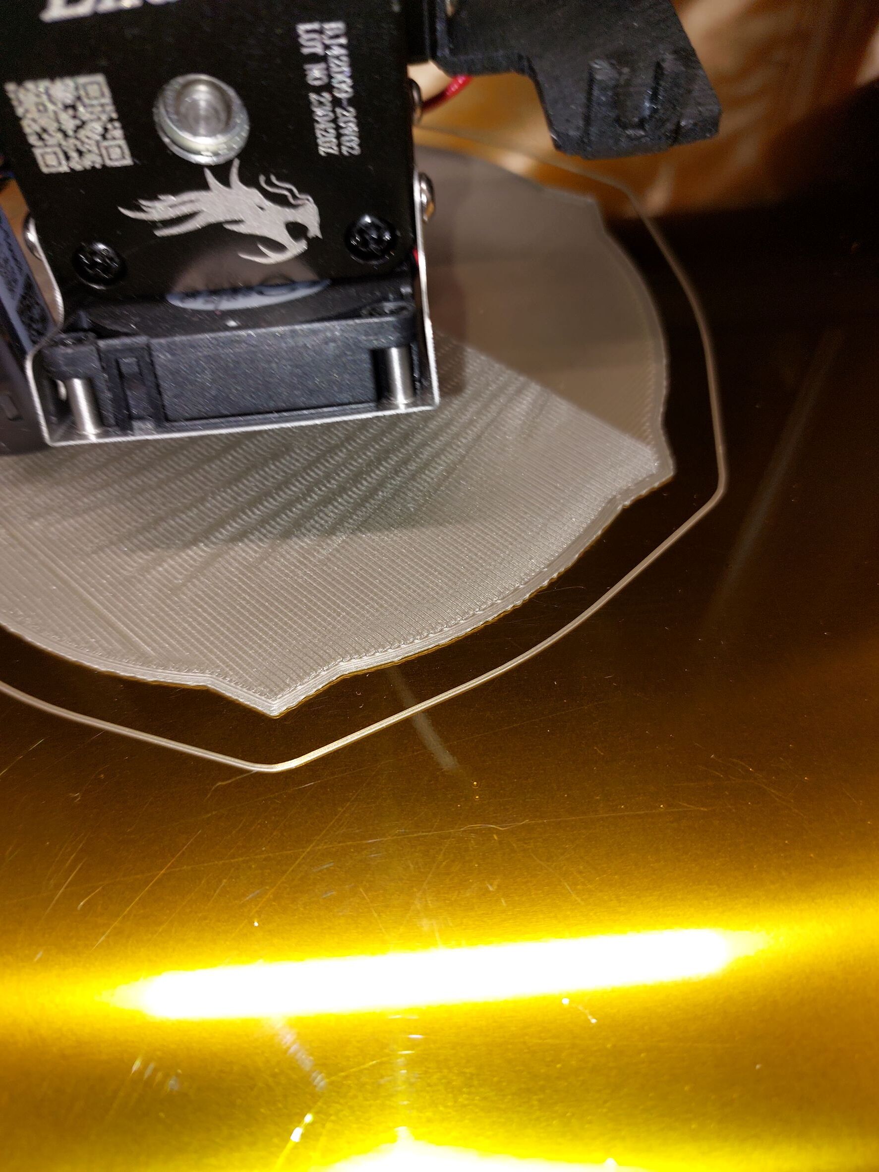

So after realising that it was probably over extruding I did the extruder calibration again, ejected 100mm absolutely bang on, so I designed a simply little print of two layers at 0.2mm and checked the results with a micrometer, Pic-3 is the result.
Shows the ripples and measured in at 0.50mm.

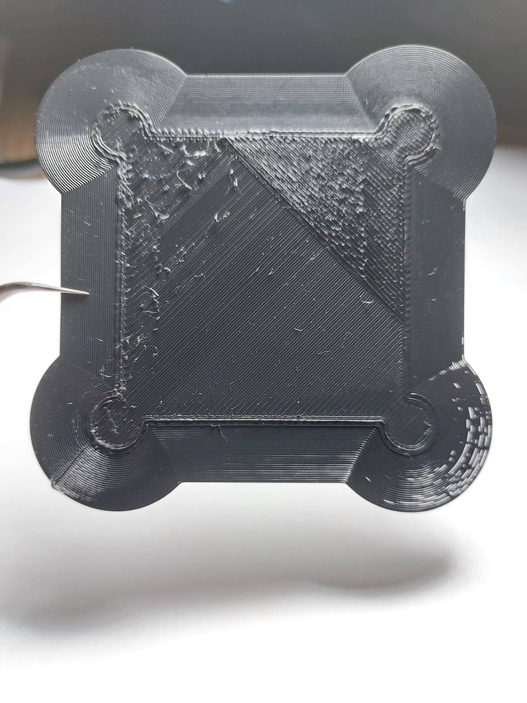

Then the ASA was loaded and due to the slight under extruding I thought I’d adjust the rotation steps a little. Pic-4 shows the results.

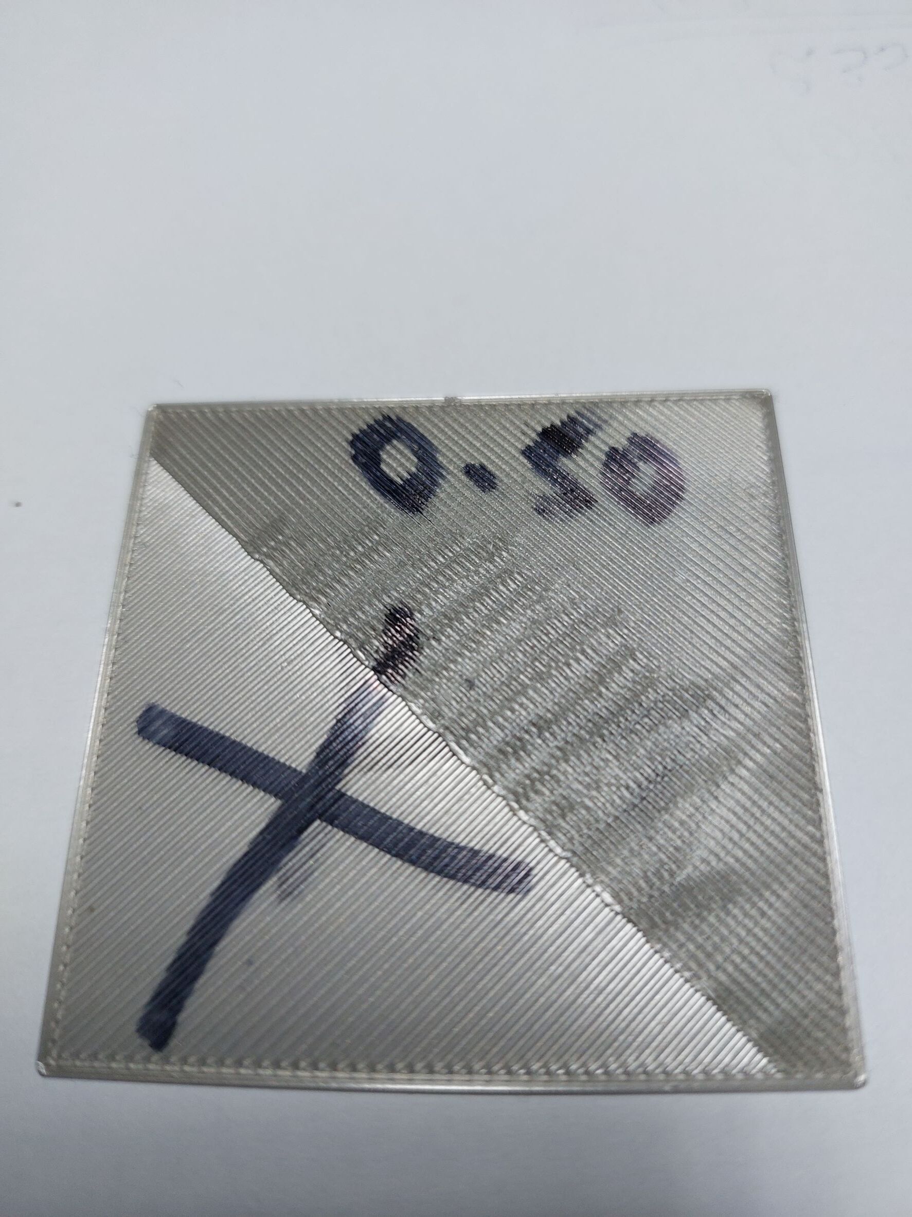

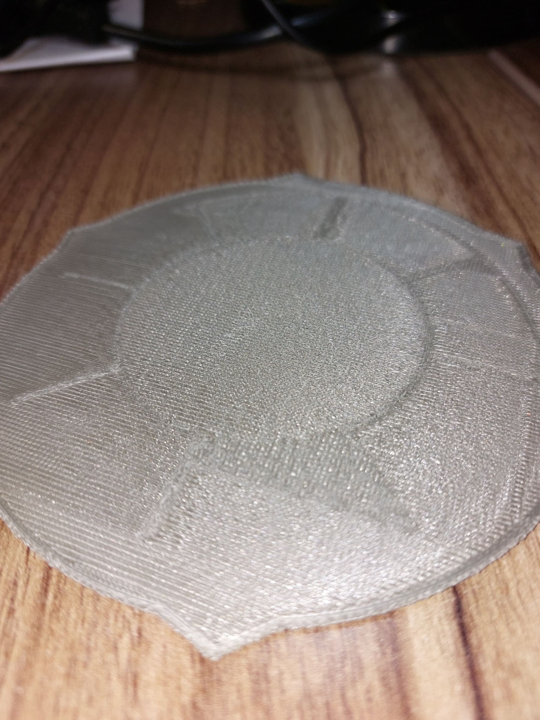

Now I think the blobbing is probably Hot end temp’ related (I’d like comment on that too). Athe time I thought it might have over extrusion so I dialed the rotation steps back and Pic-5 was the result. Same hotend temp as in Pic-4. And this is where my head started to spin! Under extruded badly bottom right corner and spot on, on the left side! Sooo back to the PLA, a little adjust on the rotation steps (.1) and this resulted, Pic-6.
A slight over extruding and tested with the micrometer shows that the first layer ranges from 0.19mm to 0.22mm with the top layer varying from 0.40mm to 0.45mm. I thought it didn’t look all that bad so I tried to print the item shown in Pic-1 and see how it went. Disaster pretty well sums it up. I had to stop the print at around 2.5mm as the nozzle was grinding on the surface. Pic-7 shows the result.

The ripples could indicate that your Z offset is a little too close to the bed try backing it off in 0.05mm increments (or 0.01 if it will go down that far which it should on the Sonic Pad, mine does)
Bonfireman, Thanks for your comment. That was my initial thought Z to low. I don’t normally dial in Z offset in the slicer, but I’ll try that. I’ll try anything at the moment.

Sooo, after you’ve spent a weekend and a half fiddling with software, firmware and every other type of ware. It’s probably worth checking that the printer is square. I was sure I’d checked all the axis because not one of the cam nuts were tight when I received this printer. Anyway, long story short, the X axis was out of whack and I’d say because I’d adjusted and re-adjusted the height of the bed so many times, I had virtually no pre-load on the bed screws springs. Damn thing was shacking pretty badly. Finally started to get some decent prints, still not perfect but pretty close.
I suppose I have learnt a lot about Klipper, the SonicPad and all the rest, but geez I felt like a right idiot when I noticed the real problem.
