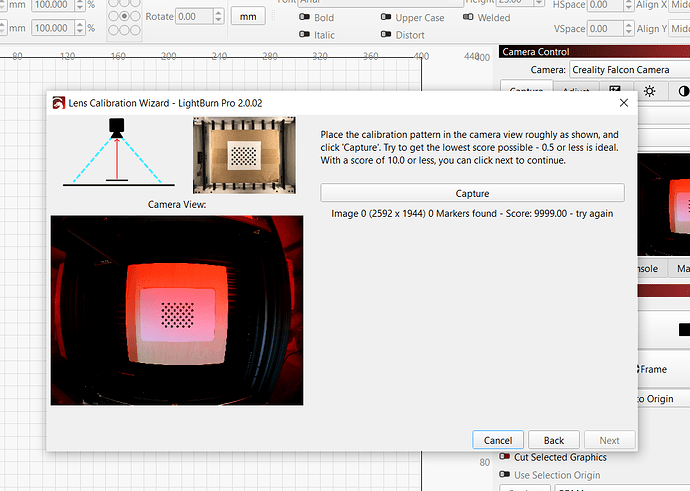

Camera Calibration Fail
When I capture the picture my score is 9999.0 There are no hints to tell me what I’m doing wrong so I don’t know how to attempt to fix this.

I personally always work from the 0,0 coordinates - never from placement on the surface.
The camera I use (Mintion) is really used as a server, where I can droop files and control my unit - never for placement. I gave up long ago with that as the calibration is never correct.
My laser and honeycom base are held in place on my work surface, so the 0,0 coordinate is always the same. Then, from LightBurn, I always desing based on that. I find it far more accurate this way.
This is what I started doing. Thank you.
