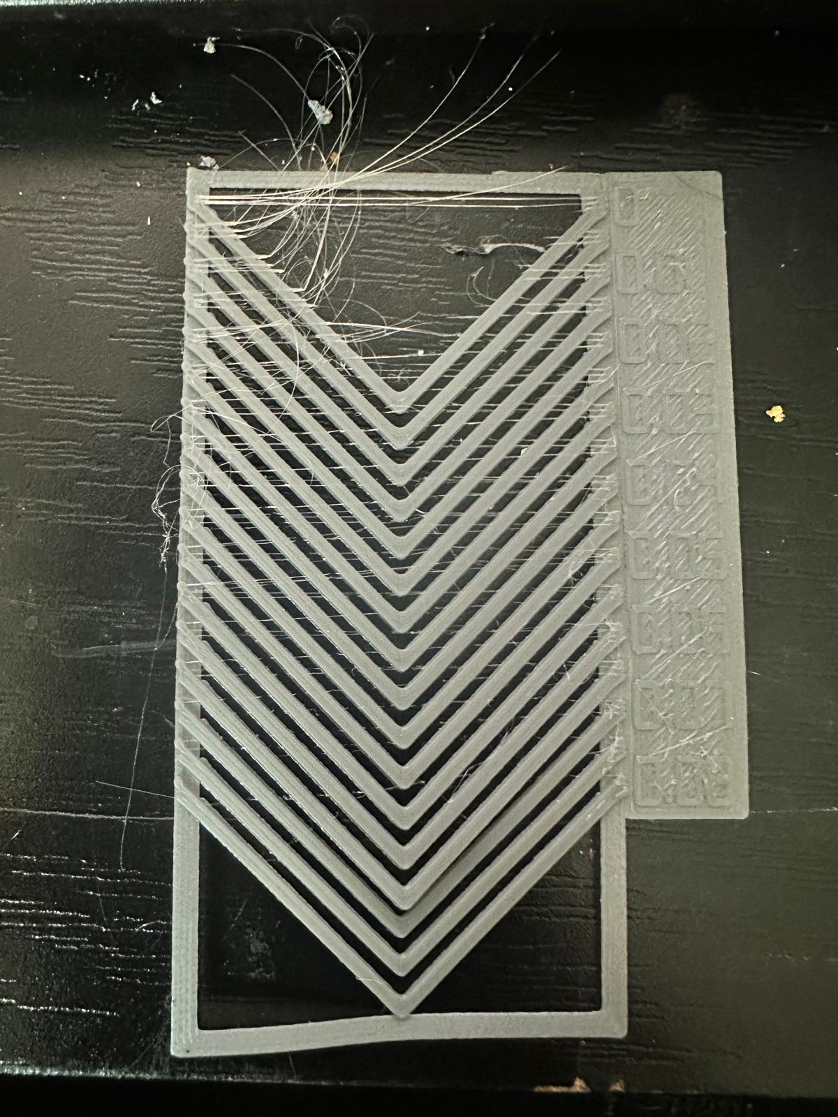

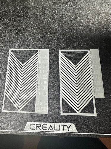

My eyes are messing with me and I’d love some more on these if anyone didn’t mind looking. On the left, that’s the default PA calibration from orca slicer. On the right, I used ellis’s gcode. Thanks a lot in advance again, this group is terrific and I appreciate the knowledge.
Thanks a lot, but I meant more which line/value on either PA pattern test ![]()
I would go with 0.05
It’s when you have the most balanced rounded corner. Not excessive nor thinner
Thank you. I was under the impression the corners had to be pointy, which is why I had an impossible time choosing as you can imagine!
It can never be pointy because of the nozzle pattern which is a circle. The goal is to have same width throughout the line so that the final shape won’t affect the dimensions of the object ![]()

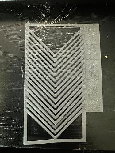

Sigh that makes so much sense. I took “sharpest corner” in a literal sense. I think I’ve been so hyperfocused on trying to get this thing to print well since the start that I’m just all sorts of clouded. Just to compare, I loaded in another filament brand, color and class I suppose (PLA vs hyper PLA). Would you say 0.06 is the mark here or am I off?

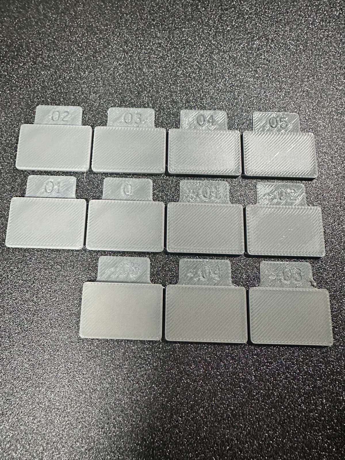

I’ll give that a shot. I just watched 3 PA tests with smaller increments completely fail. I’m watching a vanilla orca slicer flow rate calibration drag spaghetti around the bed. I’m really starting to lose hope here. I regret going into debt for this printer deeply at the moment.
Regarding PA, I would go with 0.03.
On another note, I see something in this photo that it is concerning: are there scratches on your bed surface, to the left of the print that I’m seeing or is it just my old aged eyes?

Thankfully that is my wooden desk and not my bed but thank you for even caring enough to point it out!

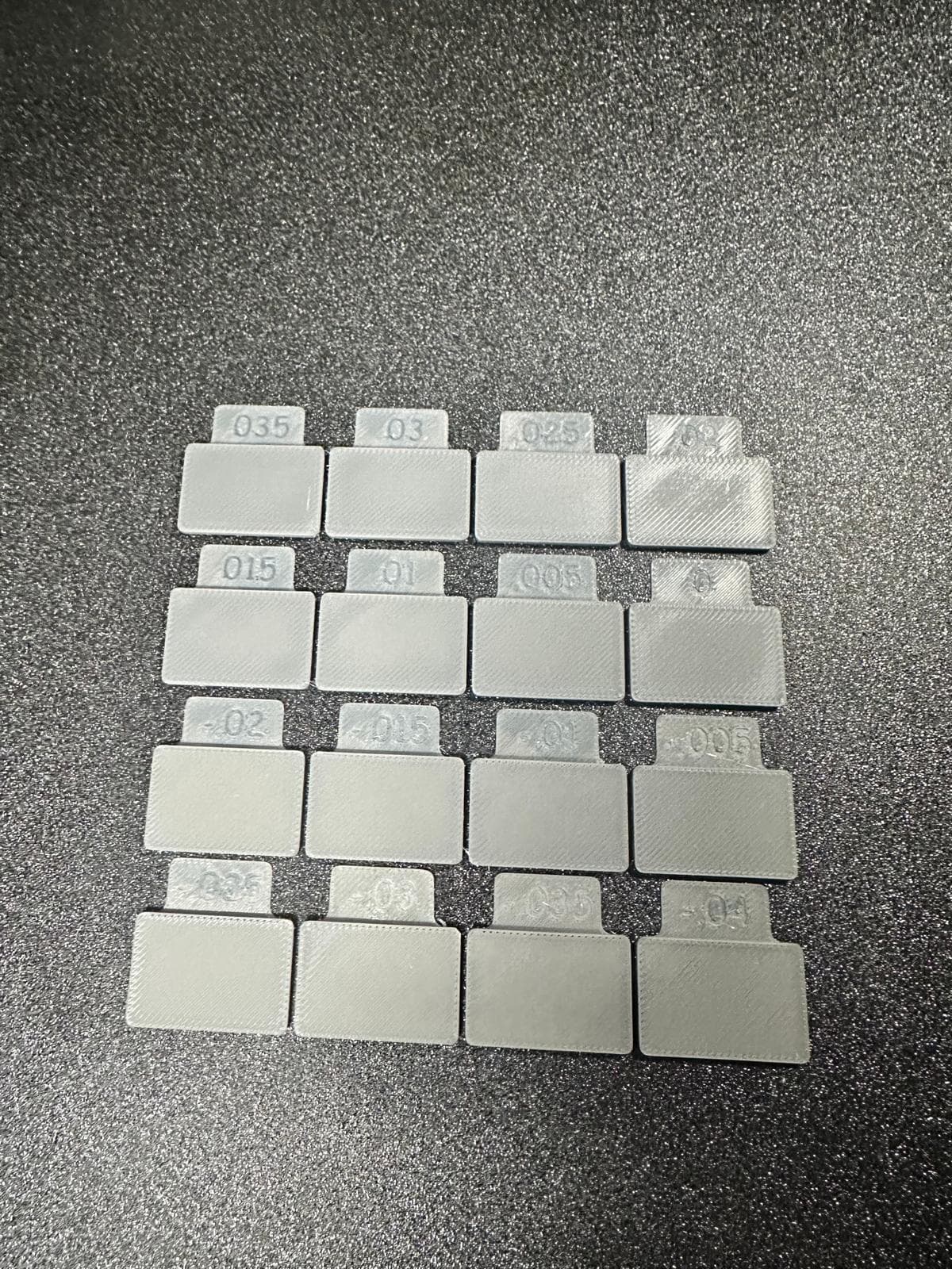

0.03 really wow alright. I just printed out these flow cubes after having set the PA to 0.05 and the results are significantly better. My plan was to read the job log and find out what auto-calibration of the PA was found to be and then set that for the filament if that’s a good approach.
