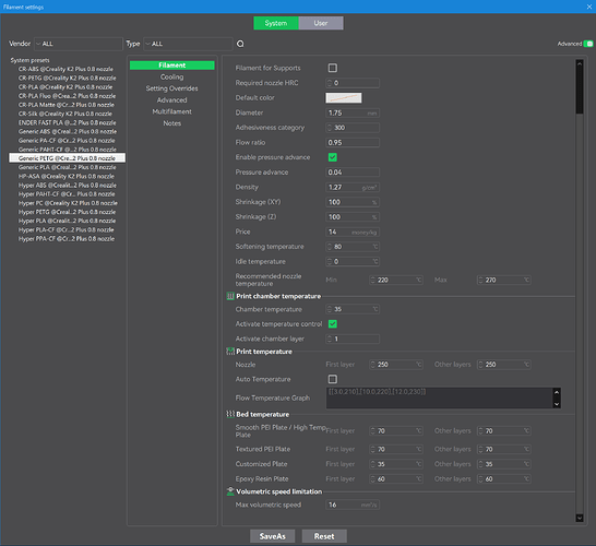

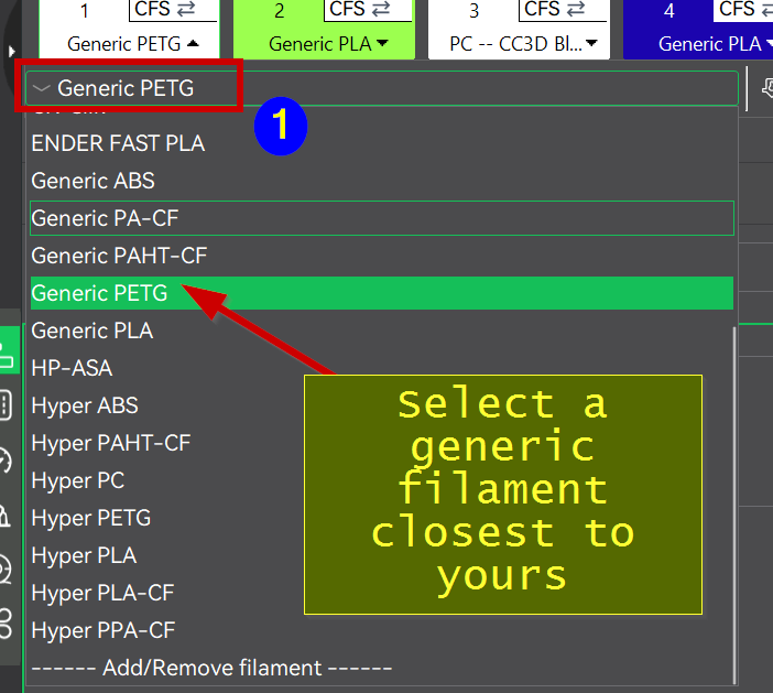

  1. Pick from the filament dropdown a filament profile that has a temp close to the filament your wanting to create a customer profile for. It really is not that important but it will save you typing and parameter changes:
  2. Click the Pencil icon to edit the profile:

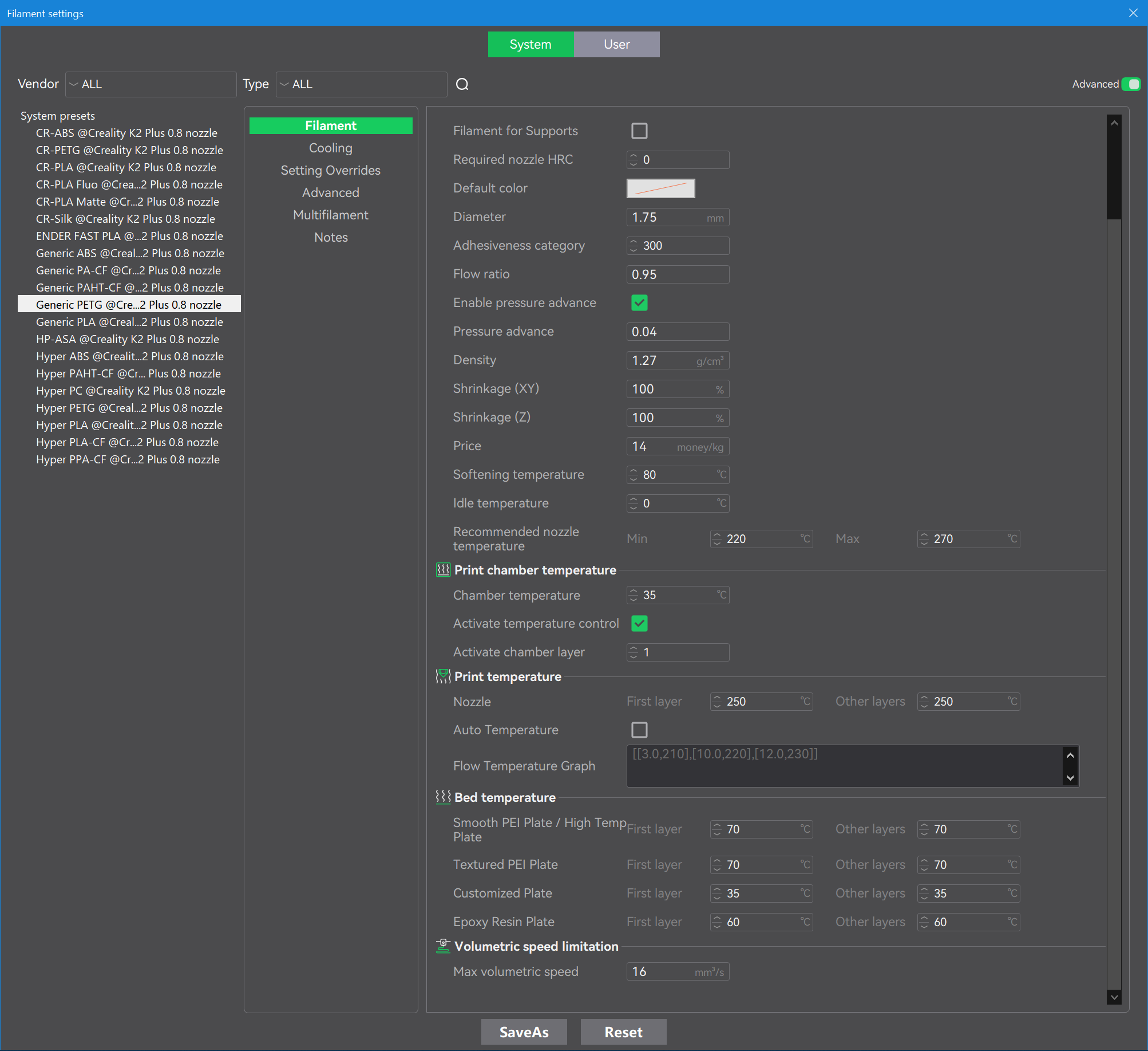

  3. That will open the profile page for that filament. It’s copy protected so you can’t break it. Make your edits based on the results from your calibration:
  4. Make your modifications.

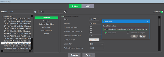

  5. Save it under a name you can recognize:

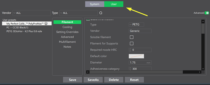

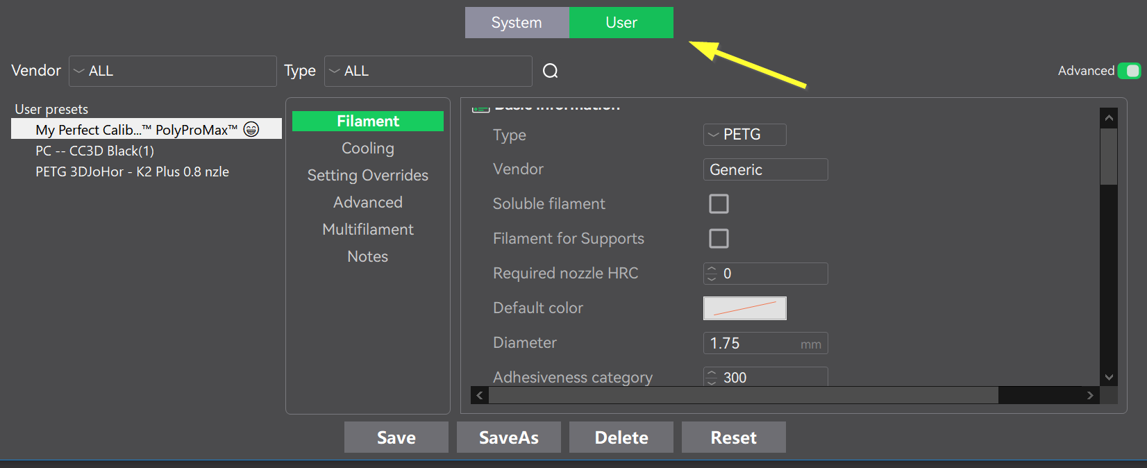

  6. See your filament under USER:

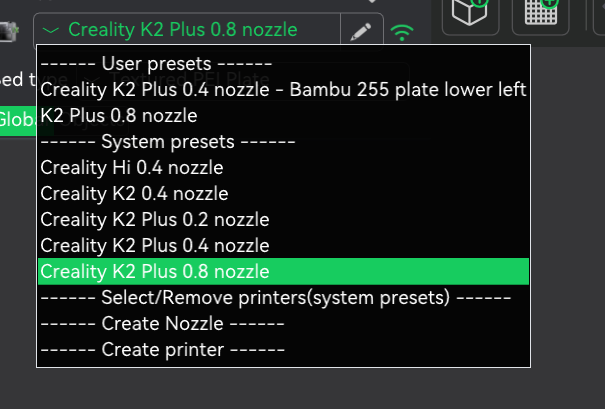

Caveats: The filament profile as just described will only be visible in that Printer preset.

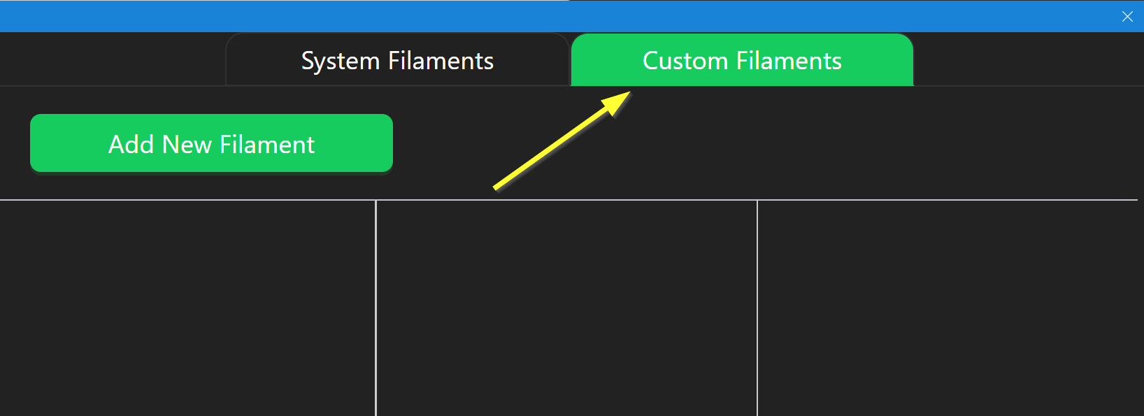

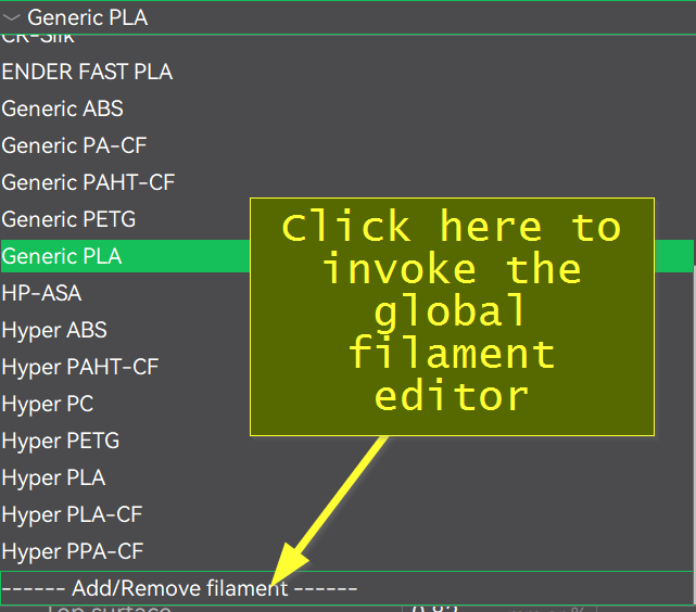

Alternate mode
Orca Slicer supports a custom global filament but as of v7.0 that feature is hopelessly broken in Creality Print. It works on the generic Orca Slicer but somehow Creality botched their version or at least I haven’t been able to get it to work. If you can get it to work, the advantage is that the custom profile becomes visible across all printer presets. While this may introduce other problems due to nozzle size and flow differences, I mention it in case you have the time and motivation to test it out for yourself. If you figure it out, please share it here.
