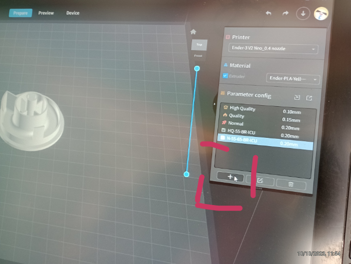

Can you name a profile
Is it possible to name a Profile? I create a new profile and it is always labeled PLA and balanced, speedy or Dynamic.

Try the + button at the bottom of the Parameter Config box in C-Print
Hello,
yes it is possible. You can define different kind of Profile.
Profile for the Quality.
In the right Window, select + (add)
Give a new name
You can copy from a other Profile, like High Quality; Quality or Normal
Than open the Edit window you can change parameter for Printing
Than save
You can also create same printer with different nozzle

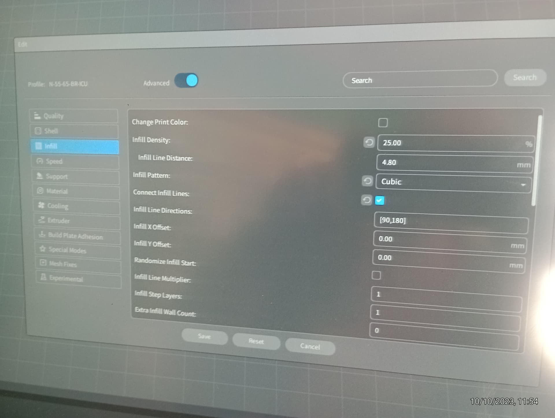

With Creality Print Version 4 you have the + and can define many profiles for each material that you use.
Thanks! That did it. Now if I could only add supports!
