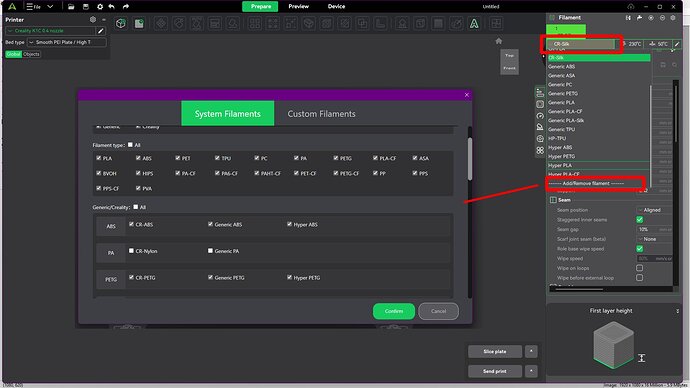

Hi, I’m using Creality Print V6. I can only find 4 filament profiles being available through the interface.
When I try to find them through the properties dialog I don’t see any filaments:
From looking into Windows Explorer in terms of the installation folder of the software I actually see those various filament profiles. I tried to import one of them and the software replied with “success”, but still I could not see it anywhere in the software being available.
Anyone having a hint on that issue?

Select your required filaments to add to the filament list
Bill
Thx for the tip, but that’s actually what I tried which led/leads me to that empty list I posted initially …
However, what’s kinda strange here as well - I don’t see those tabs you have (“System Filaments/Custom Filaments”). Sometimes when the app builds up the dialog I see them shortly flickering and being gone again immediately.
Anyone have a resolution? I have the same problem, but I do see the System & Custom filament tabs, but NO filaments in the list when I set the filter checkboxes.
