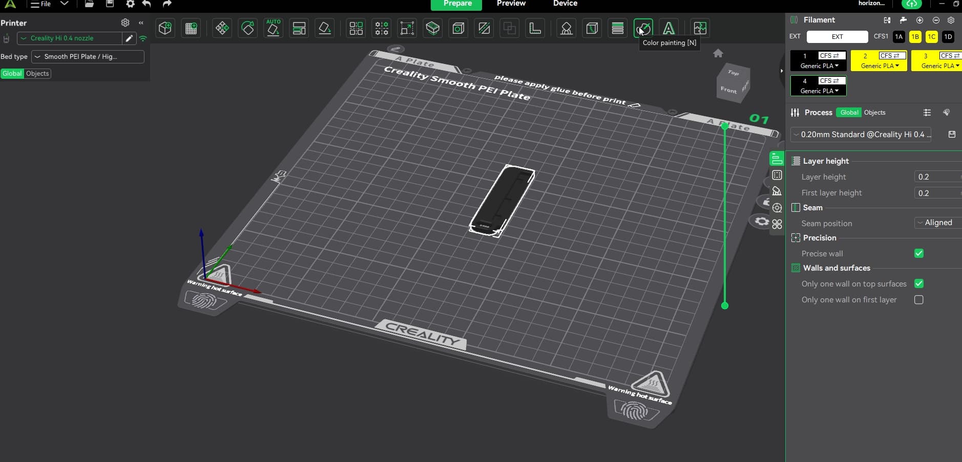

I’m trying to do my first multicolor printing with CFS already installed, but after slicing, the options to change filament (or even add pause) are not enabled. What am I missing?

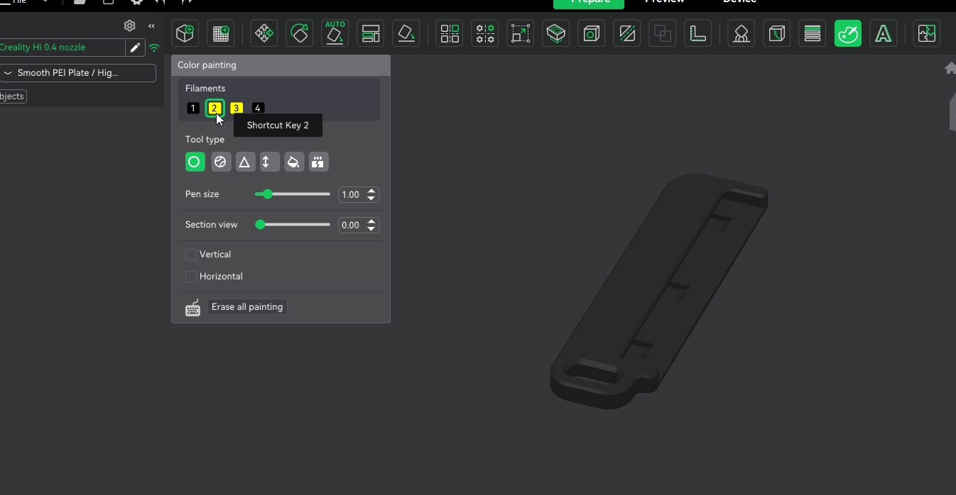

  1. Once I have my colors and material matching my CFS load I select the object on the bed.
  2. I select the color painting (N) button
  3. A panting menu will pop up and then you select the color from the respective CFS slot and I use the fill to quickly paint the surface.
  4. I slice the object and send it for print and it automatically does the material selection base on the color/CFS slot selected.
